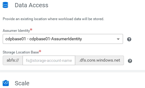

I'm having trouble during the provisioning of an environment via cloudera manager cloud console.
I followed the quick start, https://docs.cloudera.com/management-console/cloud/azure-quickstart/topics/mc-azure-quickstart.html and the guide on the repository https://github.com/cpv0310/cdp-azure-tools, but the problem remains the same:hdfs can't write to storage abfs: // data @ xxx
I tried to create the managed identity both through the template and through the script provided, but I have not had any changes.
The only different thing is that in the guide, step 6, it says to assign both assumer identity and data identity, but in the form I only have the possibility to assign the assumer identity. Same thing when I go to assign the identity logger: I only have one slot and I can't assign the identity ranger.
In the logs I see that the creation of the data lake stops trying to create the first folder on HDFS (abfs) and the error is on the "slave" node which through knox has a 403 forbidden. As soon as possible I attach the logs.

Ok, I solved it using the cdp cli.
The problem was that from web ui of Cloudera Management Console it is not possible to insert the identity for ranger, while from cli it is possible.
