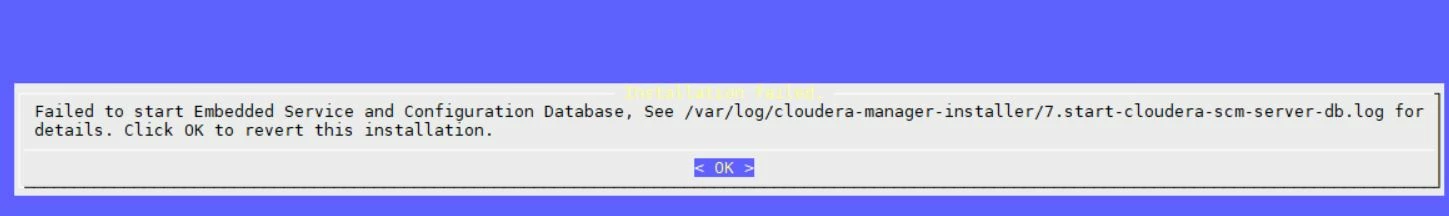

How can that be changed to postgres. I tried so many things and now out of options.
I am doing a POC and at first started the regular installation bu installing agent,server.daemons and bringing up CM server without a DB and then unstalled all retried using the cloudera-manager-installer.bin . After a day of searching i cannot get the installtion to complete.
The embedded database does not install with the below error
$$$$sudo cat /var/log/cloudera-manager-installer/7.start-cloudera-scm-server-db.log
Job for cloudera-scm-server-db.service failed because the control process exited with error code. See "systemctl status cloudera-scm-server-db.service" and "journalctl -xe" for details.
$$$$ systemctl status cloudera-scm-server-db.service
● cloudera-scm-server-db.service - LSB: Cloudera SCM Server's Embedded DB
Loaded: loaded (/etc/rc.d/init.d/cloudera-scm-server-db; bad; vendor preset: disabled)
Active: failed (Result: exit-code) since Thu 2019-07-04 21:09:39 EDT; 6min ago
Docs: man:systemd-sysv-generator(8)
Warning: cloudera-scm-server-db.service changed on disk. Run 'systemctl daemon-reload' to reload units.
## Tried systemctl daemon-reload many times still no luck and then reran installer
