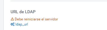

the next image shows the restart notification to apply changes, but it has already been applied several times.

Hi guys , problem reporting
In Cloudera Manager , Now Ldap is funtional but the message " Restart service " persist .
Regards!

Hi @noekmc , Are you referring to the below "Restart service" highlighted option that you see under ldap_url? If yes, it is expected and you can refer my earlier comment. noekmc_0-1660072480098.png
