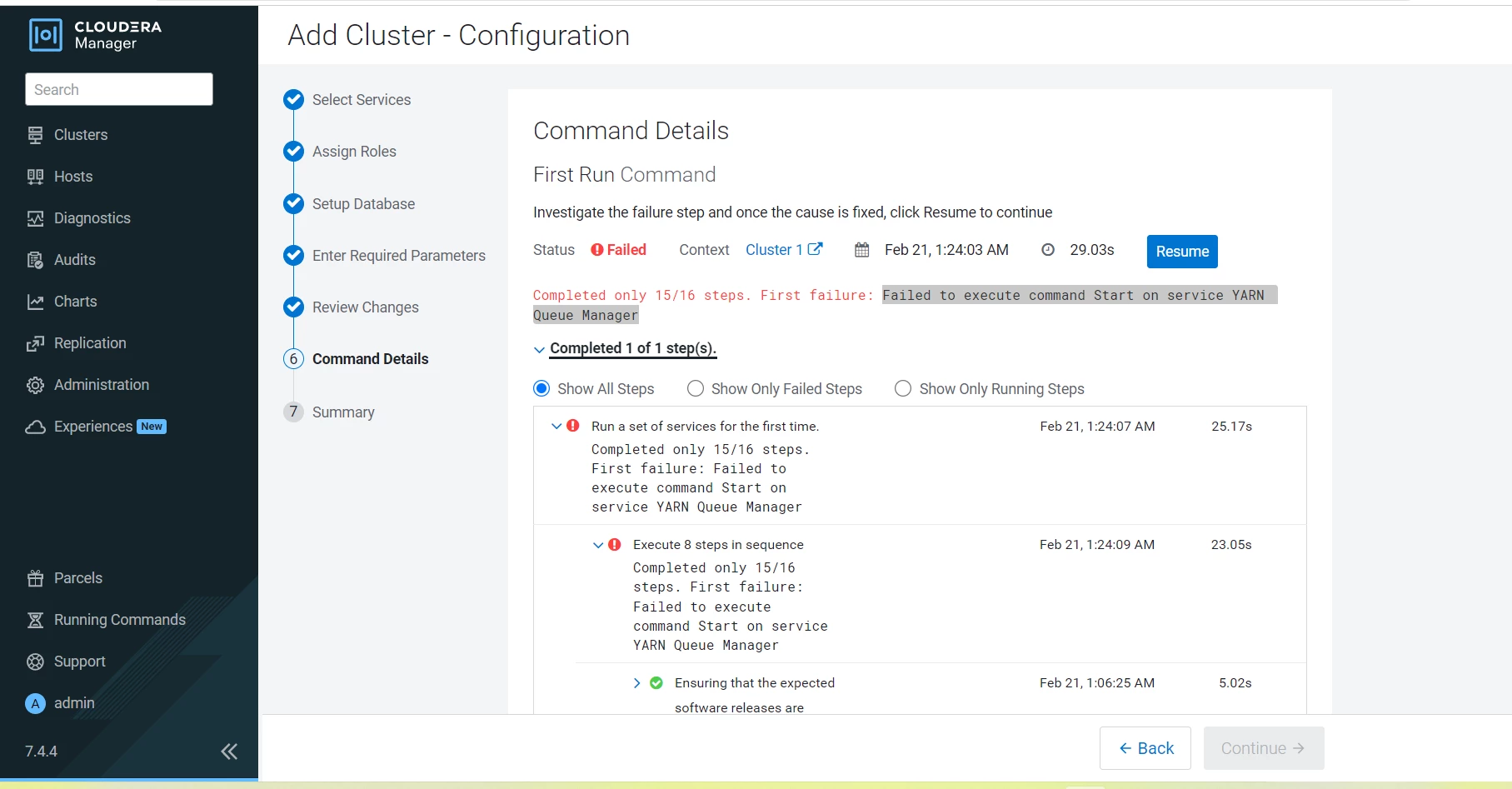

Question
cluster configuration Failed to execute command Start on service YARN Queue Manager
Please could someone help what can be done here , i'm getting attached error while try to set up the clusterScreenshot 2023-02-20 211103.png

Can you please help with full stack trace for queue manager?

Tue Feb 21 00:59:52 IST 2023
JAVA_HOME=/usr/java/jdk1.8.0_232-cloudera
Using -XX:+HeapDumpOnOutOfMemoryError -XX:HeapDumpPath=/tmp/queuemanager_queuemanager-QUEUEMANAGER_STORE-d9ddbb5b382b3332696df1de7aa6742a_pid14918.hprof -XX:OnOutOfMemoryError=/opt/cloudera/cm-agent/service/common/killparent.sh as CSD_JAVA_OPTS
Using /var/run/cloudera-scm-agent/process/98-queuemanager-QUEUEMANAGER_STORE as conf dir
Using scripts/control.sh as process script
CONF_DIR=/var/run/cloudera-scm-agent/process/98-queuemanager-QUEUEMANAGER_STORE
CMF_CONF_DIR=
Starting the YARN Queue Manager config server on port []
00:59:56.774 [main] INFO org.eclipse.jetty.util.log - Logging initialized @3438ms to org.eclipse.jetty.util.log.Slf4jLog
00:59:56.917 [main] INFO i.d.server.DefaultServerFactory - Registering jersey handler with root path prefix: /
00:59:56.920 [main] INFO i.d.server.DefaultServerFactory - Registering admin handler with root path prefix: /
00:59:56.922 [main] INFO c.c.c.utils.WebappProperties - Reading '/var/run/cloudera-scm-agent/process/98-queuemanager-QUEUEMANAGER_STORE/conf//webapp.properties' ....
00:59:56.931 [main] INFO c.c.c.utils.WebappProperties - Read 'webapp.properties' contents : {config_service_db_loc=jdbc:h2:~/config-service, kerberos.auth.enabled=false, queuemanager_store_keystore_file=, queuemanager_store_password=, queuemanager_store_ssl_enabled=false, yarn_queuemanager_store_log_dir=/var/log/yarn/queuemanager}
00:59:56.934 [main] INFO c.c.c.ConfigServiceApplication - Check for admin password update.
00:59:56.934 [main] INFO c.c.c.utils.QueryUserTable - Update system admin password for h2 database.
org.h2.message.DbException: Log file error: "/var/lib/hadoop-yarn/config-service.trace.db", cause: "org.h2.message.DbException: Error while creating file ""/var/lib/hadoop-yarn"" [90062-198]" [90034-198]

at io.dropwizard.Application.run(Application.java:94)
at com.cloudera.configservice.ConfigServiceApplication.main(ConfigServiceApplication.java:72)
01:00:40.901 [main] ERROR c.c.c.ConfigServiceApplication - Unable to update admin password. Please try updating password manually on your H2 instance.

pc1985
Silver ⭐️
Mar 8, 2023 2:28 PM UTC
to resolve problem you need to create folder
sudo mkdir /var/lib/hadoop-yarn/
sudo chmod +077 /var/lib/hadoop-yarn/
sudo chown yarn:hadoop /var/lib/hadoop-yarn/
