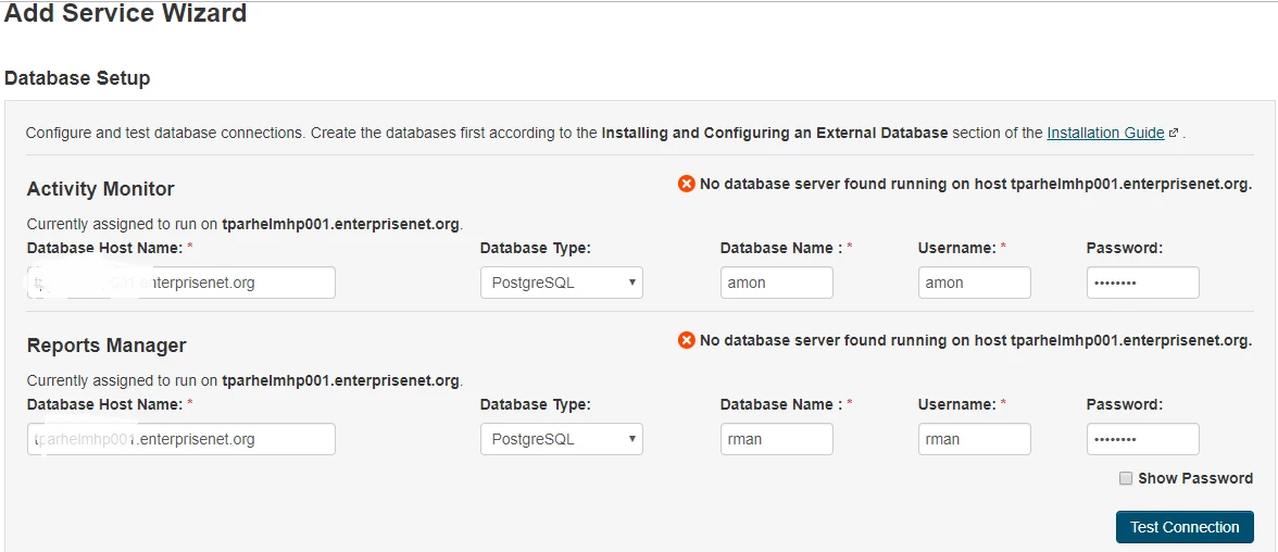

Actually after deleting the CMS i am not finding the logs to attach, And as you suggested i have already created and trying to test the connections using those credentials.
But i am getting error and you can see it in screen shot.
Can i install my sql and create a DB and user and can i update them here ?
Was it work for me ?
Please suggest me with your valuable comments.

The "No database server found running" indicates that your postgres server is either not running on the host you specified or is running on another host.  If you don't know where your database server is or it is missing, make sure you know if you installed and configured your own database or if you are using the "embedded" database from Cloudera that is intended for Proof of Concept installs.
If you need to set up your databases again, you can use this:
https://www.cloudera.com/documentation/enterprise/latest/topics/cm_ig_extrnl_pstgrs.html
After preparing the database, you can retry the install.
NOTE:  If you are *not* using MapReduce1 then you do not need Activity Monitor as it does not capture MR2/YARN.  If you are only using YARN for your Map Reduce, then this is a good time to get rid of Activity Monitor.
