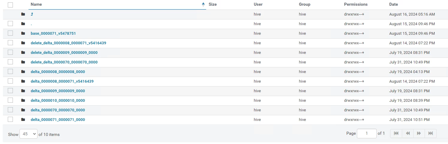

Hi all,
in my test cluster I am noticing a slowdown in the execution of acid queries.
Analyzing in detail I noticed that the compactions remain stuck at "ready for cleaning" and there are many delta files.
I also tried to manually launch the compaction without any result. hive.metastore.housekeeping.threads.on and hive.metastore.housekeeping.threads.on is true only in 1 hive metastore host.

In the development cluster with the identical configuration I do not have this problem. Do you have any suggestions?
I'm running in CDP 7.1.9
Thanks, Lorenzo

2024-08-27 14:26:53,877 WARN org.apache.hadoop.hive.ql.txn.compactor.Cleaner: [Cleaner-executor-thread-0]: id=5365402 Remained 21 obsolete directories from hdfs://XXXX. [base_0000201_v1772045,base_0000014_v1403023,delta_0000002_0000002_0000,delete_delta_0000003_0000003_0000,delta_0000003_0000003_0000,delta_0000004_0000004_0000,delete_delta_0000007_0000007_0000,delta_0000007_0000007_0000,delta_0000008_0000008_0000,delete_delta_0000011_0000011_0000,delta_0000011_0000011_0000,delta_0000012_0000012_0000,delete_delta_0000013_0000013_0000,delta_0000013_0000013_0000,delta_0000014_0000014_0000,delete_delta_0000200_0000200_0000,delta_0000200_0000200_0000,delta_0000201_0000201_0000,delete_delta_0000498_0000498_0000,delta_0000498_0000498_0000,delta_0000499_0000499_0000]
2024-08-27 14:26:53,877 WARN org.apache.hadoop.hive.ql.txn.compactor.Cleaner: [Cleaner-executor-thread-0]: No files were removed. Leaving queue entry id:5365402,dbname:XXXX,tableName:XXXX,partName:schema_sorgente=XXXX,state:,type:MAJOR,enqueueTime:0,start:0,properties:null,runAs:hive,tooManyAborts:false,hasOldAbort:false,highestWriteId:826,errorMessage:null,workerId: null,initiatorId: null in ready for cleaning state.

Based on the INFO logs, it appears that there is an open transaction blocking the compaction cleaner process. This requires a separate investigation, so I advise raising a support case to resolve the problem. Additionally, we need to examine the HMS logs, backend DB dump, and the output of "hdfs dfs -ls -R" command.

@Lorenzo The issue seems to be related to HIVE-27191 where some mhl_txnids do not exist in TXNS,completed_txn_components txn_components table but they are still present in min_history_level table, as a result, the cleaner gets blocked and many entries are stuck in the ready-for-cleaning state. To confirm that collect the output of below query
SELECT MHL_TXNID FROM HIVE.MIN_HISTORY_LEVEL WHERE MHL_MIN_OPEN_TXNID = (SELECT MIN(MHL_MIN_OPEN_TXNID) FROM HIVE.MIN_HISTORY_LEVEL);
Once we get the output of the above query check if those txn ids are there in TXNS,completed_txn_components txn_components tables using below commands.
select * from txn_components where tc_txnid IN (MHL_TXNID );
select * from completed_txn_components where ctc_txnid IN (MHL_TXNID);
select * from TXNS where ctc_txnid IN (MHL_TXNID);
If we got 0 results from the above queries this confirms that the MHL_TXNIDs we got above are orphans and we need to remove them in order to unblock the cleaner.
delete from MIN_HISTORY_LEVEL where MHL_TXNID=13422; --(repeat for all)
Hope this helps you in resolving the issue
