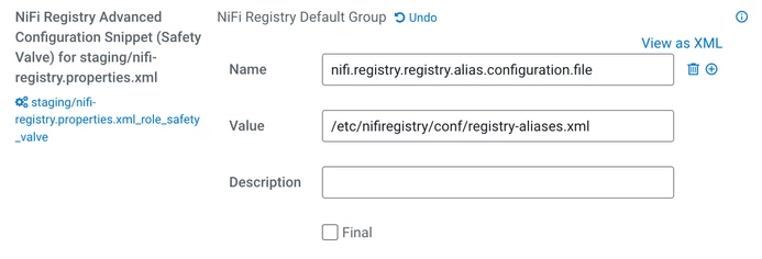

Cloudera Manager does not manage the registry-aliases.xml file for you but you can create this file manually in a common location (e.g. /etc/nifiregistry/conf/registry-aliases.xml) and configure NiFi Registry to point to that file using the following safety valve configuration in Cloudera Manager:
After that, you just need to restart the NiFi Registry service and... voilà!

Thank you so much!  I was looking around for the way to add arbitrary properties to the nifi-registry.properties and never hit on the right wording to find that one.  Yep, figured I could always add the file manually if I could just do what you showed how to.
