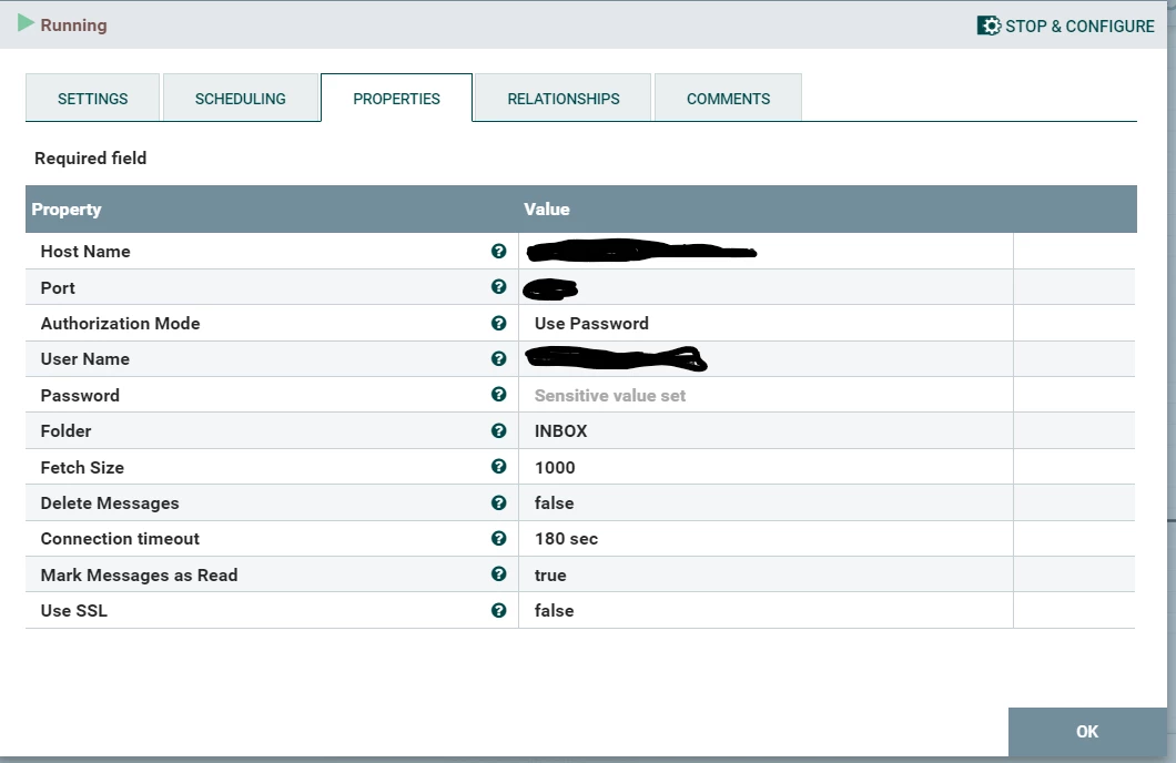

What could be the issue? below is the configuration for the same

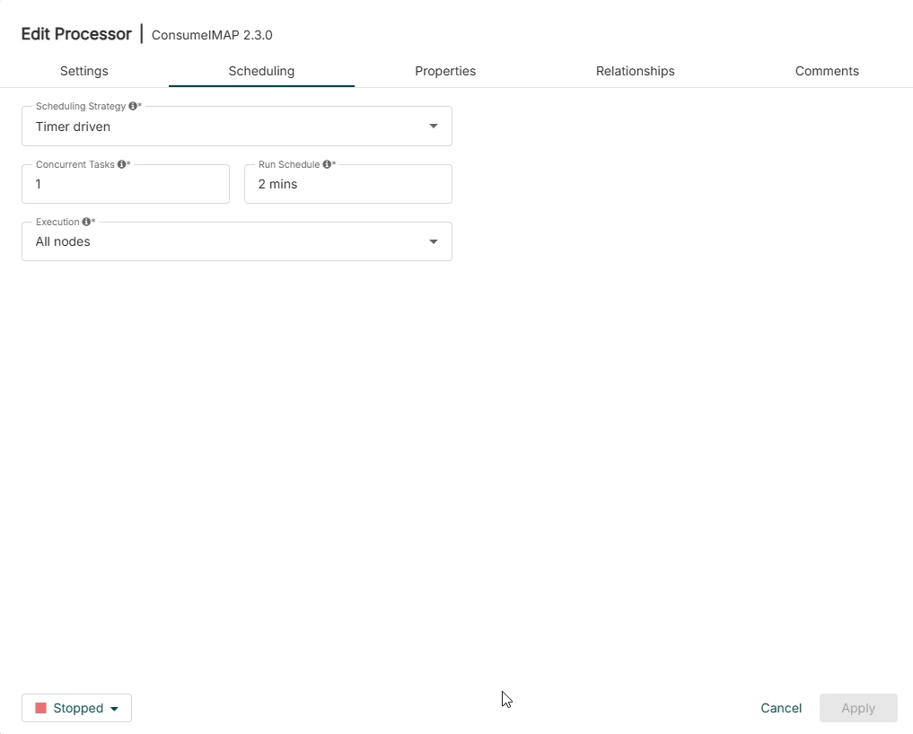

The processor has no configuration for run duration:

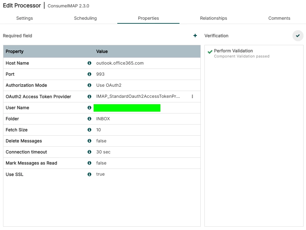

My processor configuration:
