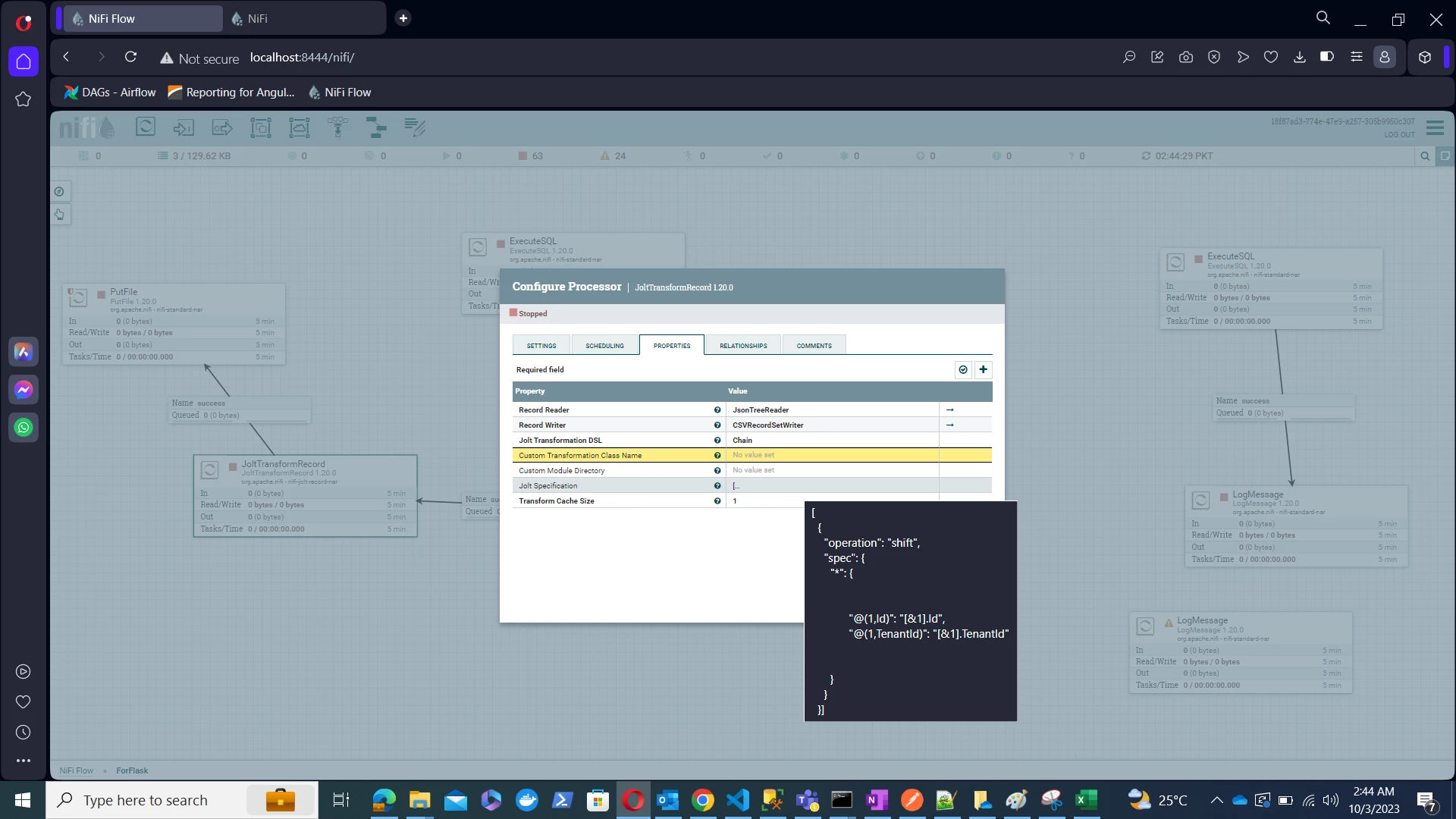

@araujo
 I am trying to implement your suggested way.
My json is :
"Id" : "some int",
"TenantId" : "some double value"
and I am using chain jolt transform method as:
"operation": "shift",
"spec": {
"@(1,Id)": "[&1].Id",
"@(1,TenantId)": "[&1].TenantId"

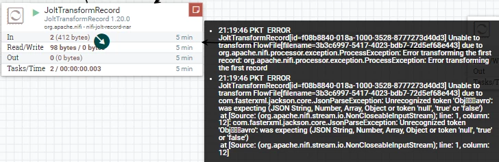

However, I am getting a error as:
Can you tell where I am going wrong?
Thanks.

@Kiranq,
from the error message I can see that your input seems to be in avro format. Are you sure the flowfile has valid json format? If not you can use ConvertAvroToJson processor before using the jolt transformation to convert avro to json. Also from the json you provided not sure your jolt spec will work. If you provide your json input and the expected output more accurately maybe I can help you with defining the correct jolt spec.

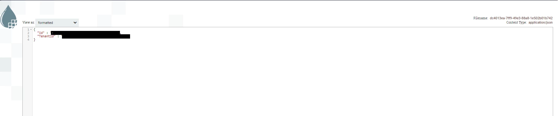

@SAMSAL
thank you for responding.
I am infact using/converting the output from ExecuteSql from Arvo to Json using ConvertAvroToJson processor.
Below is the output of the same processor:
I am also wondering if I am providing the json format, its throwing error for avro.
Can you suggest something?
Translate

@Kiranq,
I have to look into the JoltTranformationRecord to see what configuration you have there vs what is expected. However since you are having a json input can you use the JoltTransformationJson processor instead or are you trying to convert the output json into different format?
Translate
Kiranq
Silver ⭐️⭐️⭐️
Oct 2, 2023 5:12 PM UTC
Thats right. I intend to convert the json using JoltTransfomationRecord into csv format and then save the file in my local machine.

Can you take screenshot of the JoltTranformRecord and the reader\write services settings?
Translate

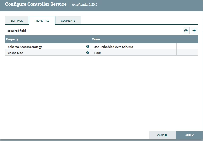

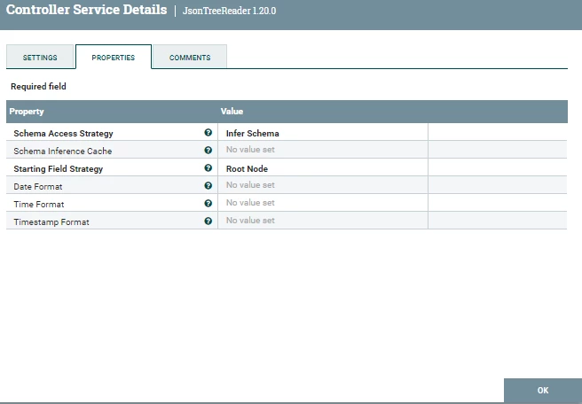

Silver ⭐️⭐️⭐️
Oct 2, 2023 9:46 PM UTC
Here
JoltTransforRecord:
JsonTreeReader:
AvroReader:
Thanks.
Translate
