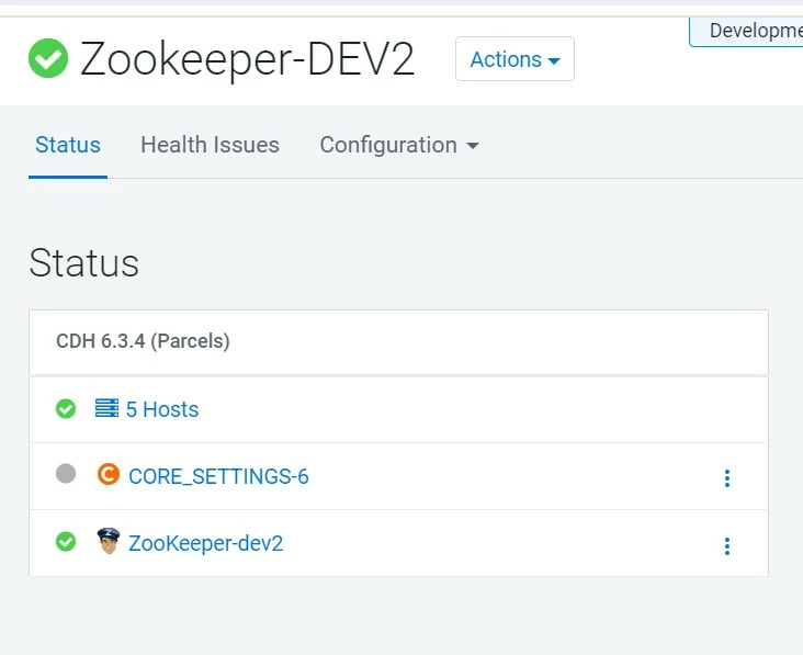

bkandalkar88
Silver ⭐️⭐️
Feb 9, 2024 5:57 AM UTC
Thanks for your reply , PabitraDas
Let me add some more clarity  here ... We have a CM that manages multiple CDH & CDP cluster .  one of the cluster out of those is a standalone 5 node zookeeper cluster , that is not used by  any services of any of the clusters managed by this CM . This standalone 5 node  zookeeper cluster was created long time back using cloudera manager by an admin who is no longer working with us and I am assuming he may have created this 5 node zookeeper ensemble using CM just because it was easy to do that using CM instead of a CLI / manually
We now want to decommission this 5 node zookeeper cluster completely and remove it from cloudera manager however we do not want to loose the zookeeper data . so the idea is to one by one decommission these 5 nodes and remove them from cloudera manager however we want zookeeper service to be re-installed using CLI on this  nodes since the ensemble will still be used by an external app . so the question here is , after we decomm 1 zookeeper node (starting with a current follower  first )  from the zookeeper ensemble of 5  node , is it going to be an issue that we will have temporarily 4 nodes still managed by cloudera manager and one not managed (since the ID of zookeeper in myid file will be same as before and we are hoping that after the unmanaged zk node comes backup , it will sync the data from the leader zk instance )  . We plan to keep this setup  ( 4 managed and 1 unmanaged zk node of same ZK ensemble  )  running for couple of days and if no issues are reported then proceed with decommissioning of the remaining 4 nodes one after the another .
Once again thanks for taking out time to respond to my question , I genuinely appreciate it

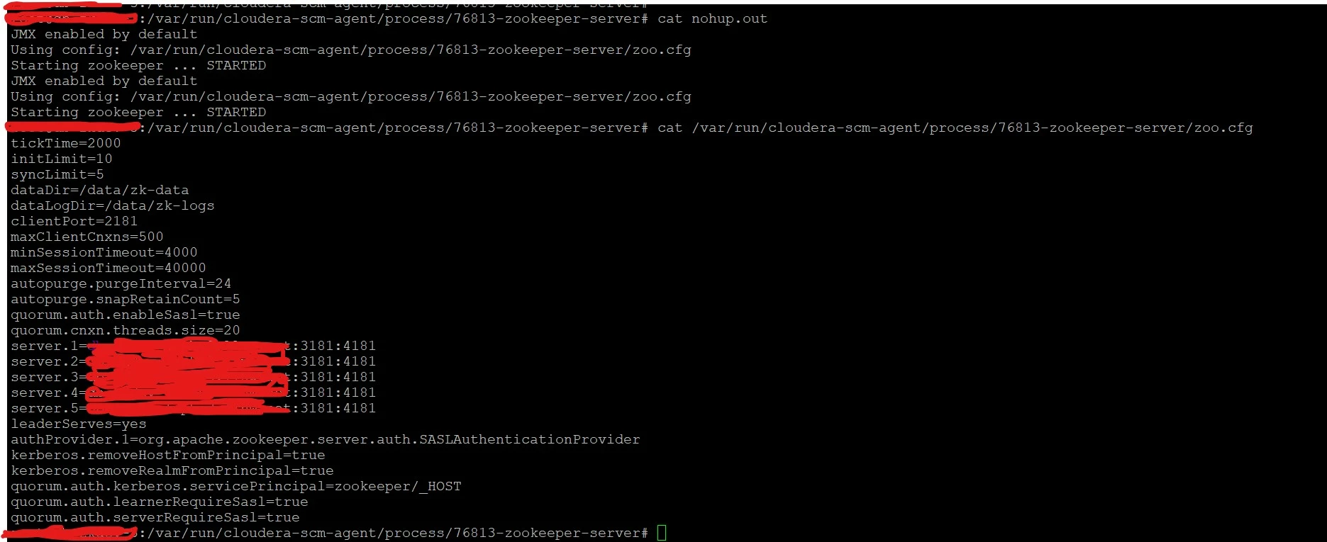

bkandalkar88
Silver ⭐️⭐️
Feb 12, 2024 2:30 PM UTC
@PabitraDas :- Here's the steps that I followed today to convert one of zk node into an unmanaged node ...I am running into an issue described below ..
1) Stopped the zk server from cloudera manager and put the host under maintenance
2) updated the hosts file on all  the 5 zk server  nodes mapping the IP address and host fqdn
3) Backed up data and config files
4) from CM , decommissioned one of the host
5) stopped the cm agent on the node that was decommissioned
6) removed the host from CM
7) zoo.cfg file got updated with default values in this process , so restored the file from backup that had the zk quorum as follows ...
server.1=zk1-fqdn:3181:4181
server.2=zk2-fqdn:3181:4181
server.3=zk3-fqdn:3181:4181
server.4=zk4-fqdn:3181:4181
server.5=zk5-fqdn:3181:4181
😎verified that myid file on all the host had unique id's so that there is no conflict and they can participate in the ensemble and the zk data was intact
9) started the ZK on the decommissioned node from command line and as seen in the attached screen shot , the startup event shows that it is reading the configuration from the zoo.cfg that has the quorum address
Though the zookeeper server gets started from command line however when I run the following command to get the "Mode" of this zk server , instead of  showing up as a  "follower" . it says "standalone" .
echo "stat" | nc zk3-fqdn 2181 | grep Mode
Mode: standalone
Please refer to the attached screen shot below that shows the nohup.out that shows zookeeper was successfully started and the corresponding zoo.cfg has the quorum details (similar to the one available on the other members of the quorum ) .
It looks like , though the startup command reads the configuration from zoo.cfg file however it still fails to become the member of the ensemble and I am not sure why ?

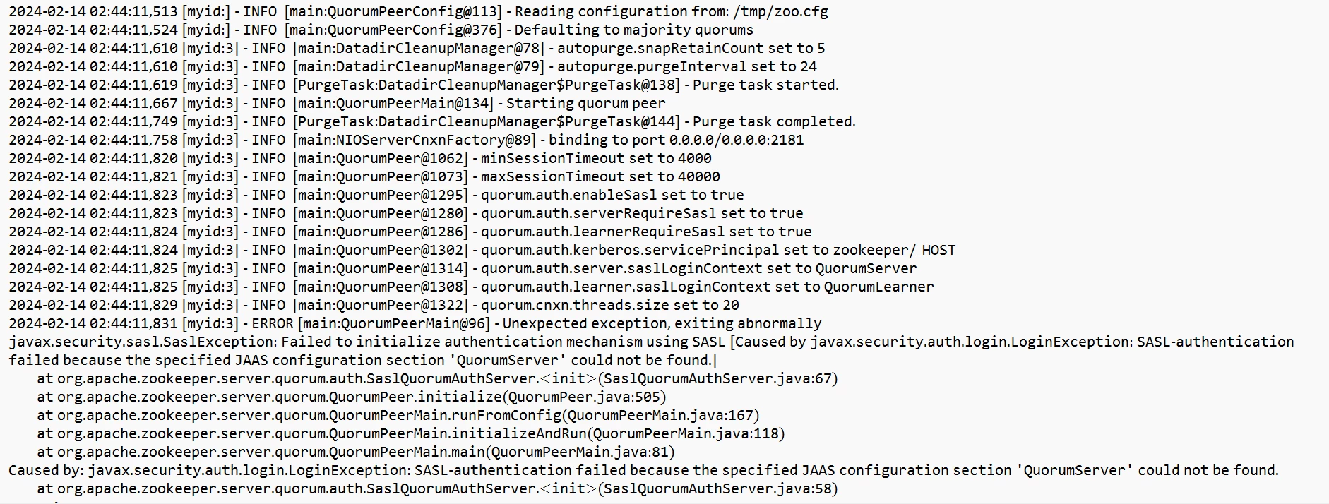

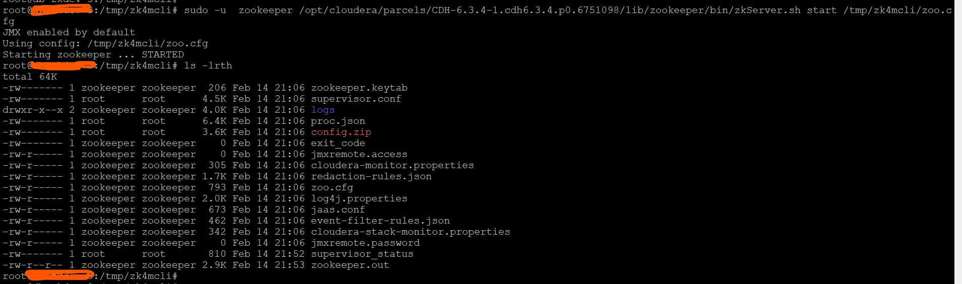

bkandalkar88
Silver ⭐️⭐️
Feb 15, 2024 5:32 AM UTC
@PabitraDas  Any thoughts ?
Btw, when I just stop the ZK server from cloudera manager and attempt to start it from command line like this ...though I see the message from script as "STARTED" but the "start" attempt  actually fails and I see nothing when I do a "ps -ef |grep -i zookeeper" . I see a "zookeeper.out" file was created on my current location and it shows the SASL error as seen below the attached screen shot
It looks like the attempt to start zookeeper server is failing because of an SASL authentication failure as seen in the error snippet above .. This is how my jaas.conf looks like
root@fqdn:/tmp/zk4mcli# cat jaas.conf
Server {
com.sun.security.auth.module.Krb5LoginModule required
useKeyTab=true
keyTab="zookeeper.keytab"
storeKey=true
useTicketCache=false
principal="zookeeper/FQDN@REALM";
QuorumServer {
useKeyTab=true
storeKey=true
QuorumLearner {
useKeyTab=true
storeKey=true

PabitraDas
Gold ⭐️
Gold ⭐️
Feb 20, 2024 11:46 AM UTC
Hello @bkandalkar88
Thank you for sharing the details.
As I mentioned in my first note, these steps needs to be tested. However, reading your update, it seems the decom ZK server is not able to communicate with other ZK Servers in ensemble. The required authentication process seems broken.
So, I would suggest to add back the host (recommission the node) to CM and then to cluster and add the ZK Server role on it. Let's get back to previous operational condition.
Then, file a support case with Cloudera Support to assist on the requirement if you have valid support entitlement with extended support for CDH (since CDH is EOL). Support may reproduce the issue in house and share the steps to you.
