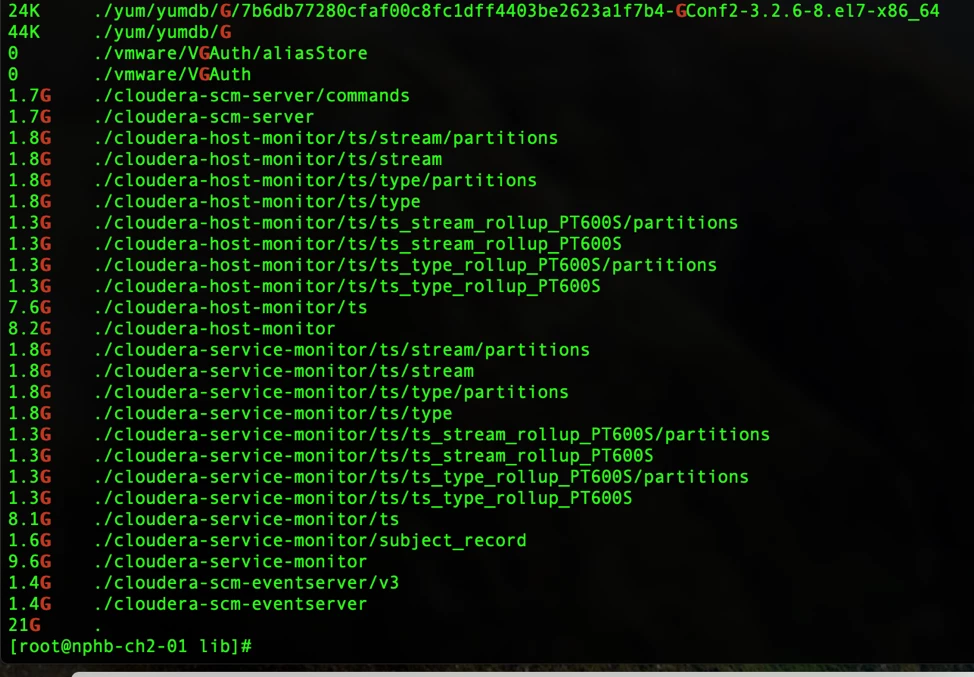

I am talking about /var/lib/cloudera-service-monitor and /var/lib/clouder-host-monitor, both of these occupied almost 20GB, I want to delete the files in both of them. But not sure what will happen. Its a production cluster, so dont want impact on it by my actions.
cloudera-service-monitor has impala, reports, subject_record, ts and yarn folders. I want to delete the files in subject_record and ts floders, because they occupied 9GB. Is that ok to delete them?
The ts folder has below files:
stream              ts_stream_rollup_PT21600S  ts_stream_rollup_PT600S     ts_stream_rollup_PT86400S  ts_type_rollup_PT3600S  ts_type_rollup_PT604800S  type
ts_entity_metadata  ts_stream_rollup_PT3600S   ts_stream_rollup_PT604800S  ts_type_rollup_PT21600S    ts_type_rollup_PT600S   ts_type_rollup_PT86400S
The subject_record folder has below files:
subject_ts  ts_subject
The cloudera-host-monitor has below floders:
subject_record  ts
Like in cloudera-service-monitor, almost same files are present in both the subject_record and ts floders.
Is that ok to manually delete them? if chart data is gone it is fine but we need space. Picture1.png
