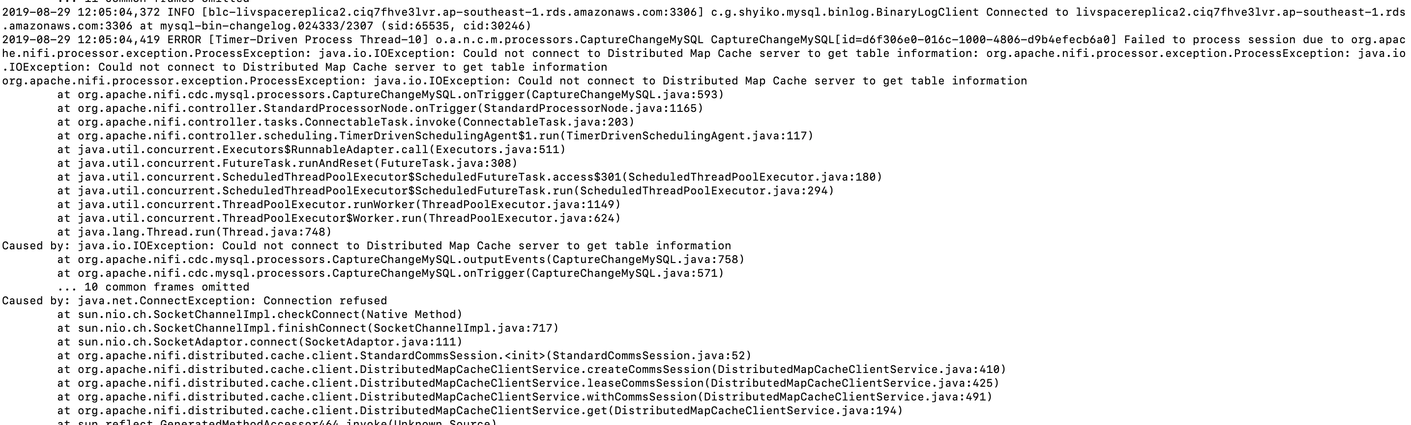

I am trying to read the mysql bin log data from mysql database and i am getting the error as
"Could not connect to Distributed Map Cache server to get table information"

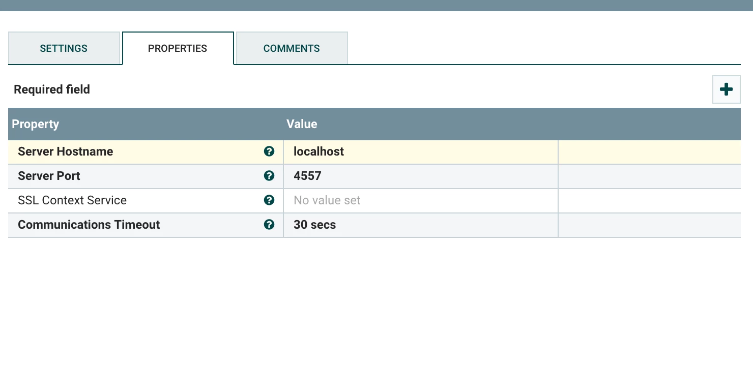

when i added the Distributed Map Cache Client value in CaptureChangeMysql Aapache nifi processor .
screenshots are attached for the reference

I think the solution you are looking for is to add a DistributedMapCacheServer.  The screenshot above is just the client.  The client needs a server running/enabled in order to be operational.
Another suggestion is to make sure that there is connectivity to the map cache port, between nifi,mysql, and the map cache port.

Did you add and start a "DistributedMapCacheServer" controller service running on port 4557?
The "DistributedMapCacheClientService" controller service only creates a client that is used to connect to a server you must also create.
Keep in mind that the DistributedMapCacheServer does not offer High Availability (HA). Enabling this controller services will start a DistributedMapCacheServer on each node in your NiFi cluster, but each of those servers do not talk to each other.  This is important to understand since you have configured your DMC Client to use localhost.  This means that each node in your cluster would be using its own DMC server rather than a single DMC server.
For a HA solution you should be using an external map cache via one of the other client offerings like "HBase_2_ClientMapCacheService " or "RedisDistributedMapCacheClientService", but this would require you to setup that external HBAs or Redis server with HA yourself.
