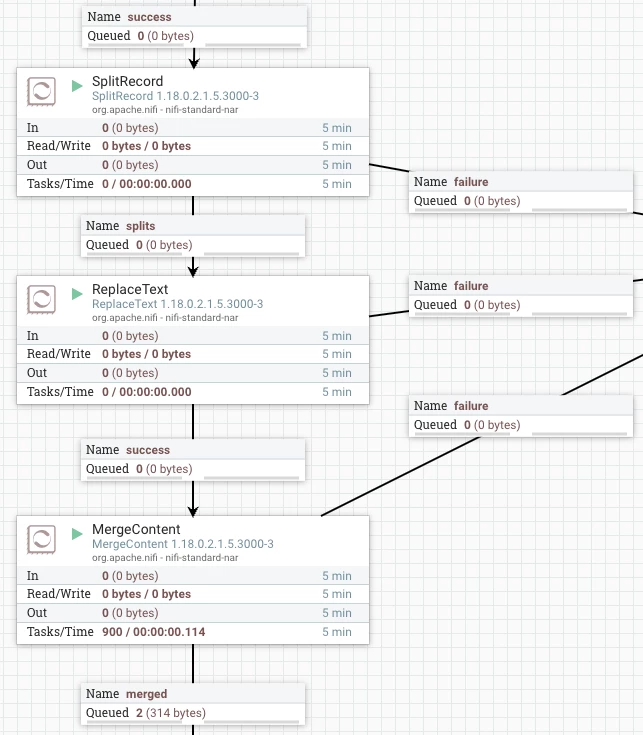

NiFi Components used:
SplitRecord Used to split your multi-row CSV record in to individual records.

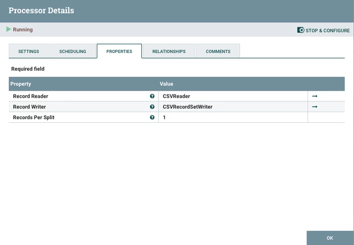

MattWho_0-1721417909234.pngThis processor will use a CSVReader:
and CSVRecordSetWriter:

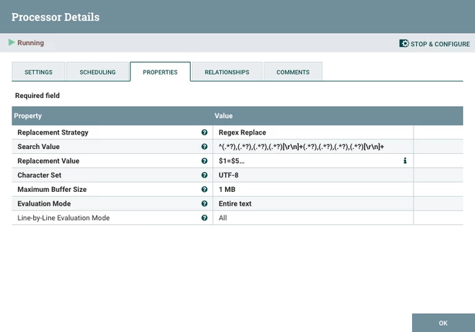

The "Splits" relationship then gets routed to a ReplaceText processor (used to reformat the individual line record):
"Search Value" based on four items per line (header and body):
^(.*?),(.*?),(.*?),(.*?)[\r\n]+(.*?),(.*?),(.*?),(.*?)[\r\n]+

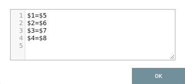

"Replacement Value":
The "Success" relationship is then routed to a MergeContent processor (used to recombine the original multi-records into a single FlowFile):
Note: Demarcator is configured with line return to provide a new line between records in content.
The assemble portion of this dataflow looks like this:
Above is a working solution based on your shared example.  It works no matter how many CSV rows exist in the source file.

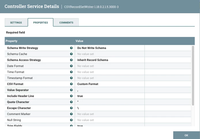

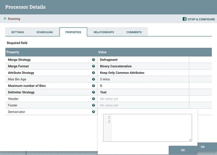

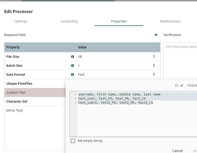

Hi,
Another option is to use FreeFormTextRecrodSetWriter for that. The documentation is lacking about this unfortunately but you can find some examples like this if you google it.

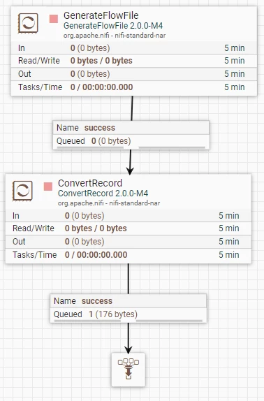

All you need is a ConvertRecord processor to get the desired result. here is an example :
- GenerateFlowFile is to simulate generating the csv input:

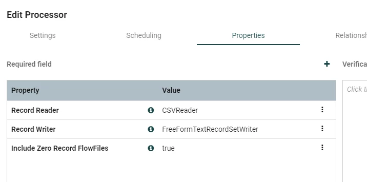

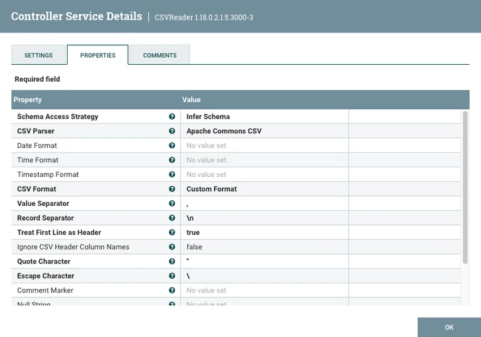

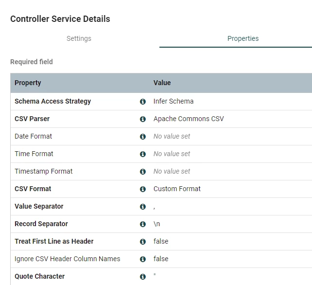

- ConvertRecord: which takes the CSV input using CSVReader and Record Writer using the FreeFormTextRecordSetWriter:

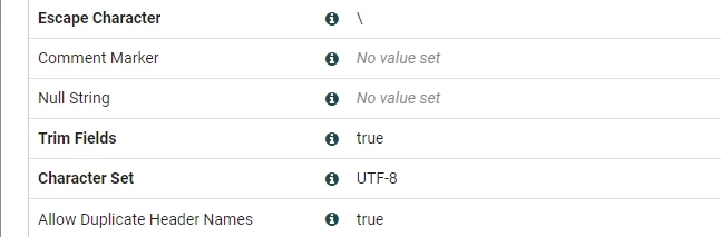

- CSVReader Service Configuration: You can use default configuration.

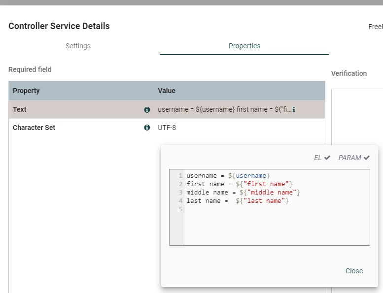

-FreeFormTextRecordSetWriter:
The Text used in the above Service to provide desired output:
username = ${username}
first name = ${"first name"}
middle name = ${"middle name"}
last name = ${"last name"}
