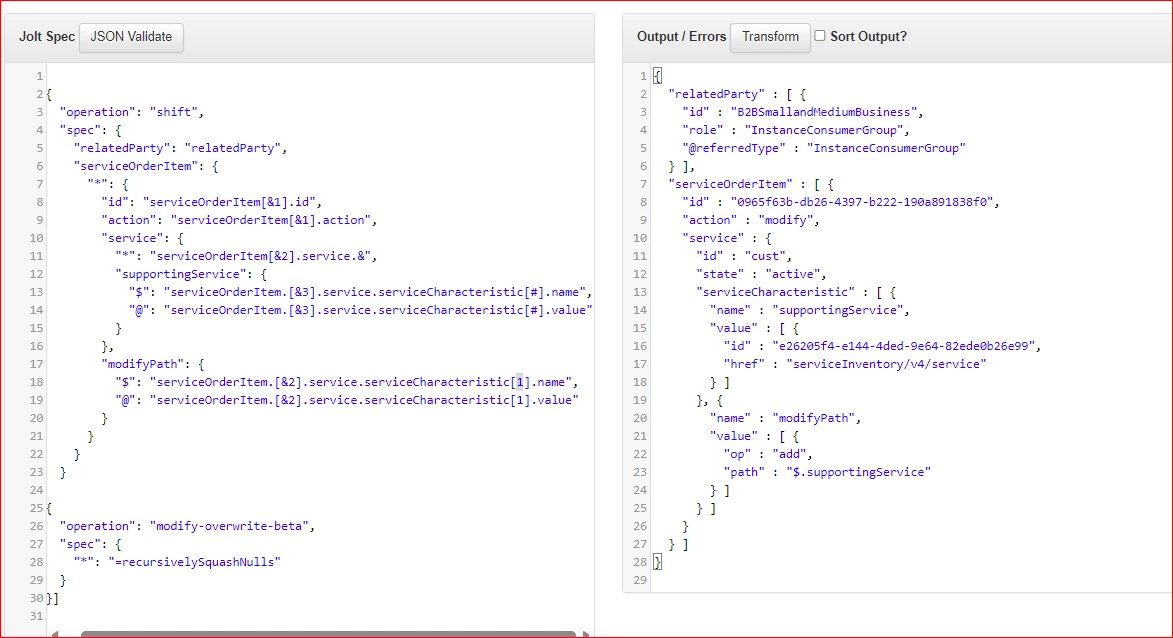

SAMSAL
Platinum ⭐️⭐️⭐️
Nov 30, 2023 3:32 PM UTC
Hi @scoutjohn ,
Your spec can be written as follows:
"operation": "shift",
"spec": {
"serviceOrderItem": {
"*": "serviceOrderItem.[&1].&",
"service": {
"*": "serviceOrderItem.[&2].service.&",
"supportingService": {
"$": "serviceOrderItem.[&3].service.serviceCharacteristic[#].name",
"@": "serviceOrderItem.[&3].service.serviceCharacteristic[#].value"
I did not not add the  "modifyPath" because I did not see anything related to this object in the provided json input.
Notice how I used # for serviceCharacteristic[#].name & serviceCharacteristic[#].value which tells the spec to group everything under one object under the serviceCharacteristic array.
If you find this helpful please accept solution.
Thanks
Translate
scoutjohn
scoutjohnAuthor
Gold ⭐️
Dec 5, 2023 5:35 AM UTC
@SAMSAL , Sorry for the delay,
Thank you for your solution.

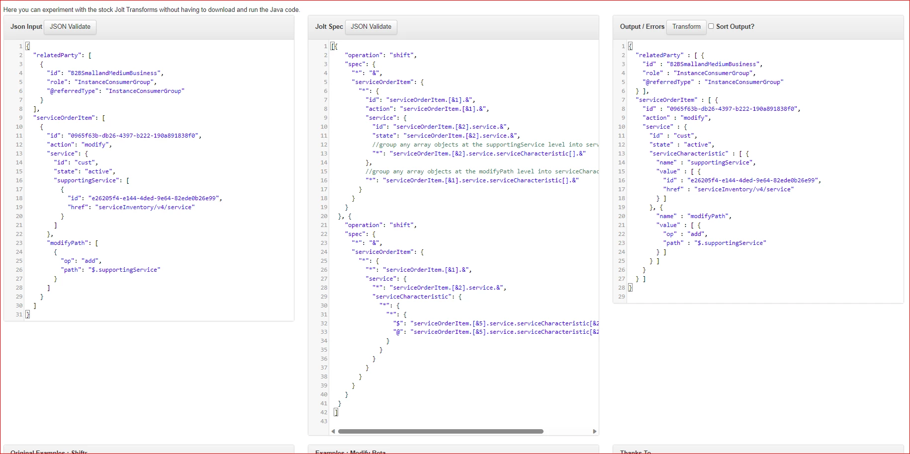

"relatedParty": [
"id": "B2BSmallandMediumBusiness",
"role": "InstanceConsumerGroup",
"@referredType": "InstanceConsumerGroup"
"serviceOrderItem": [
"id": "0965f63b-db26-4397-b222-190a891838f0",
"action": "modify",
"service": {
"id": "cust",
"state": "active",
"supportingService": [
"id": "e26205f4-e144-4ded-9e64-82ede0b26e99",
"href": "serviceInventory/v4/service"
"modifyPath": [
"op": "add",
"path": "$.supportingService"
for the incoming request modifyPath will come outside the service object , supportingService array will come inside service object. the output should have serviceCharacteristic array inside service object with name and value ( value being the whole array moved from modifyPath in this in case),
"serviceCharacteristic" : [ {
"name" : "modifyPath",
"value" : "[]"
{ "name" : "supportingService",
"value" : "[]"
like the attached screenshot
The input could change , can also have other arrays that need to be moved into the serviceCharacteristic array, was trying to understand if it is possible to avoid the indexing on serviceCharacteristic in jolt transformation.
Translate
SAMSAL
SAMSALAnswer
Platinum ⭐️⭐️⭐️
Dec 5, 2023 11:49 AM UTC
@scoutjohn,
I can see the full problem now. I wish I have considered it in my first response because it will change things a little bit.
Since you have mentioned that you could have other arrays in each level, the current spec basically wont work unless you create different specs for different scenarios which is not a good idea.
This can be resolved in two shift transformations:
1- Bring those array objects from different levels  into "serviceCharacteristic" array.
2- Apply the name, value assignment based on each object array index in "serviceCharacteristic" array.
In this case no need to figure out how many arrays objects you might have in the each level, nor you have to assign hard coded index.
Here is the final spec:
// First transformation, group array objects under service
// and serviceOrderItem into one array "serviceCharacteristic"
"spec": {
"id": "serviceOrderItem.[&1].&",
"action": "serviceOrderItem.[&1].&",
"service": {
"id": "serviceOrderItem.[&2].service.&",
"state": "serviceOrderItem.[&2].service.&",
//group any array objects at the supportingService level into serviceCharacteristic
"*": "serviceOrderItem.[&2].service.serviceCharacteristic[].&"
//group any array objects at the modifyPath level into serviceCharacteristic
"*": "serviceOrderItem.[&1].service.serviceCharacteristic[].&"
// 2ed transformation to assign name, value for each
// serviceCharacteristic array object
"spec": {
"service": {
"serviceCharacteristic": {
"$": "serviceOrderItem.[&5].service.serviceCharacteristic[&2].name",
"@": "serviceOrderItem.[&5].service.serviceCharacteristic[&2].value"
Note: Not sure why you need the "recursivelySquashNulls"  transformation. I did not see any use case for here but you can add it if it solves other issues.
Hope that helps.
Translate
scoutjohn
scoutjohnAuthor
Gold ⭐️
Dec 5, 2023 12:41 PM UTC
@SAMSAL , Thank you. this works.
Translate
