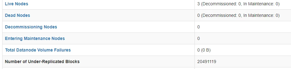

Hi,

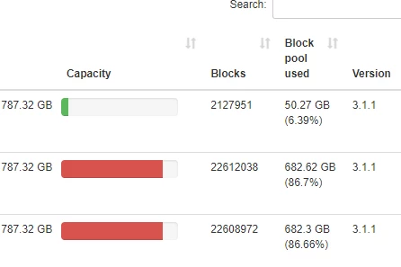

We have 3 datanodes but the other 1 is not having expected number of blocks compared to the other 2.
Also, the count of under-replicated blocks is high.

Is there a way to fix the high number of under-replicated blocks?

@Noel_0317 Do you have rack awareness configured for the Datanodes?
Also, check for any disk-level issues on the datanode.
Try enabling Debug for block placement :
log4j.logger.org.apache.hadoop.hdfs.server.blockmanagement.BlockPlacementPolicy=DEBUG
log4j.logger.org.apache.hadoop.hdfs.protocol.BlockStoragePolicy=DEBUG
