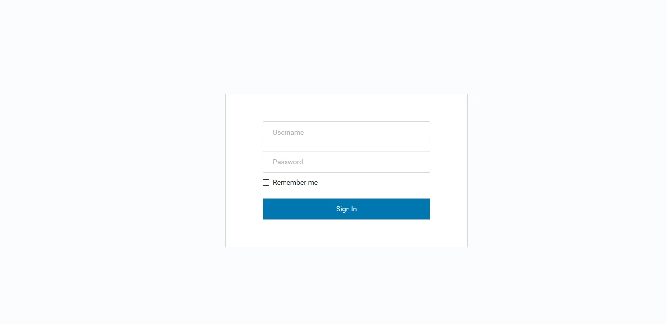

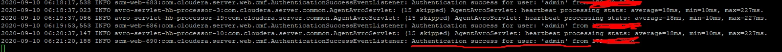

@GangWardone what you said. but now I am not able to login with the default username password admin/admin. can you please help with this?clouderaloginpage.pngclouderalogs.png

@vaibhavm Log says it's successful. Try with another browser else you might need to reset the password for local user. Also worth to see if you are using LDAP with CM.

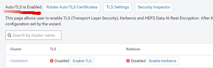

The solution above has been the accepted answer for a long time (since CM 6.x), but the procedure is not complete, at least for Cloudera Manager 7.6 with CDP Base 7.1.6 or above.
After using Auto-TLS and needing to disable it because I needed to rename some nodes, I changed the web_tls and agent_tls settings in the Database, and changed the config.ini to disable TLS in all the agents' config and restarted all the cloudera-scm-* daemons (server/agents) and I was able to log to the UI and reach the hosts, but in "Management >> Security" the Cloudera Manager UI keeps showing "Auto-TLS is Enabled" in the menu bar, and if I try to add a new host it will fail with an error like "Unable to deploy host certificates" ... so it seems CM still has Auto-TLS enable somewhere/somehow.
I have made a dump and double checked there isn't any TLS config parameter enabled in the DB, but there should be some other place from where CM assumes this is enabled.

Remove all TLS related config in CM UI. CM > Settings search for TLS and uncheck everything and delete jks files and password configs

lvazquez
Gold ⭐️
Jul 8, 2022 3:44 PM UTC
I thought it was something like this, but it was hard to believe!
After 2 full installation of CDP base, it seems clear that CDP may have been a big step for the final user, but still has a lot of room for improvement in the sysadmin and devops side of the platform, specially in the way-back or recovery of many central configuration changes (kerberos, TLS) where it really sucks, even when compared with the now ancient HDP3.
