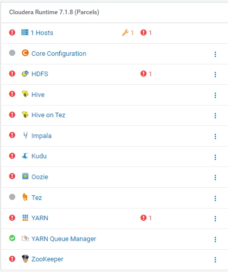

Good morning Community,
i'm suffering of DNS resolution getting the following fatalistic view every time I access to CM:
I'm reading a lot but not getting any robust conclussion of what is the test that concludes in "DNS resolution error".
it checks "host's hostname and canonical name" but, what does it means? is it the hostname? the name in the /etc/hosts?
In my case, having
[root@master1 ~]# hostname
master1
[root@master1 ~]# python -c "import socket; print socket.getfqdn(); print socket.gethostbyname(socket.getfqdn())"
master1.domain.net
192.168.0.90
does it means the discrepancy between hostname and socket.getfqdn()?
I can see how many people is getting this error but not a consistent response, could anyone give the solution here? for trying to understand this common issue?
Many thanks in advance.

Hello, im using rhel8.4 but still the same.
The etc/sysconfig/network file is empty but the network still working, im using the etc/hosts wth ips, fqdn and aliases.
The nslookup is not working, do i must to have a dns server?? I mean, in a local network configuring etc/hosts don't thik so...
Anybody knows how this works and what is the exact commands used for this test? This shouldn't be so difficult, I've read the topics and followed the recommendations but nothing.
Many thanks for your help

Hello all,
Finally found the root cause...
/Etc/hosts
192.168.0.10 master1.customerdomain.com
# Hostname
Master1
This is the discrepancy, setting the hostname to the same as shown in /etc/hosts, the issue was solved.
Command used: # hostnamectl set-hostname master1.customerdomain.com
Then restarted the agent daemon and services in the cluster.
Many thanks to the community for so many clues.
