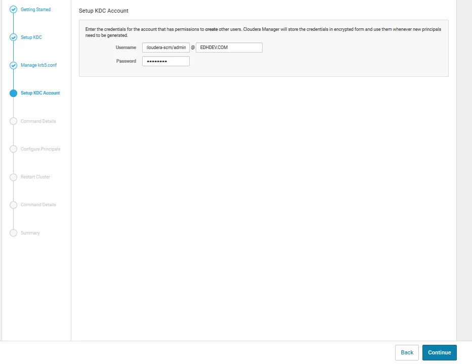

I try to enable Kerberos using the CM wizard.
When I reach the Setup KDC Account I set the cloudera-scm@REALM principal and the Continue button is enabled.
I try to click on it to proceed but nothing happens.

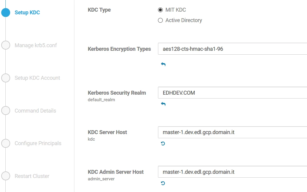

I run the wizard in CM to enable Kerberos on my cluster.
I set KDC host and Encryption type according to previous output
Here I configure the principal but nothing happens when I click on Continue:

Go to the CM and launch the kerberization using  this below the principal
admin/admin@EDHDEV.COM
Please make the above changes restart the kdc and retry kerberization it should go smoothly
