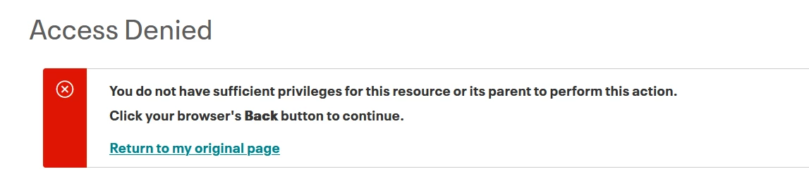

Hi @Manish2800 thank you for your answer, i cannot access to the link:
So regading the --trusted-ca-certs option, i need to use it only if i have to setup tls connection from cloudera clustera to external services. Is it correct?

You need to have Cloudera account to access the KB articles. Kindy reach out to Cloudera Sales team if you are looking for one.
Here is the public doc for AutoTLS Use case 3 :
https://docs.cloudera.com/cdp-private-cloud-base/7.1.7/security-encrypting-data-in-transit/topics/cm-security-use-case-3.html
And yes you need to use --trusted-ca-certs option only to add more CA certificates which are used to sign the certificates of external services like LDAPS if you will be connecting CDP services to LDAPS
