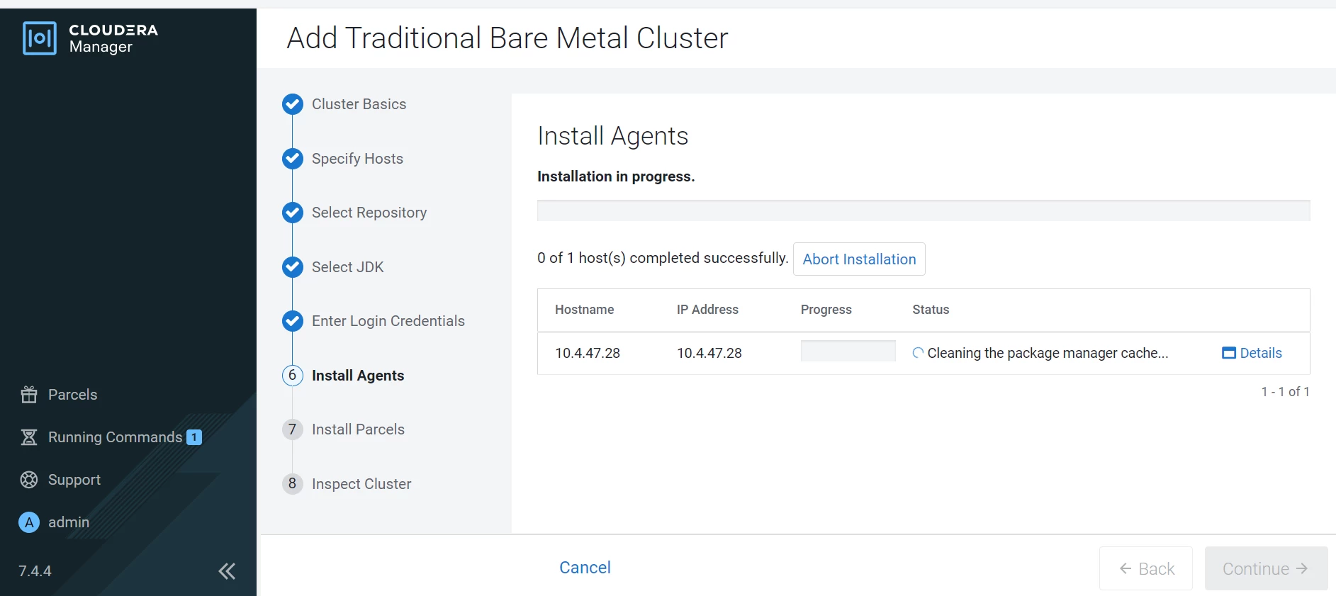

I am getting the below error while installing the agent. I am working on Ubuntu 20.04. It's a single machine cluster I want to make. Can anyone help me out with this?
Cleaning the package manager cache... View Failed to acquire installation lock. View
/tmp/scm_prepare_node.OHxqRMPm
using SSH_CLIENT to get the SCM hostname: 10.4.47.28 49784 22
opening logging file descriptor
Starting installation script...
Acquiring installation lock...
/tmp/scm_prepare_node.OHxqRMPm/scm_prepare_node.sh: line 1415: /tmp/.scm_prepare_node.lock: Permission denied
could not open lock file, giving up
waiting for rollback request
detected rollback request
rolling back installation
Reverting changes...
rollback started
Removing package repositories...
unknown packager , exiting
closing logging file descriptor

Hello @avi_fcb  I can see it is failing with a permission denied error. Can you please check the permission on /tmp

Many thanks @Scharan . That was a permission error indeed.

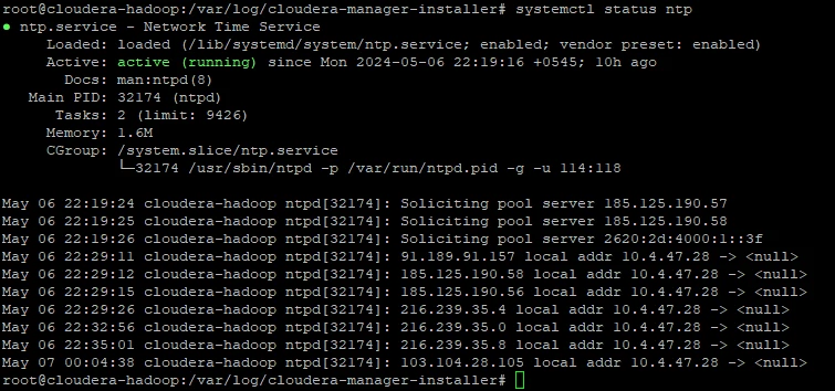

Hello @Scharan , I installed the NTP, but still the same error.
Any suggestions on what went wrong?
