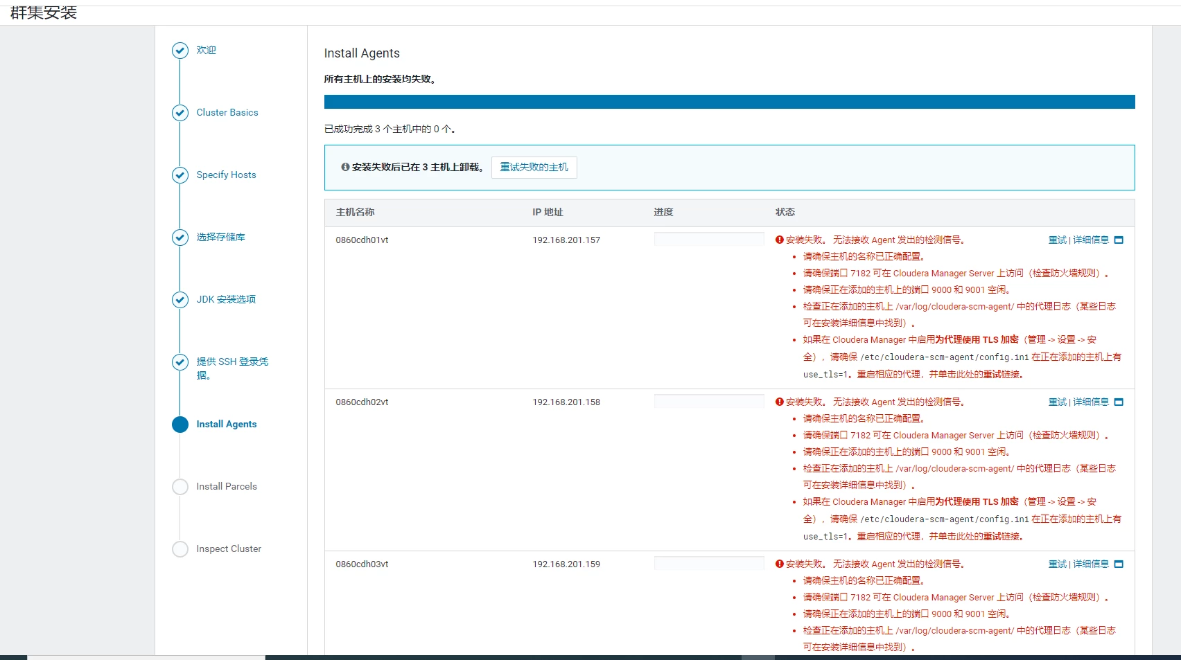

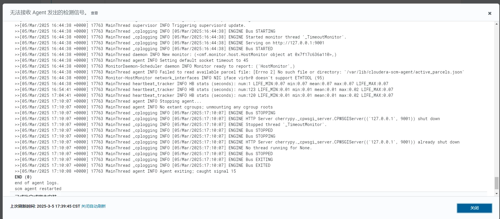

ERROR Installing Agent
Hi everyone
When installing cloudera-scm-agent, the installation failed due to heartbeat check failure. However, the backend logs show no errors and even output INFO-level logs indicating successful heartbeat detection. What could be the root cause?
agent.logagent.loginstalling loginstalling logserver.logserver.log企业微信截图_17411675661642.png

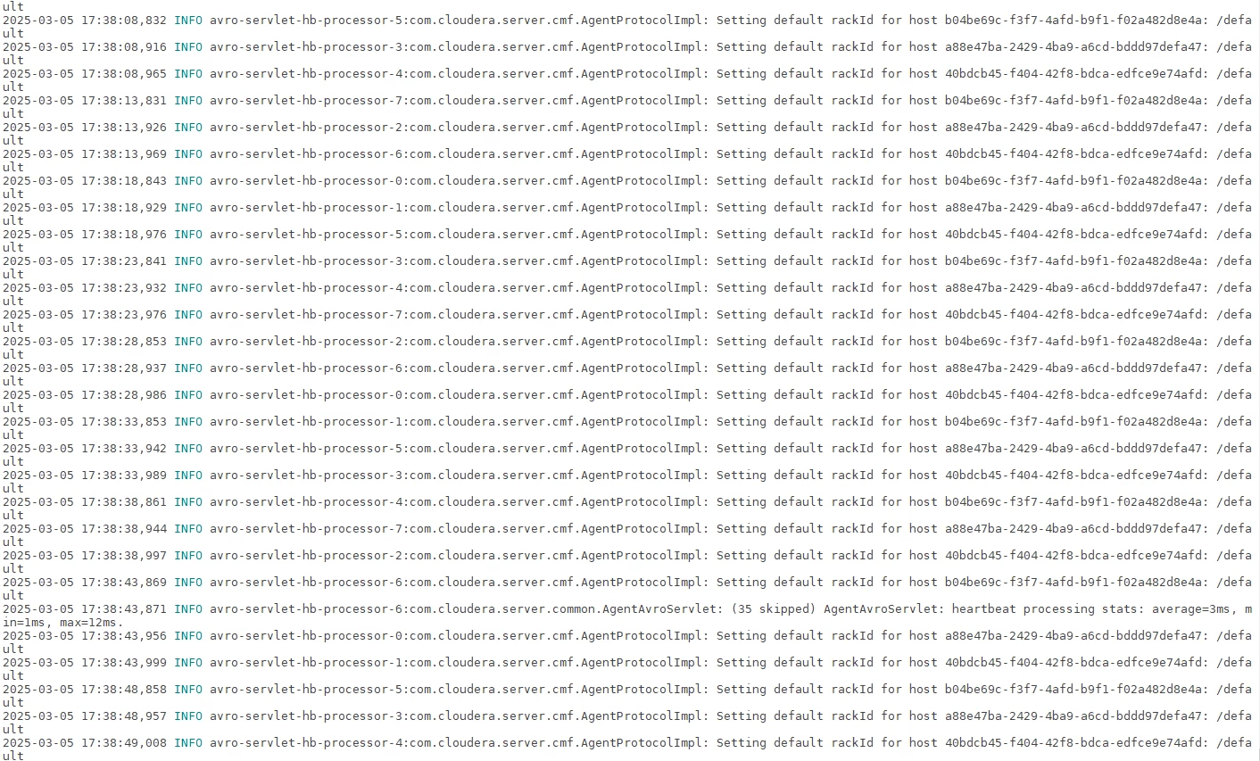

Anyways if you are observing heartbeat success in the agent and server_host is correct set to CM server in /etc/cloudera-scm-agent/config.ini then two things we will need to check
a.) CM Server logs (/var/log/cloudera-scm-server/cloudera-scm-server.log) on CM server host
b.) capture network packet dump on CM side on port 7182 and analyze the packets on port 7182 whether client request is reaching or not

Hi,
the version is 6.3.1
config.ini:

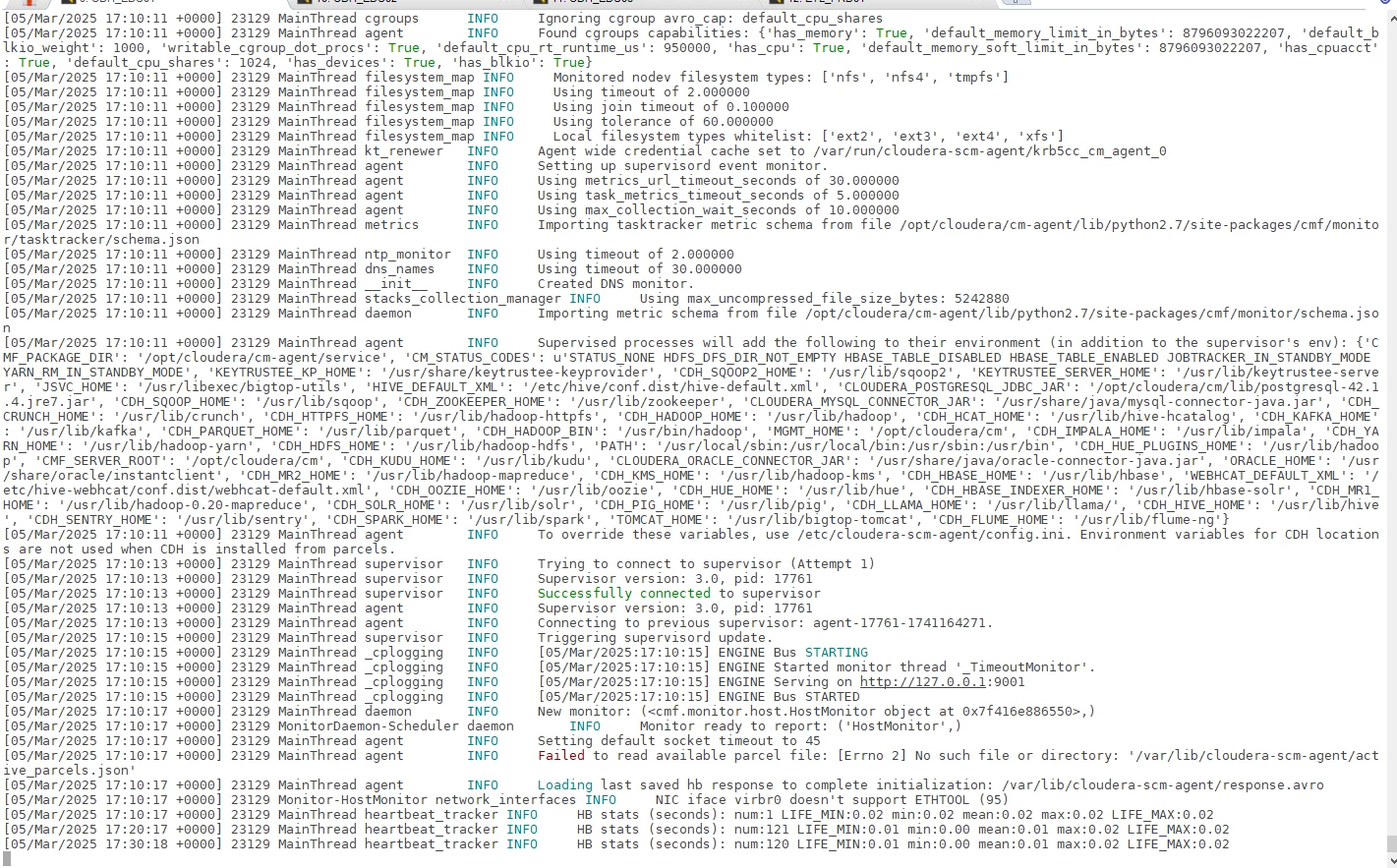

messages:
Mar 5 17:08:48 0860cdh03vt systemd-logind: New session 15 of user root.
Mar 5 17:08:48 0860cdh03vt systemd: Started Session 15 of user root.
Mar 5 17:10:01 0860cdh03vt systemd: Started Session 16 of user root.
Mar 5 17:10:07 0860cdh03vt systemd: Stopping Cloudera Manager Agent Service...
Mar 5 17:10:08 0860cdh03vt systemd: Stopped Cloudera Manager Agent Service.
Mar 5 17:10:08 0860cdh03vt systemd: Started Cloudera Manager Agent Service.
Mar 5 17:10:09 0860cdh03vt cm: [05/Mar/2025 17:10:09 +0000] 15752 MainThread logging INFO SCM Agent (agent) Version: 6.3.1
Mar 5 17:10:09 0860cdh03vt cm: [05/Mar/2025 17:10:09 +0000] 15752 MainThread main INFO Executing with arguments: /opt/cloudera/cm-agent/bin/cm agent
Mar 5 17:10:09 0860cdh03vt cm: [05/Mar/2025 17:10:09 +0000] 15752 MainThread navigator_thread INFO Creating the Audit Thread
Mar 5 17:10:09 0860cdh03vt cm: [05/Mar/2025 17:10:09 +0000] 15752 MainThread navigator_thread INFO Creating the Metadata Thread
Mar 5 17:10:09 0860cdh03vt cm: [05/Mar/2025 17:10:09 +0000] 15752 MainThread navigator_thread INFO Creating the Profile Thread
Mar 5 17:10:09 0860cdh03vt cm: [05/Mar/2025 17:10:09 +0000] 15752 MainThread main INFO Using existing process limit: (127909, 127909)
Mar 5 17:10:09 0860cdh03vt cm: [05/Mar/2025 17:10:09 +0000] 15752 MainThread agent INFO Missing database jar: /usr/share/java/mysql-connector-java.jar (normal, if you're not using this database type)
Mar 5 17:10:09 0860cdh03vt cm: [05/Mar/2025 17:10:09 +0000] 15752 MainThread agent INFO Missing database jar: /usr/share/java/oracle-connector-java.jar (normal, if you're not using this database type)
Mar 5 17:10:09 0860cdh03vt cm: [05/Mar/2025 17:10:09 +0000] 15752 MainThread agent INFO Found database jar: /opt/cloudera/cm/lib/postgresql-42.1.4.jre7.jar
Mar 5 17:10:09 0860cdh03vt cm: [05/Mar/2025 17:10:09 +0000] 15752 MainThread agent INFO Not starting a new session.
Mar 5 17:10:09 0860cdh03vt cm: [05/Mar/2025 17:10:09 +0000] 15752 MainThread agent INFO Re-using pre-existing directory: /run/cloudera-scm-agent
Mar 5 17:10:09 0860cdh03vt cm: [05/Mar/2025 17:10:09 +0000] 15752 MainThread agent INFO Re-using pre-existing directory: /var/run/cloudera-scm-agent/supervisor
Mar 5 17:10:09 0860cdh03vt cm: [05/Mar/2025 17:10:09 +0000] 15752 MainThread agent INFO Re-using pre-existing directory: /var/run/cloudera-scm-agent/flood
Mar 5 17:10:09 0860cdh03vt cm: [05/Mar/2025 17:10:09 +0000] 15752 MainThread agent INFO Re-using pre-existing directory: /var/run/cloudera-scm-agent/supervisor/include
Mar 5 17:10:09 0860cdh03vt cm: [05/Mar/2025 17:10:09 +0000] 15752 MainThread agent INFO Re-using pre-existing directory: /var/run/cloudera-scm-agent/cgroups
Mar 5 17:10:09 0860cdh03vt cm: [05/Mar/2025 17:10:09 +0000] 15752 MainThread agent INFO Re-using pre-existing directory: /var/run/cloudera-scm-agent/process
Mar 5 17:10:09 0860cdh03vt cm: [05/Mar/2025 17:10:09 +0000] 15752 MainThread tmpfs INFO Reusing mounted tmpfs at /var/run/cloudera-scm-agent/process
Mar 5 17:10:09 0860cdh03vt cm: [05/Mar/2025 17:10:09 +0000] 15752 MainThread logging INFO Logging to /var/log/cloudera-scm-agent/cloudera-scm-agent.log
Mar 5 17:10:17 0860cdh03vt cm: /opt/cloudera/cm-agent/lib/python2.7/site-packages/psutil/_pslinux.py:477: RuntimeWarning: dirty, writeback, mapped, commit_limit memory stats couldn't be determined and were set to 0
Mar 5 17:10:17 0860cdh03vt cm: warnings.warn(msg, RuntimeWarning)

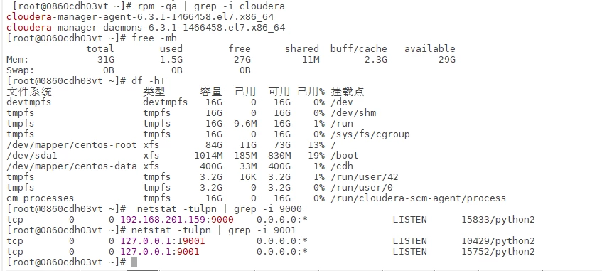

Also can you share the output of below command from the affected node
# rpm -qa | grep -i cloudera
# free -mh
# df -hT
# netstat -tulpn | grep -i 9000
# netstat -tulpn | grep -i 9001

I restarting the agent but not helped
below is output of your shared command from the affected node

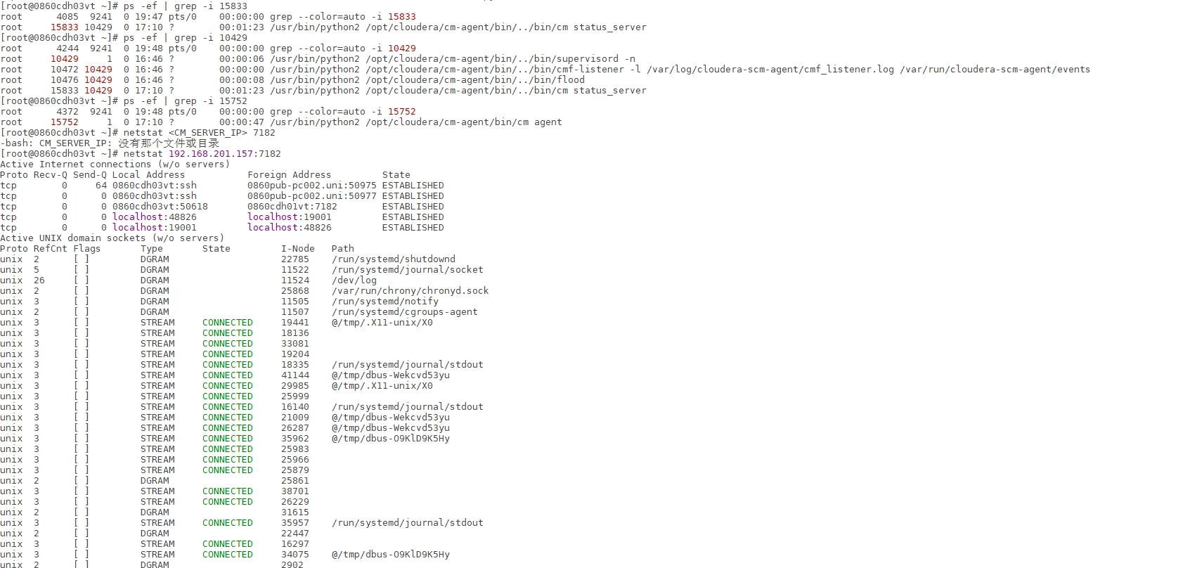

Can you check if all three PID's are cloudera process only
# ps -ef | grep -i 15833
# ps -ef | grep -i 10429
# ps -ef | grep -i 15752

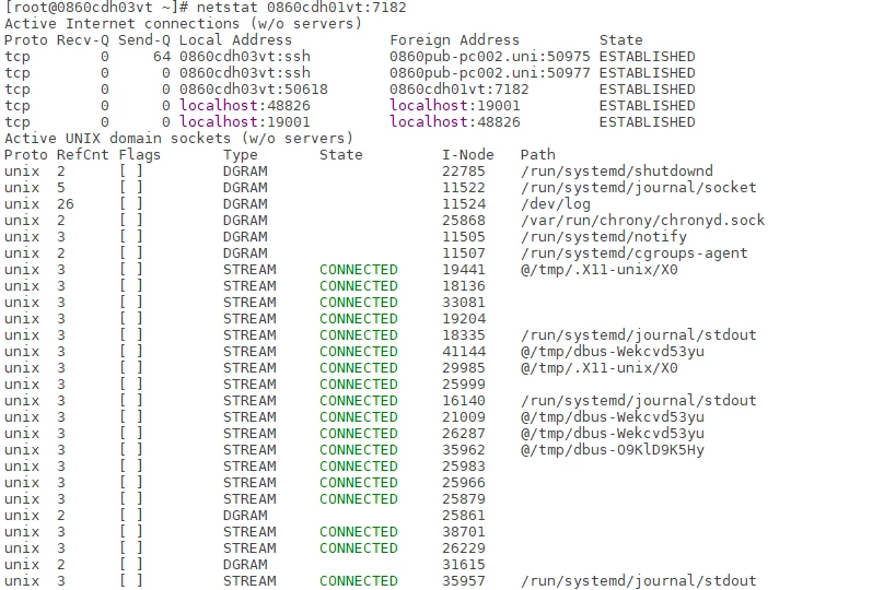

# netstat <CM_SERVER_IP> 7182
# netstat <CM_SERVER_HOST> 7182

I'm checked all three PID's are cloudera process only

Hello @xiaocao
Sorry, there was a typo Please run the below command
# telnet  <CM_SERVER_IP> 7182
# telnet <CM_SERVER_HOST> 7182
# systemctl status cloudera-scm-agent
