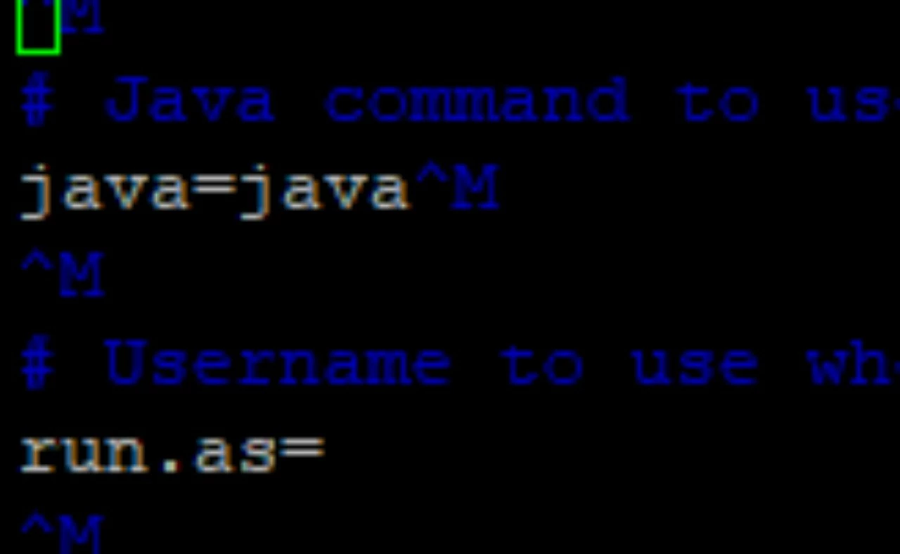

I'm having a problem trying to create a nifi cluster with kubernetes.
Error displayed: "The specified run.as user ec2-user does not exist. Exiting."
The error appears when I use /opt/nifi/nifi-current/conf folder mapping
If I remove this mapping from the nifi folder, the cluster is created without problems.
But I need this folder to keep the data flows if the container dies, come back with the data
the folder in the instance is in /home/ec2-user/user/1.16
I already gave permission 777 on the folder to test and it still didn't work
I already changed the user to upload with root user and nifi (pid 0 and 1000) and it didn't work
Matheus-Mattos
Gold ⭐️
Apr 11, 2022 3:28 PM UTC
Find out the problem.
It seems that in versions above 1.14 the bootstrap.conf file has an option in the ^M file
where you can change the file parameters
I removed this option in the value "Run.as"
and the problem was solved
