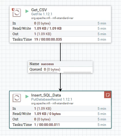

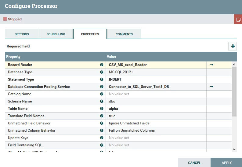

I have built a simple flow using GetFile and PutDatabaseRecord processorsflow.png

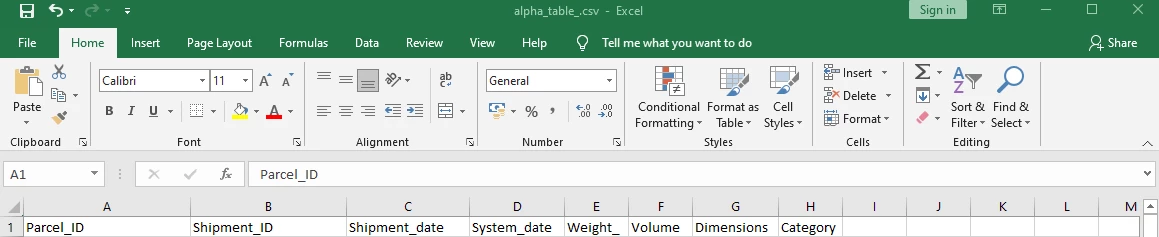

My input is a simple table with 8 columns

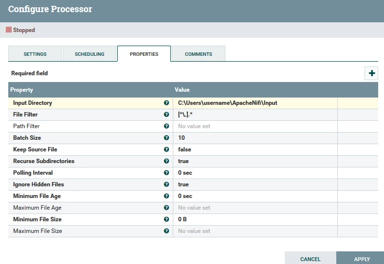

My configurations for GetCSV process are here (I have added the input directory and left the rest as default)
The configuration for PutDatabaseRecord process is here (I have referred to the CSVReader and DBCPConnectionPool controller services, used the MS SQL 2012+ database type (I have 2019 version), configured INSERT statement type, inserted the schema and correct table name and left everything else as default)

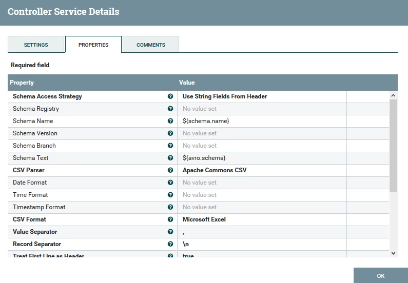

The CSVReader configuration looks as shown here (Schema Access Strategy = Use String Fields From Header; CSV Format = Microsoft Excel)

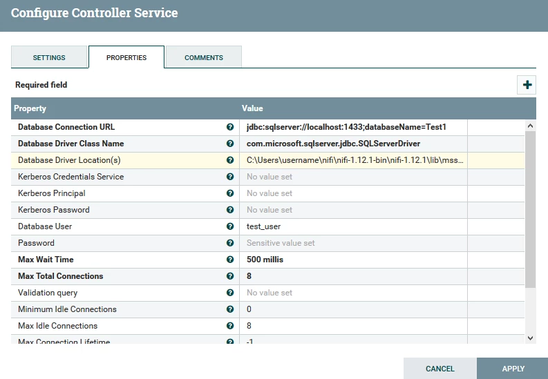

And this is the configuration of the DBCPConnectionPool (I have added the correct URL, DB driver class name, driver location, DB user and password)

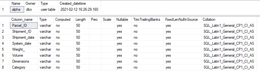

Finally, this is a snapshot of the description of the table I have created in the database to host the content

The warning "None of the fields in the record map to the columns defined by the tablename table." is also obtained when the processor is not able to find the table and this can happen also when the table name is correctly configured in PutDatabaseRecord but there is some issue with user access rights (which ended up to be the actual cause of my error ...).

As far as I see the cause could be different column names and in the PutDatabaseRecord the option "Unmatched Column Behavior" is set to "Fail on Unmatched Columns".
I suppose the options concerning "Unmatched Field Behavior" or "Unmatched Column Behavior" in connection with "Translate Field Names" causing your problem.
Perhaps you like to post your schema-definition?
But at the moment I can't give you a concreter answer.

I am really stuck with this. I tried many different things (for example, table name = dbo.alpha, CSV Format = Customer Format, ...), always with same result.
Now I changed Unmatched Column Behaviour (Unmatched Column Behaviour = Ignore Unmatched Columns). Again same result.
I also tried with xlsx files by using a ConvertExcelToCSVProcessor in the middle. Same result.
