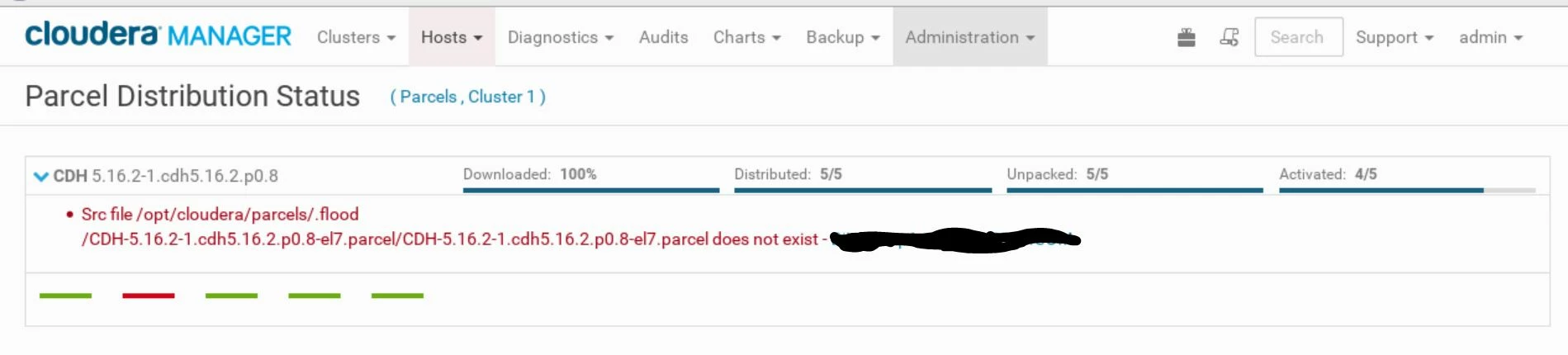

Error while activating parcels
Hello All,
I am trying to deploy a 6-node cluster and one of the nodes I am getting attached error while activating parcels. I had tried to copy the mentioned contents from another host where the parcels are activated but I run out of space on the host where issue persists, surprisingly both the host have the same disk space of 5GB in /opt.
Requesting your assistance / guidance in resolving this issue.Capture.JPG

@wert_1311,
Cloudera and the agents will communicate to make sure that parcels are distributed and enabled on all hosts that are managed.  In this case, it sounds as if your attempts to copy information may have contributed to running out of space.  5GB isn't much space, though, so it could be you will need more space.
To allow the agent to correct the situation, you can do the following:
(1)
Stop the agent
service cloudera-scm-agent stop
(2)
remove the contents of the parcels directory:
/opt/cloudera/parcels/*
(3)
Start the agent:
service cloudera-scm-agent start
(4)
Monitor the agent log to see if it starts downloading the files.
