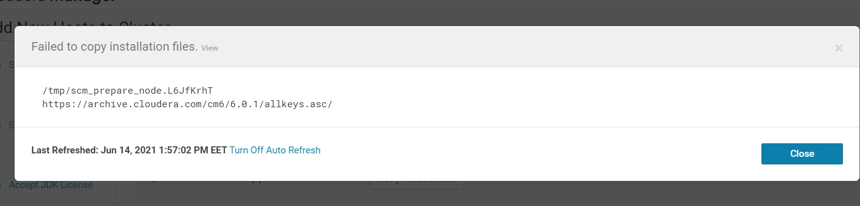

Hello @Exor ,
The issue seems to be that the agent is not able to connect to archive.cloudera.com.
Could you check or share what the failure is via the log files present under /tmp/scm_prepare_node.*/*

there no log files in that dir, only the below 3 files, also .sh is not executable

Hi @Exor ,
I am guessing that the key part of the log for this issue is this:
2021-06-15 08:39:14,498 INFO NodeConfiguratorThread-6-0:com.cloudera.server.cmf.node.NodeConfigurator: Using key bundle from URL: https://archive.cloudera.com/cm6/6.0.1/allkeys.asc
2021-06-15 08:39:14,960 INFO NodeConfiguratorThread-6-0:com.cloudera.server.cmf.node.NodeConfiguratorProgress: node5: Setting COPY_FILES as failed and done state
The log doesn't indicate it, but the server archive.cloudera.com is probably returning an HTTP 401 error because authentication is required.
You didn't provide the version of Cloudera Manager you're using, but I would guess that the last time you attempted this operation, you were not challenged for authentication by this particular host at Cloudera and so you're wondering what changed recently.
The answer is probably that your installation of Cloudera Manager isn't set up to supply the authentication credentials. Earlier this year, Cloudera announced new versions of Cloudera Manager 6.x that are required to access Cloudera’s repositories. Please see the announcement here: Transition to private repositories for CDH, HDP and HDF.
The same announcement describes the new patch releases of Cloudera Manager, which are required to access Cloudera’s private repositories, which now contain the new and legacy releases and other assets such as those necessary to add a new host to an existing CDH cluster.
