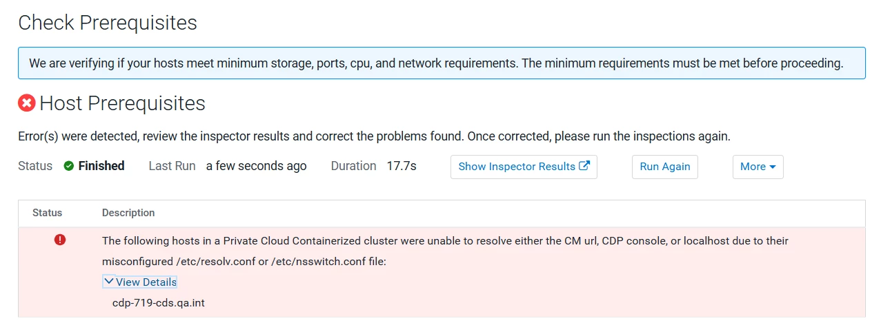

Error while installing Data Services
We have Cloudera Private Cloud 7.1.9
When trying to install Data Services, we get this error:
    "unable to resolve either the CM url, CDP console, or localhost"
We verified DNS settings and the hostname is resolved correctly.
What can the issue be? where can we find logs with additional details?

Hello @Oren
Thank you for reaching out to the community
Please double-check the following especially vault.localhost.localdomain’s ping should be resolved
https://docs.cloudera.com/cdp-private-cloud-data-services/1.5.4/installation-ecs/topics/cdppvc-installation-ecs-steps.html
Checks to make sure there are less than 3 nameserver entries in the /etc/resolv.conf file, and checks the connections to the Cloudera Manager cluster and the CDP console. It also checks to see if vault.localhost.localdomain’s ping can be resolved. If not, it is likely that the host /etc/nsswitch.conf file is misconfigured.
If this inspection fails:
Check the /etc/resolv.conf and /etc/nsswitch.conf files and ensure that /etc/resolv.conf does not contain 3 or more nameservers, and that /etc/nsswitch.conf must contain myhostname under the hosts field.
Check to see if the connections were resolved correctly. If connection to the CDP console fails, check to see if your DNS wildcard is configured properly.
 Let us know if you have any further queries

Hello @shaihavivqlik
That's really strange. Usually, this error occurs when we cannot lookup
Can you check your /etc/hosts as well? Also, try pinging your CM server as well
 Something is for sure wrong in the DNS records. I don't we can check any logs as this is failing at the pre-reqs itself

Hello,
Thank you for your update
Can you please confirm if you are able to ping localhost
# nslookup localhost
How many nameservers are present in /etc/resolv.conf

I get this when running nslookup localhost
Non-authoritative answer:
Address: 127.0.0.1
** server can't find localhost: SERVFAIL
I have 1 nameserver in resolv.conf

So here is the error localhost is not resolving
Please fix the /etc/hosts from any of the working node
Check if the below lines are added or not
127.0.0.1 localhost localhost.localdomain localhost4 localhost4.localdomain4
::1 localhost localhost.localdomain localhost6 localhost6.localdomain6

this is how the hosts file looks:
Translate

Can you please fix the localhost thing
nslookup localhost should resolve
Can you also verify if the wildcard dns is set up correctly
*.apps.myhostname.com
https://docs.cloudera.com/cdp-private-cloud-data-services/1.5.4/installation-ecs/topics/cdppvc-installation-ds-checklist.html
I faced the same error as you this time, and I had the above mentioned problem so please double check this as well
