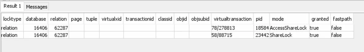

ManjuN
ManjuNAuthor
Silver ⭐️⭐️
Mar 19, 2021 10:07 AM UTC
Thanks Asish,
now facing some other issue,
I have been reindex the corrupted indexes successfully(hl_txnid_index and tc_txnid_index),
but now unable to query the any table's in Hive,
In Postgresql logs showing
2021-03-19 09:00:15 UTC::@:[9941]:LOG: skipping vacuum of "hive_locks" --- lock not available
2021-03-19 09:00:31 UTC::@:[10049]:LOG: skipping vacuum of "hive_locks" --- lock not available
2021-03-19 09:00:46 UTC::@:[10178]:LOG: skipping vacuum of "hive_locks" --- lock not available
SELECT * FROM pg_locks WHERE relation = 'HIVE_LOCKS'::regclass;
please check attached file for locks,
And also in Hive logs showing Unable to rename temp file
2021-03-19T09:59:27,909 ERROR [json-metric-reporter]: metrics2.JsonFileMetricsReporter (:()) - Unable to rename temp file /tmp/hmetrics8066666106938386459json to /tmp/report.json
2021-03-19T09:59:27,909 ERROR [json-metric-reporter]: metrics2.JsonFileMetricsReporter (:()) - Exception during rename
java.nio.file.FileSystemException: /tmp/hmetrics8066666106938386459json -> /tmp/report.json: Operation not permitted
at sun.nio.fs.UnixException.translateToIOException(UnixException.java:91) ~[?:1.8.0_232]
at sun.nio.fs.UnixException.rethrowAsIOException(UnixException.java:102) ~[?:1.8.0_232]
at sun.nio.fs.UnixCopyFile.move(UnixCopyFile.java:396) ~[?:1.8.0_232]
at sun.nio.fs.UnixFileSystemProvider.move(UnixFileSystemProvider.java:262) ~[?:1.8.0_232]
at java.nio.file.Files.move(Files.java:1395) ~[?:1.8.0_232]
at org.apache.hadoop.hive.common.metrics.metrics2.JsonFileMetricsReporter.run(JsonFileMetricsReporter.java:175) ~[hive-common-3.1.0.3.1.0.0-78.jar:3.1.0.3.1.0.0-78]
at java.util.concurrent.Executors$RunnableAdapter.call(Executors.java:511) ~[?:1.8.0_232]
at java.util.concurrent.FutureTask.runAndReset(FutureTask.java:308) ~[?:1.8.0_232]
at java.util.concurrent.ScheduledThreadPoolExecutor$ScheduledFutureTask.access$301(ScheduledThreadPoolExecutor.java:180) ~[?:1.8.0_232]
at java.util.concurrent.ScheduledThreadPoolExecutor$ScheduledFutureTask.run(ScheduledThreadPoolExecutor.java:294) ~[?:1.8.0_232]
at java.util.concurrent.ThreadPoolExecutor.runWorker(ThreadPoolExecutor.java:1149) ~[?:1.8.0_232]
at java.util.concurrent.ThreadPoolExecutor$Worker.run(ThreadPoolExecutor.java:624) ~[?:1.8.0_232]
at java.lang.Thread.run(Thread.java:748) [?:1.8.0_232]
