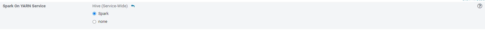

Hive has Spark configured as  dependency

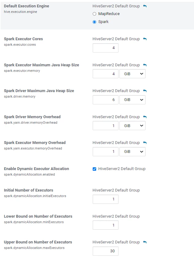

Have this settings in  hive-site.xml
<property><name>hive.spark.client.connect.timeout</name><value>30000ms</value></property><property><name>hive.spark.client.server.connect.timeout</name><value>300000ms</value></property>
Some Other settings
Java Configuration Options for HiveServer2
-XX:+UseParNewGC -XX:+UseConcMarkSweepGC -XX:CMSInitiatingOccupancyFraction=70 -XX:+CMSParallelRemarkEnabled -XX:MaxPermSize=512M -XX:+UseParNewGC -XX:-UseGCOverheadLimit
I do not see any applications in the hadoop web UI.
The logs are below
From what I can tell hive does not recognize where spark libraries are. I believe this should have been addressed by setting hive dependency on Spark.
 What am I missing?

quick update.
ran spark shell and got better errors indicating wrong config settings
$ spark-shell --master yarn
Using Spark's default log4j profile: org/apache/spark/log4j-defaults.properties
Setting default log level to "WARN".
To adjust logging level use sc.setLogLevel(newLevel). For SparkR, use setLogLevel(newLevel).
22/11/04 16:59:48 WARN NativeCodeLoader: Unable to load native-hadoop library for your platform... using builtin-java classes where applicable
22/11/04 16:59:49 ERROR SparkContext: Error initializing SparkContext.
java.lang.IllegalArgumentException: Required executor memory (1024 MB), offHeap memory (0) MB, overhead (384 MB), and PySpark memory (0 MB) is above the max threshold (1024 MB) of this cluster! Please check the values of 'yarn.scheduler.maximum-allocation-mb' and/or 'yarn.nodemanager.resource.memory-mb'.
at org.apache.spark.deploy.yarn.Client.verifyClusterResources(Client.scala:368)
at org.apache.spark.deploy.yarn.Client.submitApplication(Client.scala:199)
