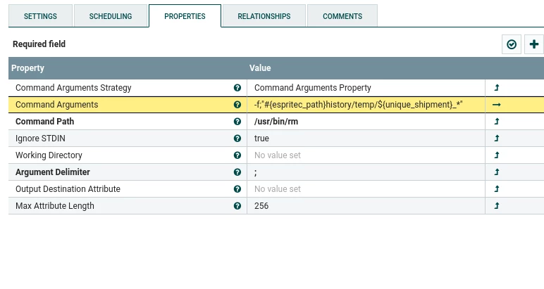

Hello,
hope someone can point me in the right direction.

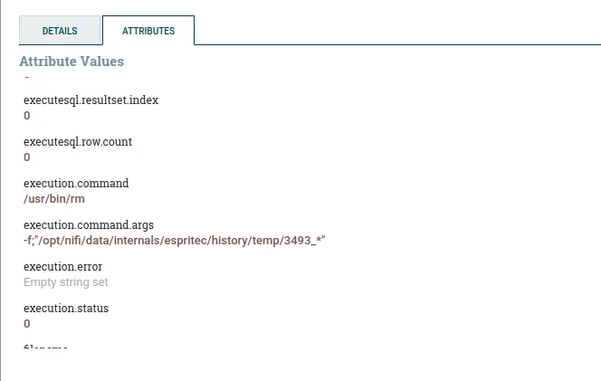

I need to delete all files starting with some attributes value, so based on Linux way it should be something like this:
rm -f /opt/my_path/myfile_*
I decided to use Execute Stream Command in this way:
The path seem correct, the command generated, pasted into a Linux shell is working fine, however the processor did not delete the files.
If i try with a specific file it works fine.
Seems that * is not permitted, any clue?
Many Thanks to everybody...

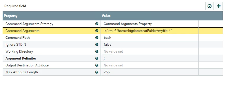

hmmm, try maybe with:
Command Path = bash
Command Arguments = -c;"rm -f /home/bigdata/testFolder/myfile_*"
I tried this on my local machine and it seems to be working accordingly.

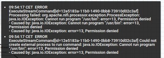

Mar 16, 2023 8:56 AM UTC
Hi,
tried your suggestion, however in that case this is the error:

Mar 16, 2023 9:43 AM UTC
Command Path = bash
