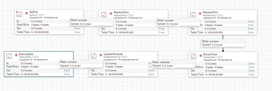

Hi all, I'm a newbie. I want to read a local .csv file that contains only an ID column, then use that list of ID in a dynamic query to get data from an oracle table. My flow is as below:
I configure processors as following:

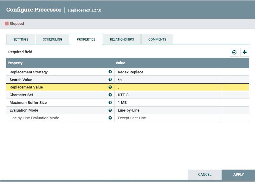

+ReplaceText(1): is to replace "\n" with ","

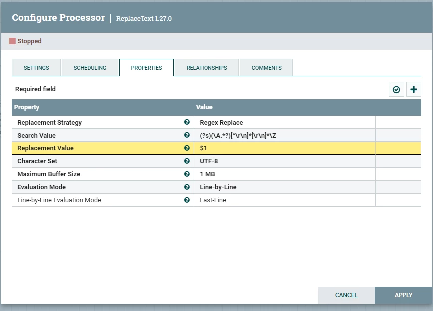

+ ReplaceText(2): Remove the last empty row

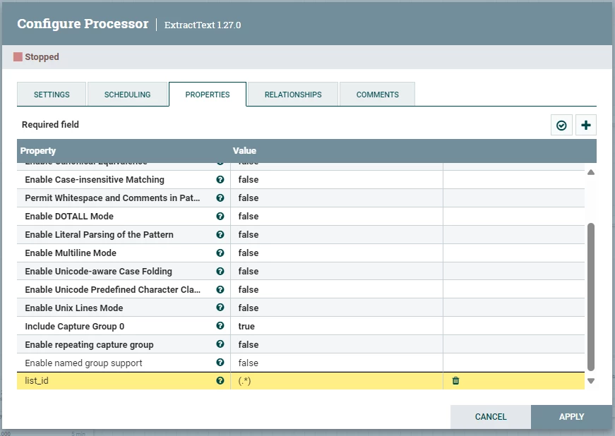

+ ExtractText: assign ID list to attribute named list_id

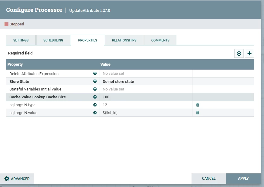

+UpdateAttribute: to specify name and value of property. The list contains 10 ID

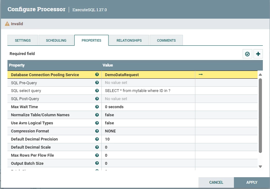

+ ExecuteSQL:

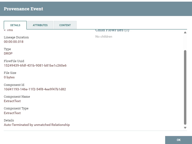

There is no task In for UpdateAttribute, the flow stop at ExtractText, the detail tab in view data governance is below, it said File.Size is 0 bytes.
However it doesn't return any error so I don't know where to fix. Could you please help.

2- Its not recommended to use ExtractText to extract the whole content of a flowfile into an attribute when you cant control how big the content can be. you will hear that a lot that attribute are stored in JVM heap which could be limited and expensive which can cause problem if you have large content.
3-When passing parameters to your SQL query through file attribute the N placeholder in sql.args.N.value stands for the parameter index in the query , for example if you the following insert statement:
insert into Table1 (col1, col2) values (?,?)
Then the processor expects two set of sql attributes where for the first arg (N=0 ) and the second (N=1) as in sq1.args.0.value, sql.args.1.value...etc.

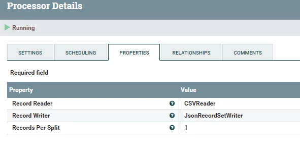

2- Use SplitRecord to to get every json record into singleflow and convert it into into format that is easy to parse and extract attributes using methods other than Regex in ExtractText, here is an example:
Im converting to Json  because I can extract the ID  using json path as we will see in the next step.
You can use the default setting for the reader and writer services.

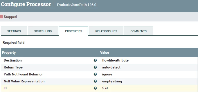

3- User EvaluateJsonPath to extract the ID into an attribute. This way we know that the value we are going to extract is single integer value and we wont be concerned much about heap storing large content.

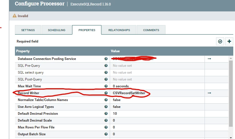

As I mentioned above the ExecuteSQL will give you the result in Avro format which you cant do much parsing with unless you convert to other parsable format (json, csv, xml...etc) using ConvertRecord , however you can save the the need for ConvertRecord by using ExecuteSQLRecord instead of ExecuteSQL where you can set the record writer to whatever format before sending the result to the success relationship. Lets assume I want to convert the result back to CSV, the configuration would be:
