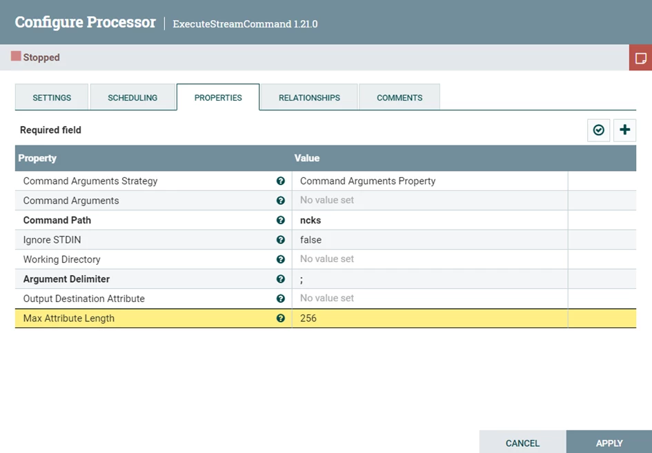

The netCDF data comes in via InvokeHTTP (generates a flowfile with ‘Content Type:application/x-netcdf’), and is subsequently fed to the ExecuteStreamCommand. I have it configured as follows

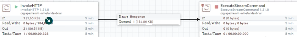

‘ncks’ is the executable command from the NCO Toolkit. This is on my path, such that I am sure NiFi can reach it. When I run the flow as follows
I receive errors on the ExecuteStreamCommand processor. These are as follows
