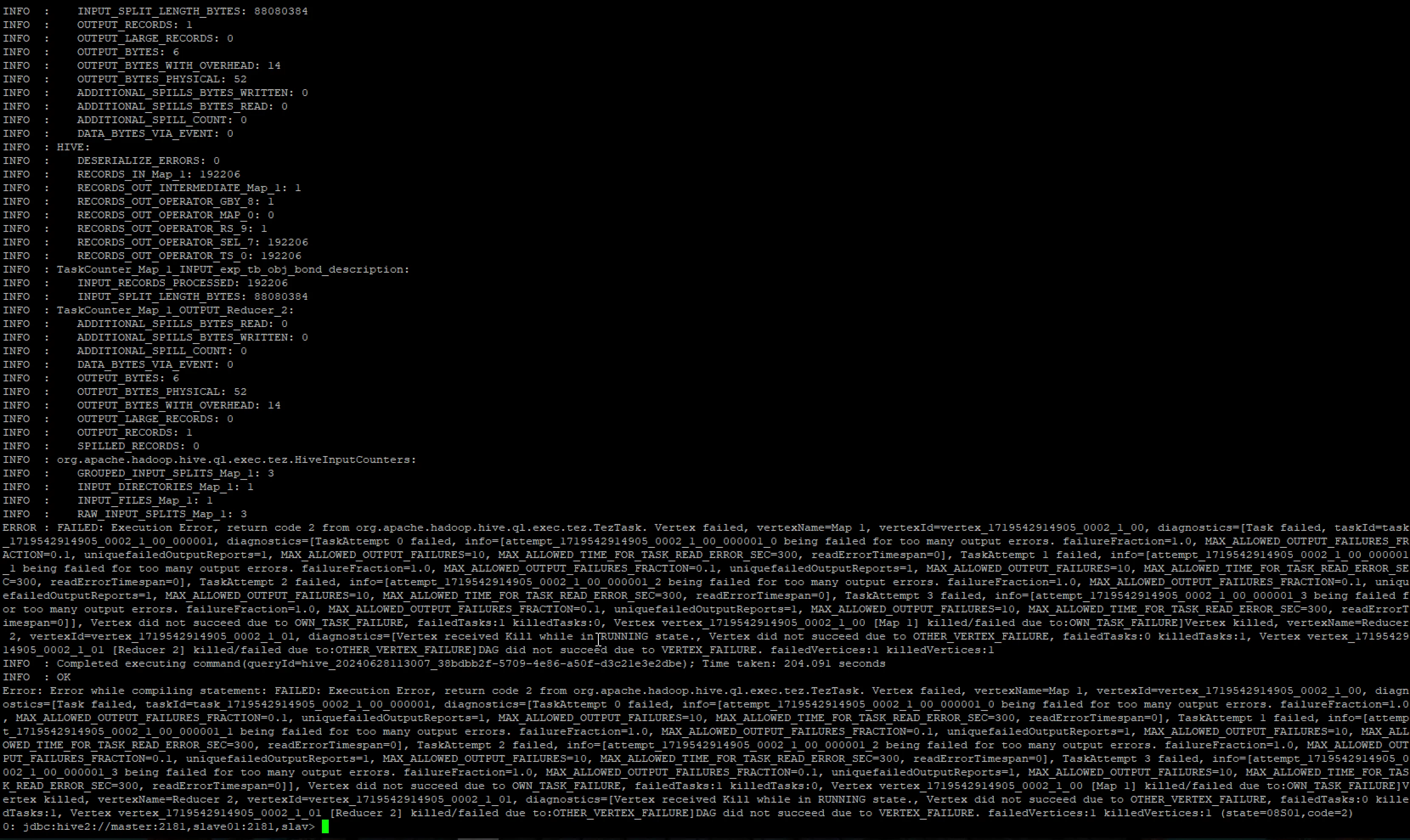

FAILED Execution Error return code 2 from org.apache.hadoop.hive.ql.exec.tez.Teztask …… being failed for too many output errors
After installing the CDH Hadoop cluster using cloudera manager, everything was fine, then adding kerberos verification using the cm interface, and then. hive performs some slightly more complex HQL. The following error will appear:

@zhuodongLi It will be difficult to find the cause of the issue from the error message in the screenshot. It will be best if you could create a support case with the YARN app log of application_1719542914905_0002, and HS2 logs covering the job run period.

@zhuodongLi  Upon reviewing the screenshot, it was observed that the child tasks have failed due to too many output errors . It is recommended to validate the failed attempts and determine if the blamed for read error is caused by the same nodemanager host. Please review the nodemanager logs for the corresponding node during the specific time period. If feasible, consider stopping the nodemanager on the host and then try rerunning the query. Additionally, please follow the instructions provided in the KB to remove the usercache directories from yarn. After completing these steps, re-run the query.
