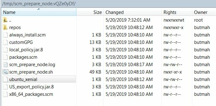

and this is what I have under "/tmp/scm_prepare_node.vQZe0yDf/" folder:
