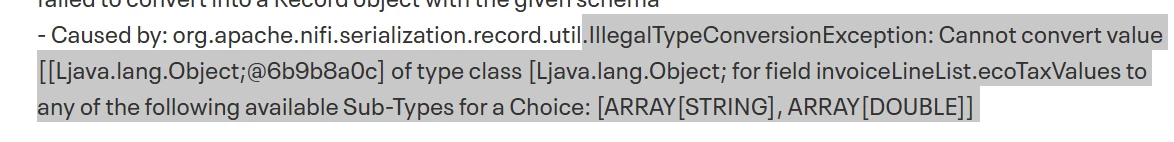

05:25:40 UTCERRORConsumeKafkaRecord_2_6[id=8f8pq352c-0rcb] Failed to parse message from Kafka using the configured Record Reader. Will route message as its own FlowFile to the 'parse.failure' relationship: org.apache.nifi.serialization.MalformedRecordException: Successfully parsed a JSON object from input but failed to convert into a Record object with the given schema
- Caused by: org.apache.nifi.serialization.record.util.IllegalTypeConversionException: Cannot convert value [[Ljava.lang.Object;@6b9b8a0c] of type class [Ljava.lang.Object; for field invoiceLineList.ecoTaxValues to any of the following available Sub-Types for a Choice: [ARRAY[STRING], ARRAY[DOUBLE]]

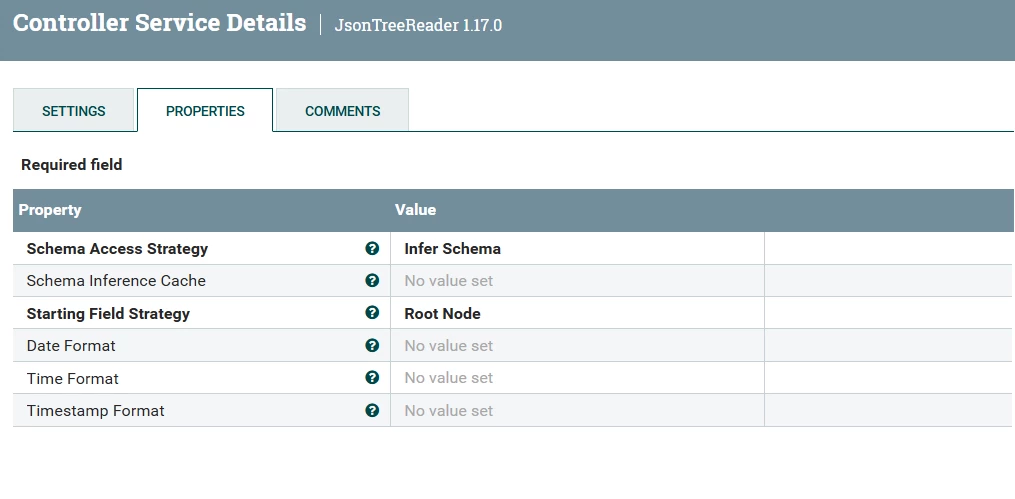

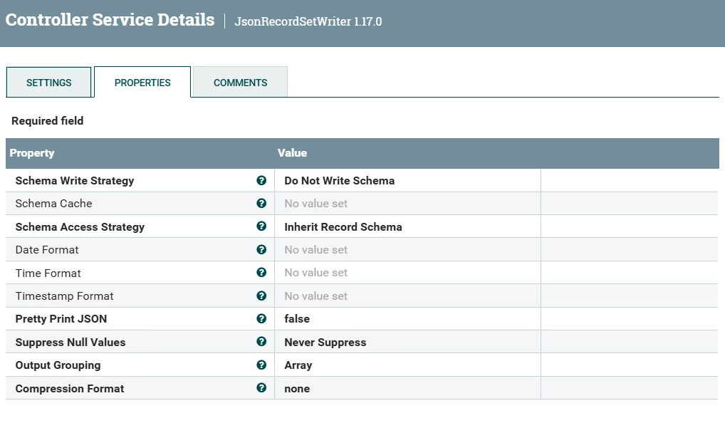

below are the json reader and writer configs.
JSONTreeReader:
JSONrecordSETWriter
i've tried changing reader to AVRO reader using "Confluent Content-Encoded Schema Reference" in the Avro Reader "Schema Access Strategy" field and keeping JsonRecordsetwriter same as above but still its not working,
Can anyone help me here?

here the file coming From Kafkatopic , so we are using consumeKafka as top processor, there itself we are having parsefailures. there is no schema from kafka also we are inferring that schema whatever file coming,
if you read the error
its taking this value ecoTaxValues , in payload i mentioned as
"OpenTX": [0.1,1.9,null,null]
values considering as double and null values considering as string, that's causing issue,
is there any way from json/avro reader from consumekafka we can skip this or ignoring these nulls, other than writing avro schema. why because we have so many fields in actual payload thats why, and if any new field addition from source i need to adpat the field again at our schema, so to avoid that i'm trying, Could you please help
