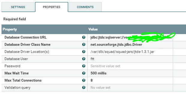

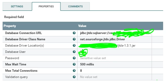

Connection parameter :
  • jdbc:jtds:sqlserver://${host}:${port};databaseName=xxxxxx;user=xxxxxx;password=xxxxxx
  • net.sourceforge.jtds.jdbc.Driver
  • /var/dlk/squad/squad-jars/jtds-1.3.1.jar

If it works in NiFi 1.5 and not in 1.9.2, then the DBCP libraries probably got updated to DBCP 2, where the latter will call isValid() on the connection if a validation query is not set (see https://sourceforge.net/p/jtds/discussion/104388/thread/bbfbcf24/). Have you set the Validation Query property on the DatabaseConnectionPool? If not, set it to "SELECT 1" and try again, hopefully that will work. If that doesn't, you can try adding a user-defined property called "validationQuery" and set it to "SELECT 1". That should add it as a property on the JDBC connection itself.

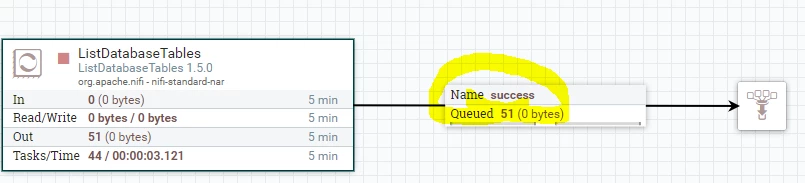

I have also tried with NIFI 1.5 and it works to.
