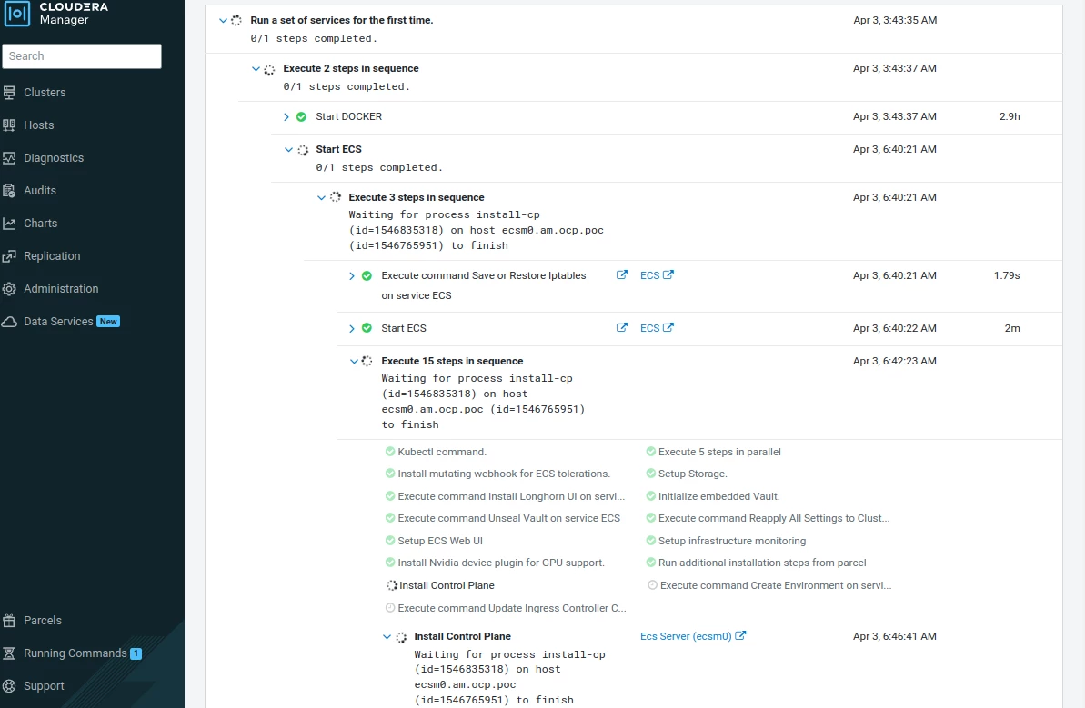

We are encountering a blockage during the installation of the Embedded Container Service (ECS).

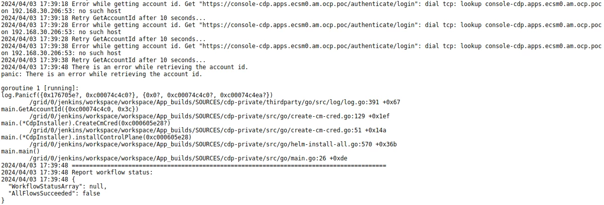

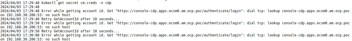

 Encountering the following error:
2024/04/03 17:29:48 kubectl get secret cm.creds -n cdp
2024/04/03 17:39:38 Error while getting account id. Get "https://console-cdp.apps.ecsm0.am.ocp.poc/authenticate/login": dial tcp: lookup console-cdp.apps.ecsm0.am.ocp.poc on 192.168.30.206:53: no such host
2024/04/03 17:39:38 Retry GetAccountId after 10 seconds...
2024/04/03 17:39:48 There is an error while retrieving the account id.
panic: There is an error while retrieving the account id.
goroutine 1 [running]:
log.Panicf({0x176705e?, 0xc00074c4c0?}, {0x0?, 0xc00074c4c0?, 0xc00074c4ea?})
/grid/0/jenkins/workspace/workspace/App_builds/SOURCES/cdp-private/thirdparty/go/src/log/log.go:391 +0x67
main.GetAccountId({0xc00074c4c0, 0x3c})
/grid/0/jenkins/workspace/workspace/App_builds/SOURCES/cdp-private/src/go/create-cm-cred.go:129 +0x1ef
main.(*CdpInstaller).CreateCmCred(0xc000605e28?)
/grid/0/jenkins/workspace/workspace/App_builds/SOURCES/cdp-private/src/go/create-cm-cred.go:51 +0x14a
main.(*CdpInstaller).installControlPlane(0xc000605e28)
/grid/0/jenkins/workspace/workspace/App_builds/SOURCES/cdp-private/src/go/helm-install-all.go:570 +0x36b
main.main()
/grid/0/jenkins/workspace/workspace/App_builds/SOURCES/cdp-private/src/go/main.go:26 +0xde
2024/04/03 17:39:48 =========================================================================================
2024/04/03 17:39:48 Report workflow status:
2024/04/03 17:39:48 {
"WorkflowStatusArray": null,
"AllFlowsSucceeded": false
Do we need to configure anything for DNS for Embedded Container Service (ECS)? Or do we need to configure anything in k8s pods?
