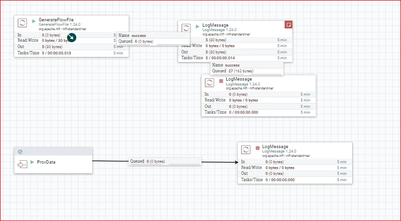

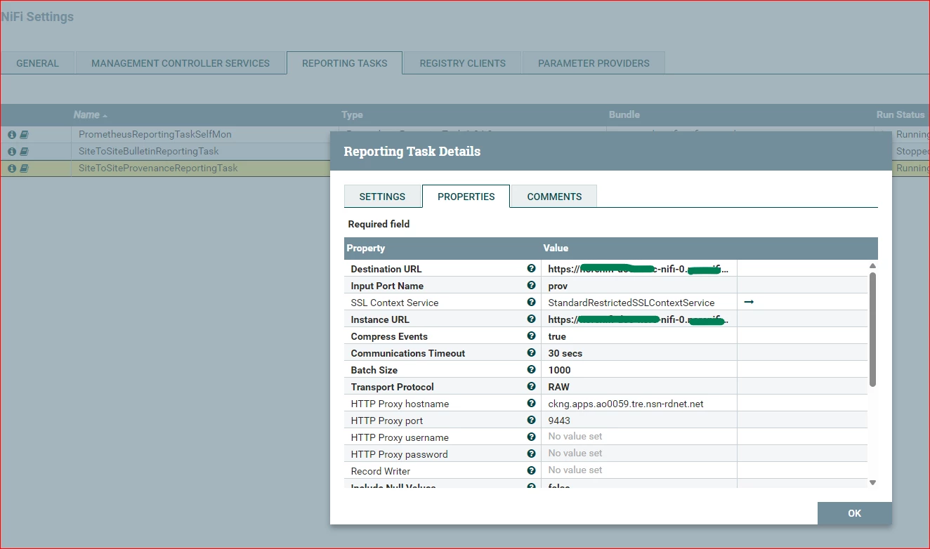

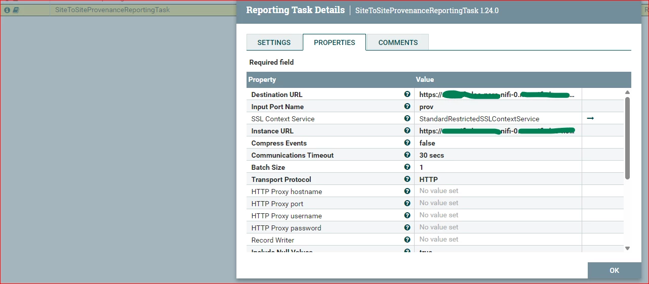

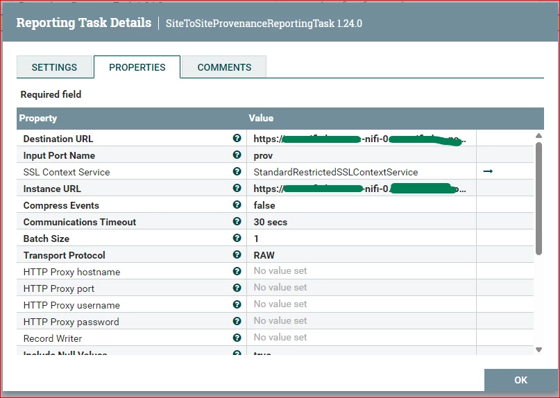

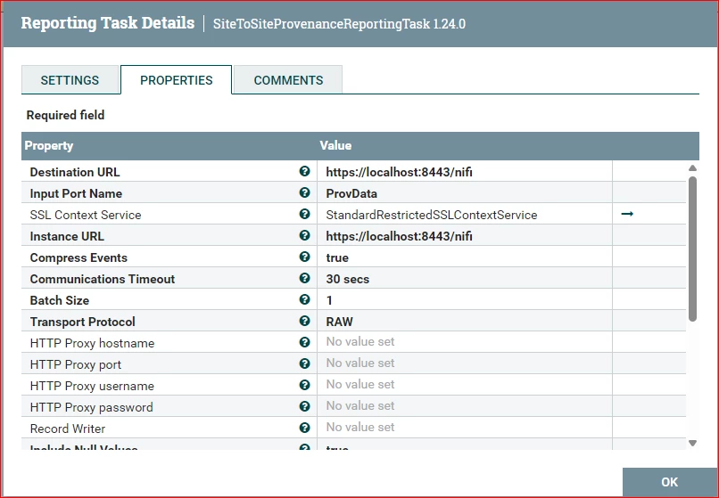

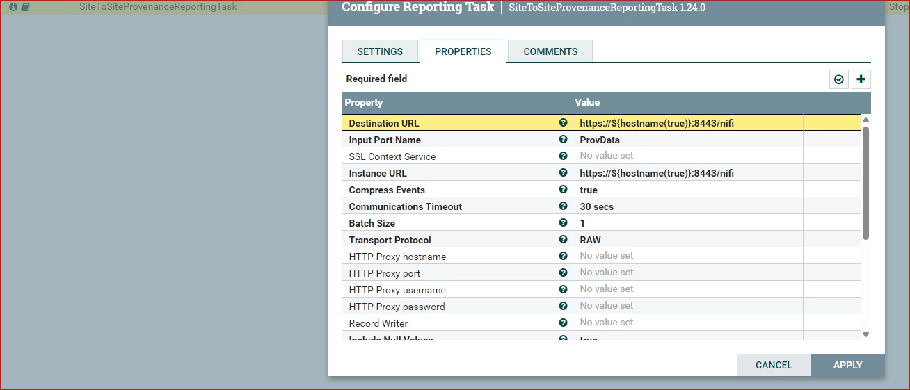

I have tried to configure the Site To Site Provenance Reporting task
Unfortunately, I am not able to get it working as i understand that it is not possible to configure Site to Site with security disabled while also running NiFi with HTTPS. Those settings go together.
Please advise on how to get this working. Many Thanks

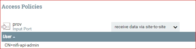

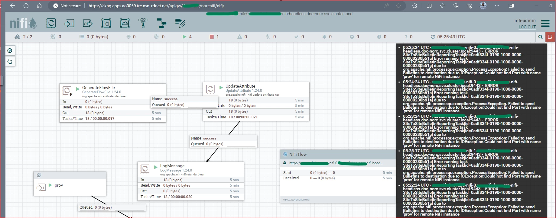

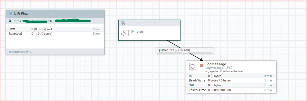

Hi @MattWho  ,
I have figured it out,

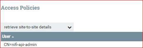

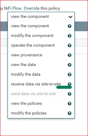

I set the access policy recieve data via site-to-site and its has now started to work.
i used an api call to set the value referring to this.
Access Policies | CDP Private Cloud (cloudera.com)
thank you so much for your help.
TO Summarize,
nifi.properties
bash-4.4$ cat conf/nifi.properties | grep remote
nifi.remote.input.host=nifi-0.nifi-headless.namespace.svc.cluster.local
nifi.remote.input.secure=true
nifi.remote.input.socket.port=10443
nifi.remote.input.http.enabled=true
nifi.remote.input.http.transaction.ttl=30 sec
nifi.remote.contents.cache.expiration=30 secs
in another pod
nifi.remote.input.host=nifi-1.nifi-headless.namespace.svc.cluster.local
nifi.web.https.host=nifi-0.nifi-headless.namespace.svc.cluster.local
nifi.web.https.port=9443
and respectively on another pod
nifi.web.https.host=nifi-1.nifi-headless.namespace.svc.cluster.local
set access policies
created reporting task
url set is podname.svc/https port
eg
https://nifi-0.nifi-headless.doc-norc.svc.cluster.local:9443/nifi
set management controller service
created an input port and remote group to send data

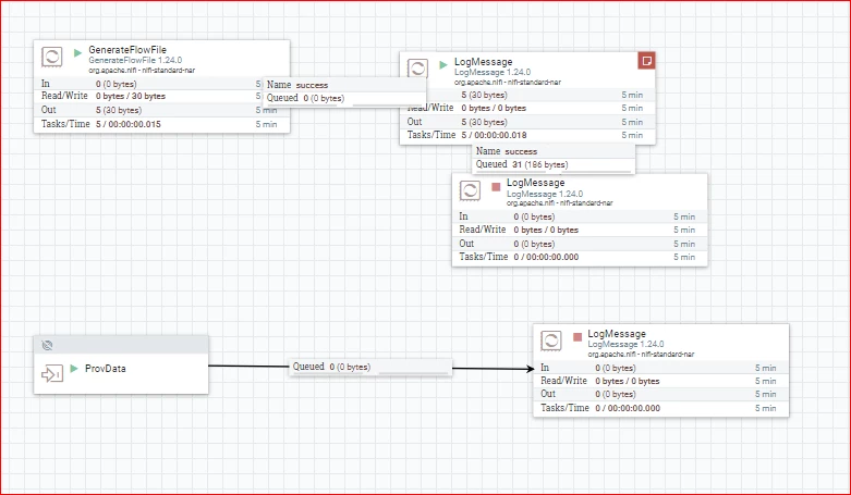

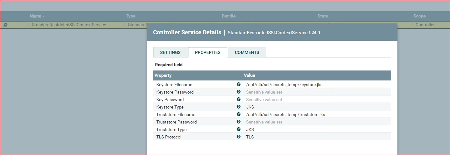

Hi @MattWho , Thank you for your response.
I am not trying to send data unsecured over network. Nifi running in my local is on https and i want it to stay it that way. But I would also like to fetch the Provenance data
I was trying to configure my nifi running on standalone mode based on what is described in the document
https://community.cloudera.com/t5/Community-Articles/Extracting-NiFi-Provenance-Data-using/ta-p/248469
I have changed the nifi.remote.input.http.enabled as true

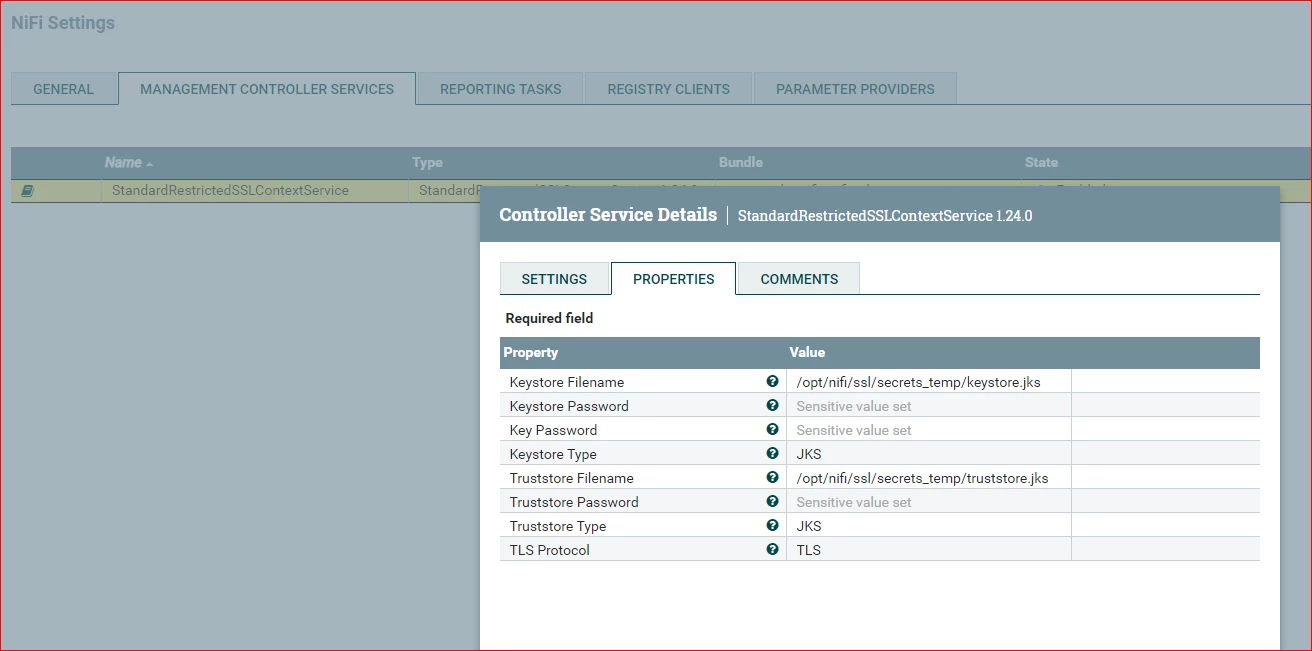

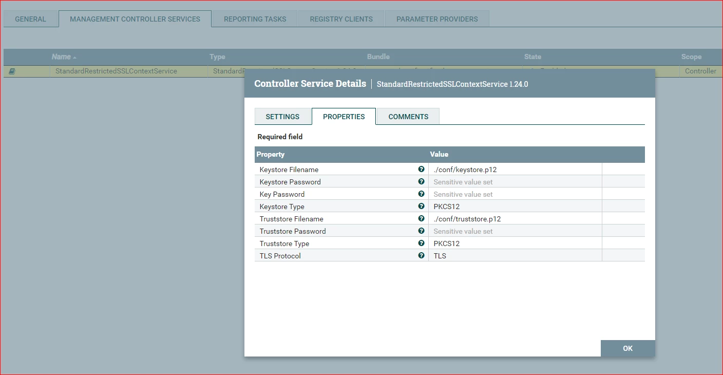

also tried adding StandardRestrictedSSLContextService
I have used the same value which is there in the truststore and keystore values in the  nifi.properties.
i can see logs like this
// Another save pending = false
2024-05-29 04:05:25,991 INFO [Timer-Driven Process Thread-7] o.a.n.c.s.TimerDrivenSchedulingAgent SiteToSiteProvenanceReportingTask[id=a971da9d-018f-1000-2b00-6824f28134d8] started.
2024-05-29 04:05:26,214 INFO [Flow Service Tasks Thread-1] o.a.nifi.controller.StandardFlowService Saved flow controller org.apache.nifi.controller.FlowController@c18025a // Another save pending = false
2024-05-29 04:05:36,347 INFO [pool-7-thread-1] o.a.n.c.r.WriteAheadFlowFileRepository Initiating checkpoint of FlowFile Repository
2024-05-29 04:05:36,348 INFO [pool-7-thread-1] o.a.n.c.r.WriteAheadFlowFileRepository Successfully checkpointed FlowFile Repository with 23 records in 0 milliseconds
2024-05-29 04:05:37,621 INFO [Timer-Driven Process Thread-6] o.a.n.p.store.WriteAheadStorePartition Successfully rolled over Event Writer for Provenance Event Store Partition[directory=./provenance_repository] due to MAX_TIME_REACHED. Event File was 17.76 KB and contained 10 events.
2024-05-29 04:05:56,348 INFO [pool-7-thread-1] o.a.n.c.r.WriteAheadFlowFileRepository Initiating checkpoint of FlowFile Repository
2024-05-29 04:05:56,352 INFO [pool-7-thread-1] o.a.n.wali.SequentialAccessWriteAheadLog Checkpointed Write-Ahead Log with 24 Records and 0 Swap Files in 3 milliseconds (Stop-the-world time = 1 milliseconds), max Transaction ID 48
But unfortunately, I do not see any data flowing into the input port
Translate

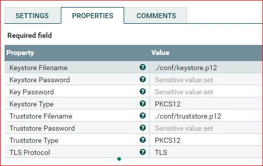

3. What keystore and truststore did you configure in the StandardRestrictedSSLContextService controller service?

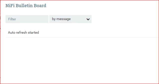

  • S2SProvenanceReportingTask is not producing any bulletin messagesscoutjohn_3-1717045386670.png
  • There are no errors in the user log.  I can see the StandardRestrictedSSLContextService and SiteToSiteProvenanceReportingTask started in the logs
2024-05-30 04:48:43,666 INFO [Timer-Driven Process Thread-9] o.a.n.c.s.StandardControllerServiceNode Successfully enabled StandardControllerServiceNode[service=SSLContextService[id=c27f79ba-018f-1000-ada5-343b2ba8f4e2], name=StandardRestrictedSSLContextService, active=true]
2024-05-30 04:49:07,157 INFO [Timer-Driven Process Thread-1] o.a.n.c.s.TimerDrivenSchedulingAgent SiteToSiteProvenanceReportingTask[id=a971da9d-018f-1000-2b00-6824f28134d8] started.​
  •  I am using the out of the box installation for NiFi , have not created the any other certificates. Have set the same values from the configurations that is used in nifi.security properties for configuring the StandardRestrictedSSLContextService.

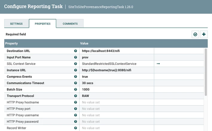

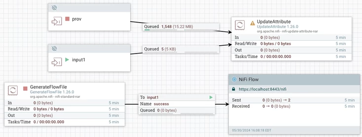

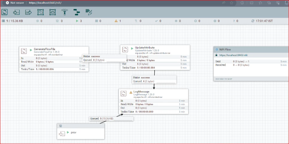

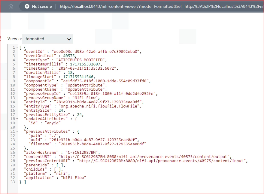

I installed an out-of-the-box Apache NiFi 1.26 using single user providers and the NiFi self-signed generated certificates.
I was able to send provenance events via the S2SProvenanceReportingTask successfully back to a Remote Input Port on the same NiFi with no issues.  So authorization is not an issue here.  I tested using both HTTP and RAW transport protocols successfully.
I also validated that S2S was working by setting up a Remote Process Group to send FlowFiles to a Remote Input port as well.  Here is the dataflow I setup:
You can see in the above that i generated some FlowFiles that were sent over S2S to the "Input1" remote port.  You can also see that my "prov" port received provenance events from the S2SProvenanceReportingTask.
My S2S setting from nifi.properties file:
# Site to Site properties
nifi.remote.input.host=localhost
nifi.remote.input.socket.port=10001

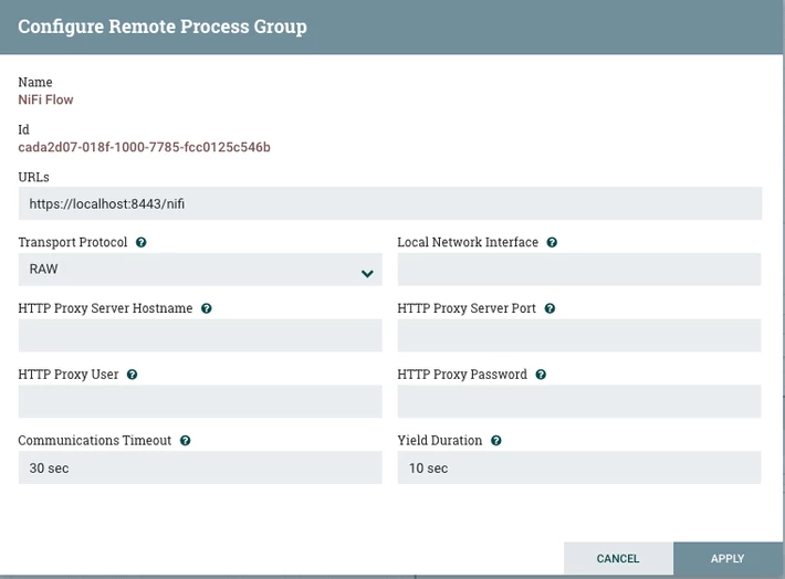

My Remote Process Group configuration:
Switching to "HTTP" transport protocol also worked.
S2SProvenanceReportingTask configuration:
While all of this worked correctly, sending provenance events via the S2SProvenanceReportingTask back to the same NiFi is not advisable.  It creates an endless loop of provenance events.  For every FlowFile received on the "prov" port another provenance "RECEIVE" event is created which then gets set by the reporting task.  This an infinite loop is created. You would certainly have difficulty related to authentication and authorization sending to another NiFi instance using the out-of-the-box keystore, truststore, and single user providers between two out of the box NiFi deployments.   But for testing purposes this works.

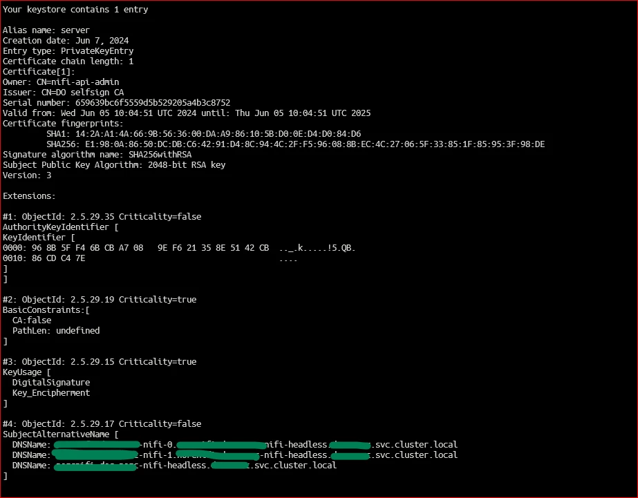

Now I see from your configuration you setup:
nifi.remote.input.host=cd8e8c899db6
Makes me wonder if that given hostname is:
  1. A SAN entry in the NiFi generated keystore certificate.  You could use keytool command to check.
keytool -v -list -keystore keystore.p12​
  • That hostname is resolvable and reachable by your NiFi instance.
Try changing that property to "localhost" see if it resolves your issue.

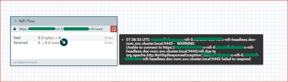

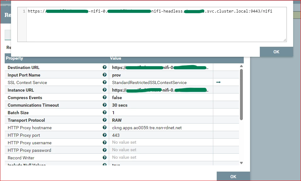

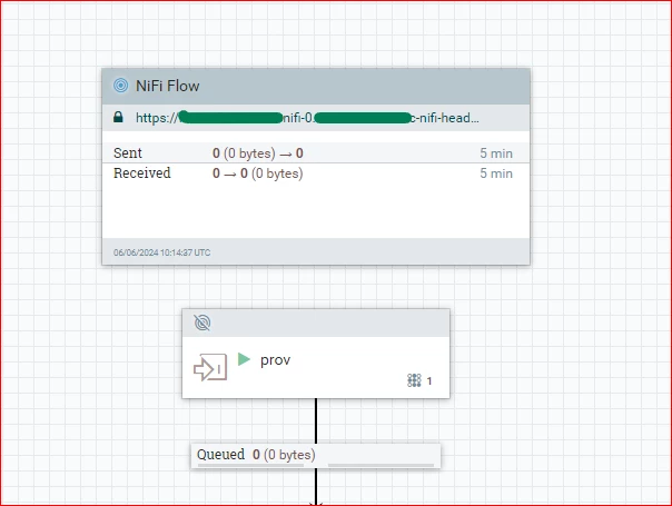

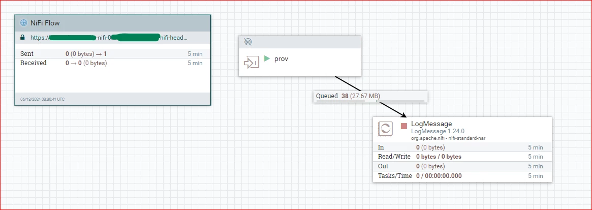

Jun 6, 2024 10:29 AM UTC
Hello @MattWho,
Sorry to come back on this topic.

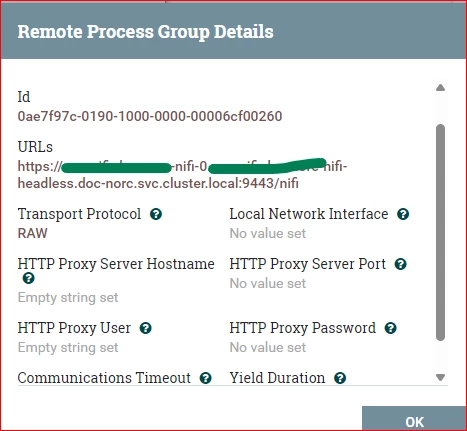

I am trying to implement the same S2S reporting task in a Kubernetes environment.
we have NiFi running in cluster mode. and we have 2 pods (it is usually 3, on embedded zookeeper. We're just working with 2 nodes for the time being)
The configuration for s2s is set as follows
I have tried with protocol RAW and HTTP
we have also given permission to the user in Retrieve site-to-site details
we have set the destination URL as https://<fullyqualifiedDNS>:portnumber
https://nifi-0.nifi-headless.namespace.svc.cluster.local:9443
the host is
nifi.remote.input.host=nifi-0.nifi-headless.doc-norc.svc.cluster.local
port number we're using is
but the events are not coming into the port
logs says
the authentication is successful
{"type":"log", "facility":"25", "host":"ao0059-cjts5-worker-0-lqm8m", "level":"INFO", "event-type":"N_USER_OPER", "systemid":"nifi","neid":"706546b360714e94b74591ca351b0655", "system":"nifi-0", "time":"2024-06-06T12:06:13.189Z" ,"timezone":"UTC", "log":"[NiFi Web Server-1830] o.a.n.w.s.NiFiAuthenticationFilter Authentication Started 10.255.15.73 [CN=nifi-api-admin] GET https://nifi-0.nifi-headless.namespace.svc.cluster.local:9443/nifi-api/site-to-site"}
{"type":"log", "facility":"25", "host":"ao0059-cjts5-worker-0-lqm8m", "level":"INFO", "event-type":"N_USER_OPER", "systemid":"nifi","neid":"706546b360714e94b74591ca351b0655", "system":"nifi-0", "time":"2024-06-06T09:51:41.644Z" ,"timezone":"UTC", "log":"[NiFi Web Server-854] o.a.n.w.s.NiFiAuthenticationFilter Authentication Success [CN=nifi-api-admin] 10.255.15.73 GET https://nifi-0.nifi-headless.namespace.svc.cluster.local:9443/nifi-api/site-to-site"}
The log also says
No events to send due to 'events' being null or empty.
{"type":"log", "host":"ao0059-cjts5-worker-0-lqm8m", "level":"DEBUG", "event-type":"N_USER_OPER", "systemid":"nifi","neid":"706546b360714e94b74591ca351b0655", "system":"nifi-0", "time":"2024-06-06T10:05:39.499Z" ,"timezone":"UTC", "log":"[Timer-Driven Process Thread-8] o.a.n.r.SiteToSiteProvenanceReportingTask SiteToSiteProvenanceReportingTask[id=ecacc388-018f-1000-ffff-ffff8c5138a7] Returning LOCAL State: StandardStateMap[version=-1, values={}]"}
{"type":"log", "host":"ao0059-cjts5-worker-0-lqm8m", "level":"DEBUG", "event-type":"N_USER_OPER", "systemid":"nifi","neid":"706546b360714e94b74591ca351b0655", "system":"nifi-0", "time":"2024-06-06T10:05:39.499Z" ,"timezone":"UTC", "log":"[Timer-Driven Process Thread-8] o.a.n.r.SiteToSiteProvenanceReportingTask SiteToSiteProvenanceReportingTask[id=ecacc388-018f-1000-ffff-ffff8c5138a7] No events to send due to 'events' being null or empty."}
{"type":"log", "host":"ao0059-cjts5-worker-0-lqm8m", "level":"DEBUG", "event-type":"N_USER_OPER", "systemid":"nifi","neid":"706546b360714e94b74591ca351b0655", "system":"nifi-0", "time":"2024-06-06T10:05:44.501Z" ,"timezone":"UTC", "log":"[Timer-Driven Process Thread-4] o.a.n.r.SiteToSiteProvenanceReportingTask SiteToSiteProvenanceReportingTask[id=ecacc388-018f-1000-ffff-ffff8c5138a7] Returning LOCAL State: StandardStateMap[version=-1, values={}]"}
{"type":"log", "host":"ao0059-cjts5-worker-0-lqm8m", "level":"DEBUG", "event-type":"N_USER_OPER", "systemid":"nifi","neid":"706546b360714e94b74591ca351b0655", "system":"nifi-0", "time":"2024-06-06T10:05:44.502Z" ,"timezone":"UTC", "log":"[Timer-Driven Process Thread-4] o.a.n.r.SiteToSiteProvenanceReportingTask SiteToSiteProvenanceReportingTask[id=ecacc388-018f-1000-ffff-ffff8c5138a7] No events to send due to 'events' being null or empty."}

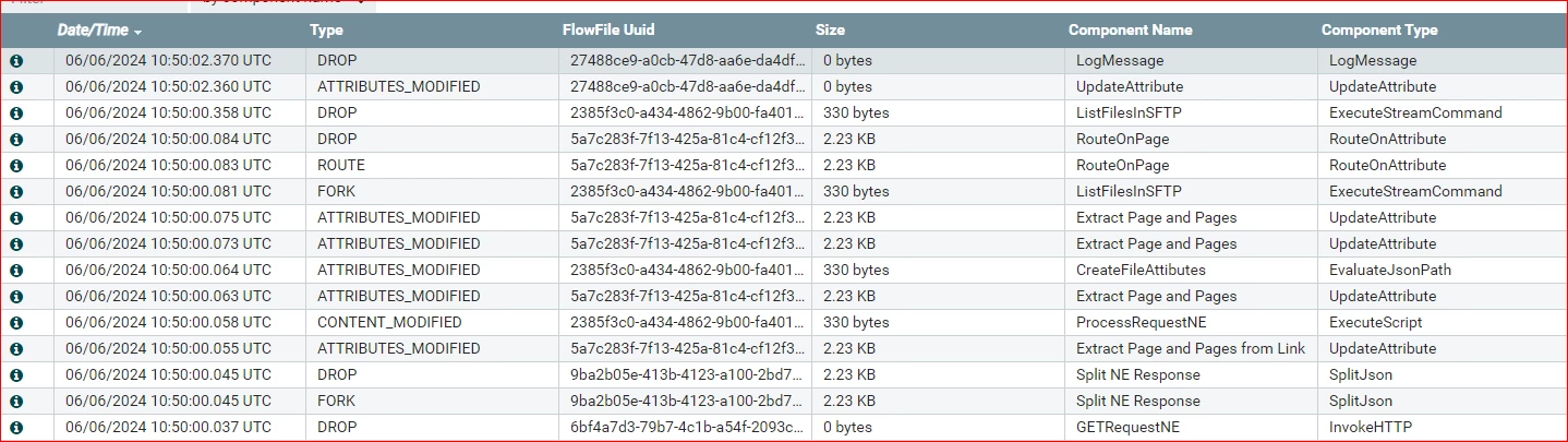

there are entries on data provenance
there was also an issue where the task complained that the input port is not available
{"type":"log", "host":"ao0059-cjts5-worker-0-z5b82", "level":"ERROR", "event-type":"N_USER_OPER", "systemid":"nifi","neid":"174577b6145e4b87a86e5d9c397c8f75", "system":"nifi-0", "time":"2024-06-04T11:20:41.566Z" ,"timezone":"UTC", "log":"[Timer-Driven Process Thread-3] o.a.n.r.SiteToSiteProvenanceReportingTask SiteToSiteProvenanceReportingTask[id=e2e547c5-018f-1000-0000-00004876faee] Error running task SiteToSiteProvenanceReportingTask[id=e2e547c5-018f-1000-0000-00004876faee] due to org.apache.nifi.processor.exception.ProcessException: Failed to send Provenance Events to destination due to IOException:Could not find Port with name 'prov' for remote NiFi instance"}
but now this is not coming up, though we have not made any changes on it.
there are no other errors in the logs, have enabled debug to
org.apache.nifi.reporting

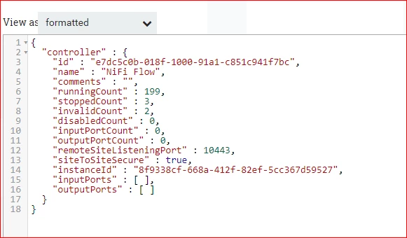

I tried the nifi-api
https://nifi-0.nifi-headless.namespace.svc.cluster.local:9443/nifi-api/site-to-site/peers
and
https://nifi-0.nifi-headless.namespace.svc.cluster.local:9443/nifi-api/nifi-api/site-to-site
Can you please help us with this? Thank you for your time

@scoutjohn
I don't have a Kubernetes env to mess around with currently.
But a couple things i see from your response:
  1. Your urls appear to be missing the /nifi on the end.
  2. What value is set for "nifi.web.http.host" in the nifi.properties on each instance of your K8s cluster?
  3. Is "nifi-0.nifi-headless.namespace.svc.cluster.local" being used in S2SProvenanceReporting task resolvable on the NiFi host to a valid IP address that is reachable between nodes?
  4. Are port available and unused on both hosts?
  5. Configuration match on both hosts in nifi.properties (with exception of host specific properties)?
  6. PrivateKey certificates used by hosts contain proper EKUs and SAN entries needed?
  • I have tried with /nifi also in the URLs, but unfortunately the data is not coming in
  • we're using https, there is no value set for http . instead we have https
and respectively on other pod
we also have proxy host
nifi.web.proxy.context.path=/apigw/namespace/nifi
nifi.web.proxy.host=ckng.apps.ao0059.tre.nsn-rdnet.net:443, nifi-headless.namespace.svc.cluster.local:9443
which is same for both the pods
  • Yes the host name is reachable

  • yes , private key used have the proper EKUs and SAN entries

Hi @MattWho ,
I tried a similar attempt with SiteToSiteBulletinReportingTask
it complains that there is no port.

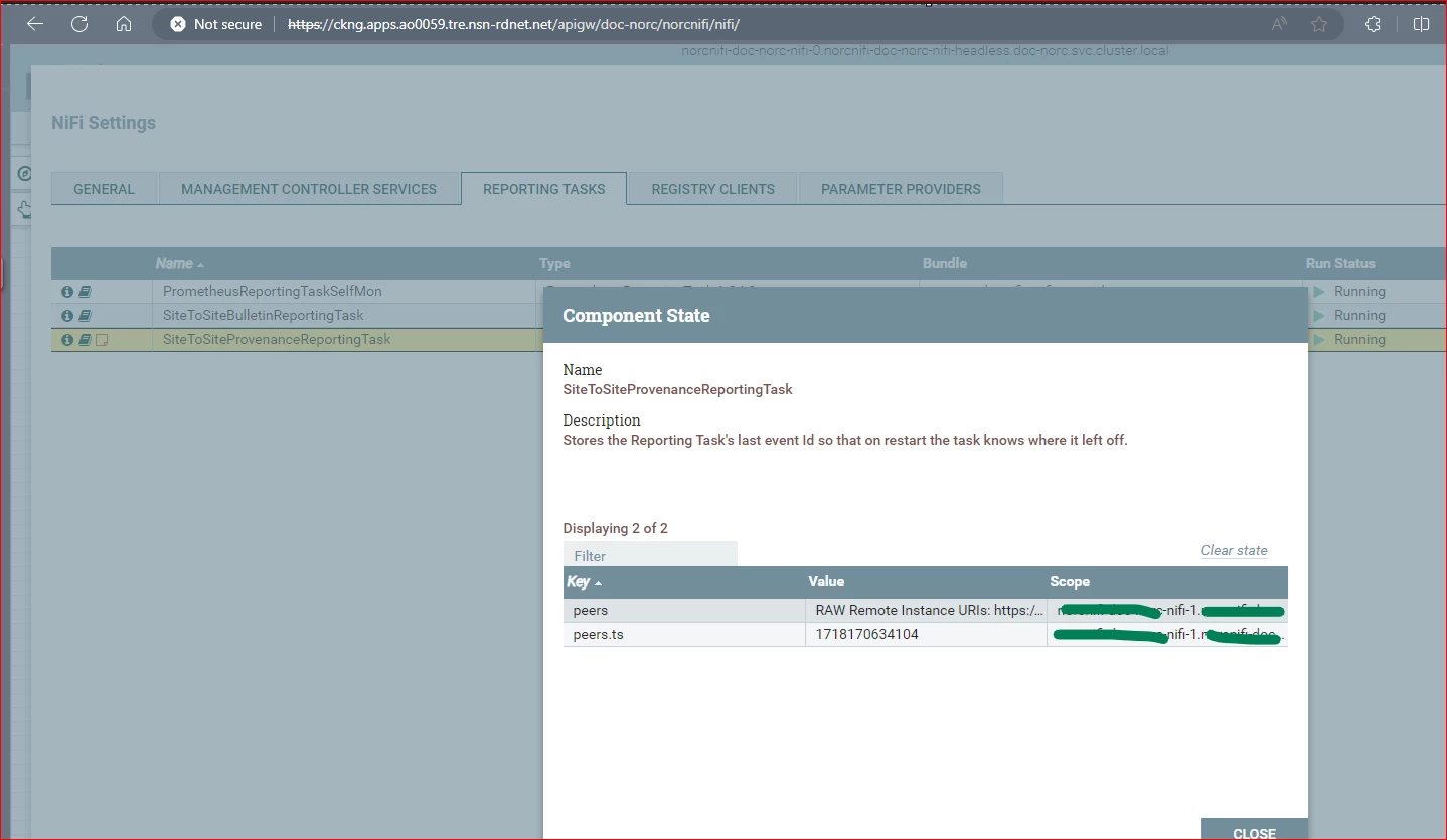

and in the site to site component state it has
o.a.n.w.s.NiFiAuthenticationFilter Authentication Success [CN=nifi-api-admin] 10.255.14.191 GET https://nifi-0.nifi-headless.doc-norc.svc.cluster.local:9443/nifi-api/site-to-site
o.a.n.r.SiteToSiteBulletinReportingTask SiteToSiteBulletinReportingTask[id=0adf334f-0190-1000-0000-00000230b61a] Error running task SiteToSiteBulletinReportingTask[id=0adf334f-0190-1000-0000-00000230b61a] due to org.apache.nifi.processor.exception.ProcessException: Failed to send Bulletins to destination due to IOException:Could not find Port with name 'prov' for remote NiFi instance"
o.a.n.remote.StandardRemoteProcessGroup Unable to connect to RemoteProcessGroup[https://nifi-0.nifi-headless.doc-norc.svc.cluster.local:9443/nifi] due to org.apache.http.NoHttpResponseException: nifi-0.nifi-headless.doc-norc.svc.cluster.local:9443 failed to respond
 please let me know if you can help here.
thank you
set access policies
eg
