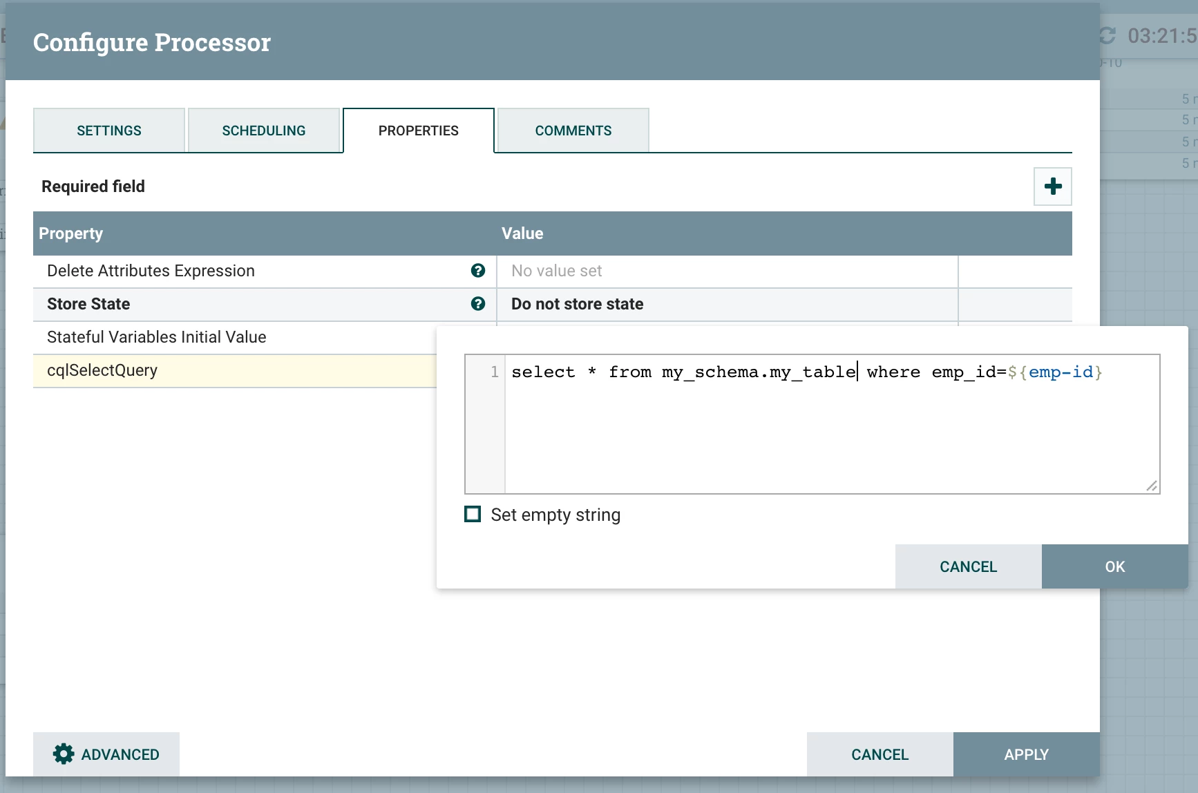

Hi @VINODTV ,
 Nifi input/output ports are for connecting processor groups.
You can pass your attribute (emp id) from Jenkins as header or http request body.
If you receive your parameter value to NiFi as header then you can just use one UpdateAttribute to prepare your query with parameter (header) received in header.

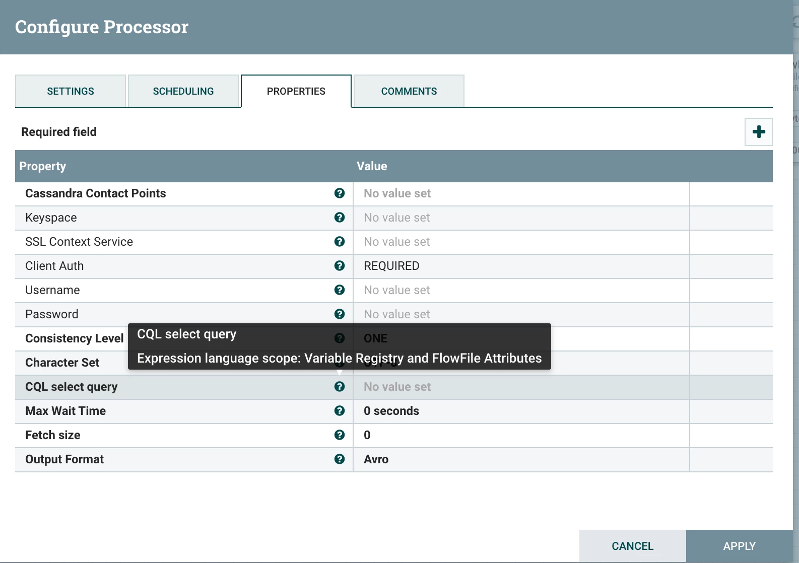

Then use above prepared attribute 'cqlSelectQuery' as 'CQL select query' in QueryCassandra processor.
