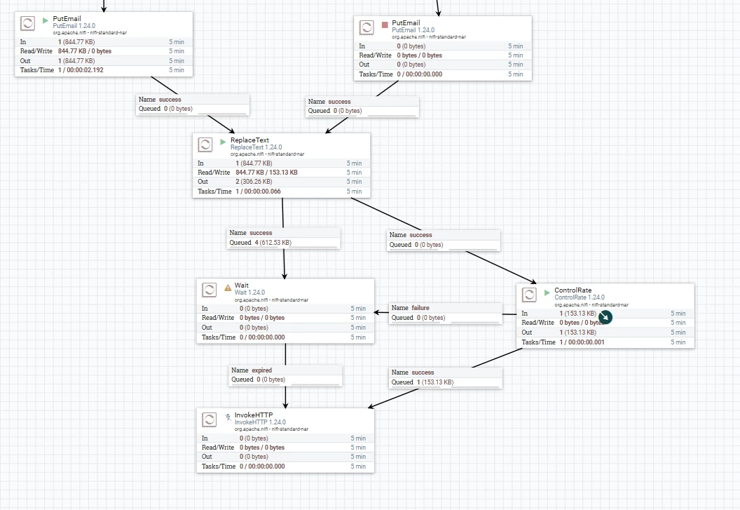

Sure, here is the flow itself:

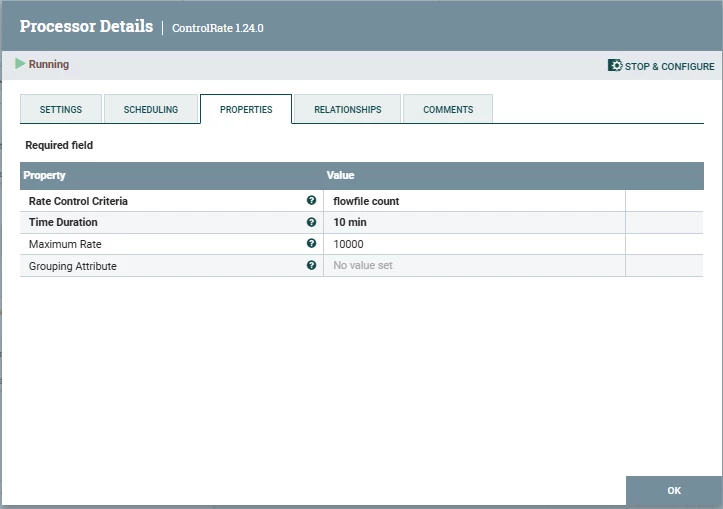

Here is config of controlRate processor
I have also tried data rate, but the moment the fileFlow arrives at that processor, it immediately goes to queue for invokeHTTP.

Couple of things I noticed:
1- You dont need the Wait processor as I said it doesnt apply in this case. Wait & Notify processor work together please review info about this here. You can remove the Wait processor and replace with the ControlRate processor.
2- In the Control Rate set the Max Rate = 1 . This will allow only one flowfile entry per specified Time Duration.  The first flowfile passed after adding this processor or changing its setting will go through without waiting but any subsequent flowfiles will wait. Each passed flowfile will reset the time so the next flowfile will wait the full Time Duration.
3- Why do you have the InvokeHttp disabled?! If its disabled then nothing will run coming from the ControlRate processor.

Dec 5, 2024 1:52 PM UTC
Hi Samsal,
I added Wait processor there for debugging if needed, and invokeHTTP is disabled because it would hamper my testing due to the fact the initial trigger is the status change (So status changes to Started, fileflow is generated, then at the end it changes the status to ready).
As stopped processors are affected by starting/stopping the entire process group, I found it much easier to disable it after I already confirmed it worked the way I wanted.
Yeah, then I am in a bit of a pickle, I would like to utilize either total life duration of a fileFlow or when it went through last processor.
The total duration is fine as the whole cycle lasts few seconds
