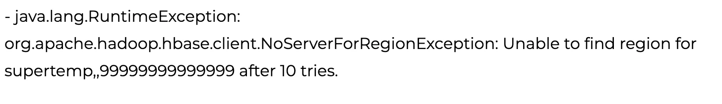

We are trying to execute a MapReduce job to write to HBASE using OOZIE Workflow.
We have implemented Kerberos in our Cluster and that is when these issues started....
The Job is failing after 10 minutes with an error:

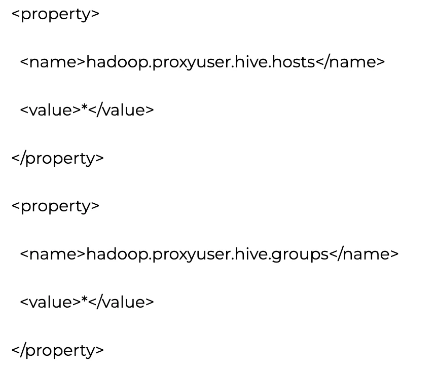

We had a similar issue with beeline not able to run HBASE Commands and the solution was -
I think the issue is that HBase does not allow hive to impersonate users.  So you'll need to setup hive as a proxy user in HBase.  Can you try the following:
- Go to the HDFS service configuration in CM.
- Go to Service-Wide->Advanced and add the following to "Cluster-wide Configuration Safety Valve for core-site.xml":

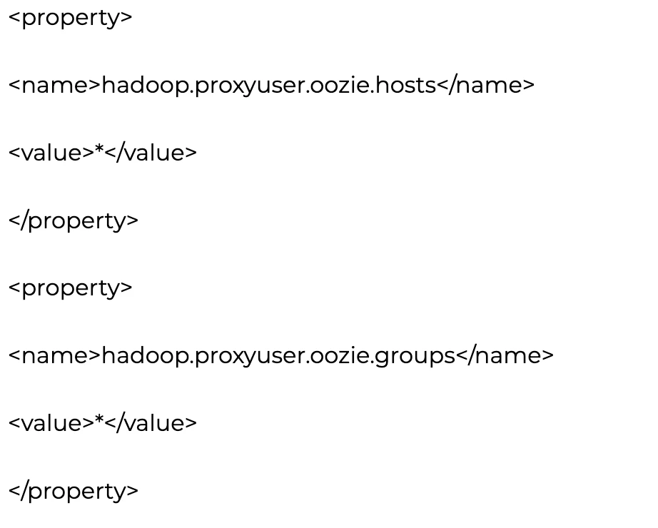

I have added similar entry for OOZIE - HDFS Service-Wide Advanced properties and add the following to Cluster-wide ConfigurationSafety Valve for core-site.xml

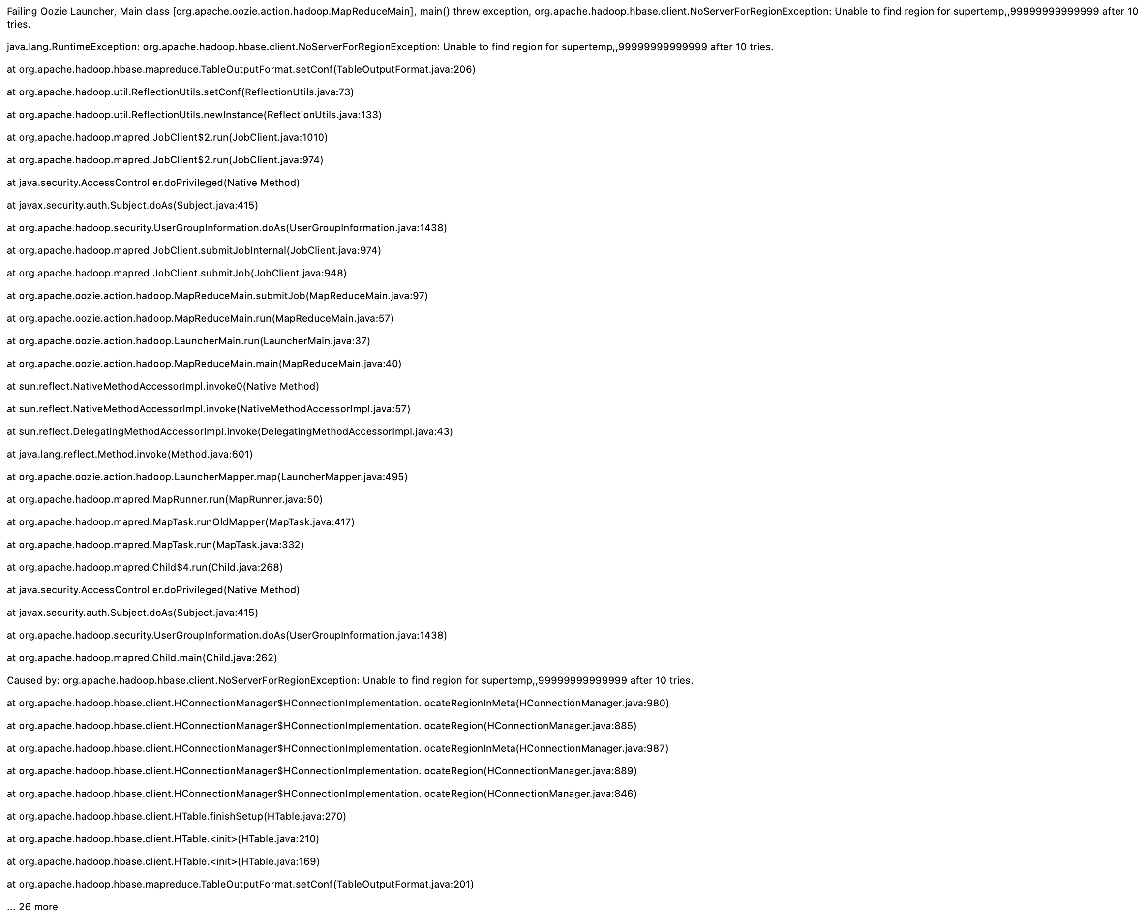

Here is what i have in the logs -
Oozie Launcher failed, finishing Hadoop job gracefully
