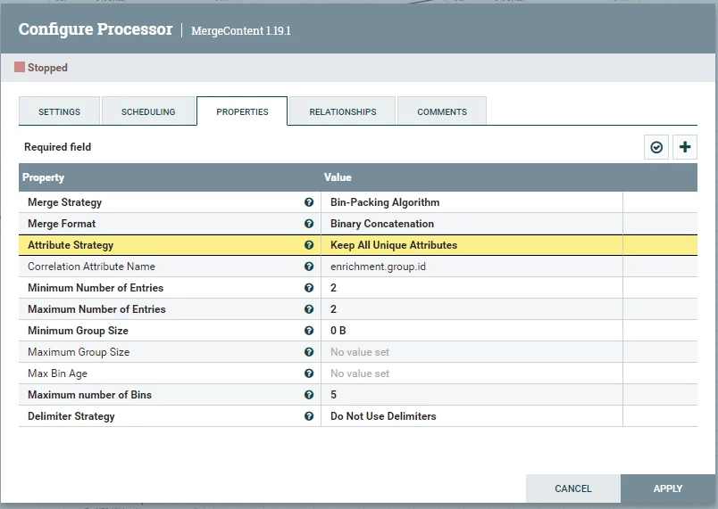

Another approach might be to fork the flowfiles again with ForkEnrichment. Then I parse the content of the enrichment flowfiles as attributes, empty the content, merge them with MergeContent Processor assigning the value of Correlation Attribute Name to enrichment.group.id which should be the same for two flowfiles each in the relationship enrichment and original going out of ForkEnrichment. This won't work as expected. Any hints?
It is hard to explain my problem and what I already have tried in simple word. But actually I want to merge two flowfiles that have been forked at some point. I want to keep the content of the relationship original and add attributes from the relationship enrichment. Is this really such a edgy use case that I can't find any approaches for this? I'm desperate.
