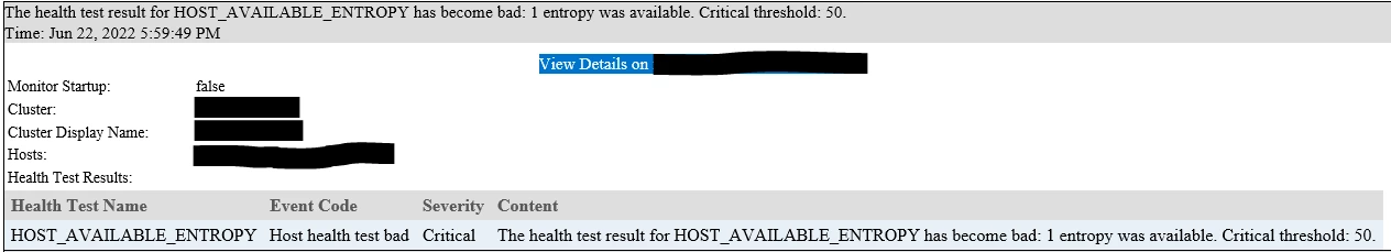

We are seeing a frequent entropy issue in our customer cluster as shown below.
/proc/sys/kernel/random/entropy_avail returns 3754. We also installed the rng-tools in all the nodes and the service rngd is also running. After checking the document https://docs.cloudera.com/cdp-private-cloud-base/7.1.6/installation/topics/cdpdc-data-at-rest-encryption-requirements.html#pnavId1 we can see the ExecStart looks as follows
ExecStart=/sbin/rngd -f -r /dev/urandom
However, our ExecStart is the default one and looks as follows
can you please share if updating the ExecStart will solve the issue?

At the time of the alert, if you run a cat /proc/sys/kernel/random/entropy_avail on that exact host, what values are you getting?

Hello @araujo, by the time I logged in to the node to check the entropy_avail value it became good, this issue seems to resolve fast as from the Cloudera Alert mail I can see good status within the next minute after this issue occurred. Also, from the screenshot attached you can the value was 1.
