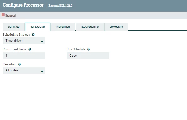

@SAMSAL I tried the above but it spits out multiple flowfiles.I just need the count(1) value

I want the executeSQL to run just once and also if the count>0 then run another executeSQL to fetch records from another table

It seems like the ExecuteSQL is being executed continuously because its scheduled to run as such based on the Run Schedule. You have to set up the Run Schedule to the needed frequency by selecting CORN Driven Scheduling Strategy and set the CRON Time accordingly in the Run Schedule property.

@SAMSAL  - it worked ! Thanks
