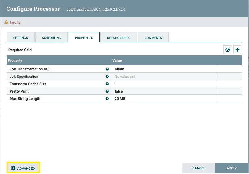

NiFi expects the Jolt specification to be provided as an array of objects if it's set chain. This is typical when using JoltTransformJSON because it supports multiple transformations chained together.

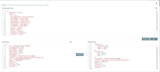

Also, if you click on your JoltTransformJSON and click on the advanced option -
It will bring up a nice Jolt Spec tester for you that is consistent with how NiFi will handle the transformation -
Solution is just wrapping it in an array.
