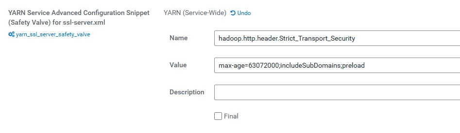

2. For MapReduce -> I enabled HTTS on MapReduce Shuffle with:
but I still don't understand where I should add the HSTS header configuration. In ssl-server.xml? How would the config look like? Like in the image bellow?
I tested with what I stated in the images above and HSTS header is not present.

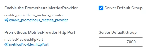

Sorry, just an update regarding port 7000. From my debug on the server, this port is opened by a java process running the zookeeper-server process. This is why I mentioned it here.
Also, the configuration in the zookeeper service -> Server -> metrics
Thanks!

@Raufshaikh @teo123 @dimi_yu -
Starting with CDP 7.1.9, Cloudera rebased ZooKeeper to version 3.8 (3.8.1.7.1.9.0-387). Beginning with ZooKeeper version 3.6.0, a new a new monitoring feature (New Metrics System ) was introduced where you can enable the Prometheus MetricsProvider [0]. By default, the Port is set to the default port number of 7000 (which is configurable by setting "metricsProvider.httpPort"). While Prometheus itself does not require the HTTP TRACE method for normal operation, this behaviour is a result of the upstream ZooKeeper implementation ZOOKEEPER-3731.
We at Cloudera, actively working internally to disable HTTP TRACE in the Prometheus MetricsProvider endpoint in an upcoming CDP release as part of our continued focus on security hardening.
Which will be fixed in CDP 7.3.2, released in early 2026.
As a workaround for now, you can just uncheck the "Enable the Prometheus MetricsProvider" option to disable the port for Prometheus metrics.
[0] = https://zookeeper.apache.org/doc/r3.9.3/zookeeperAdmin.html#:~:text=metricsProvider.httpPort
