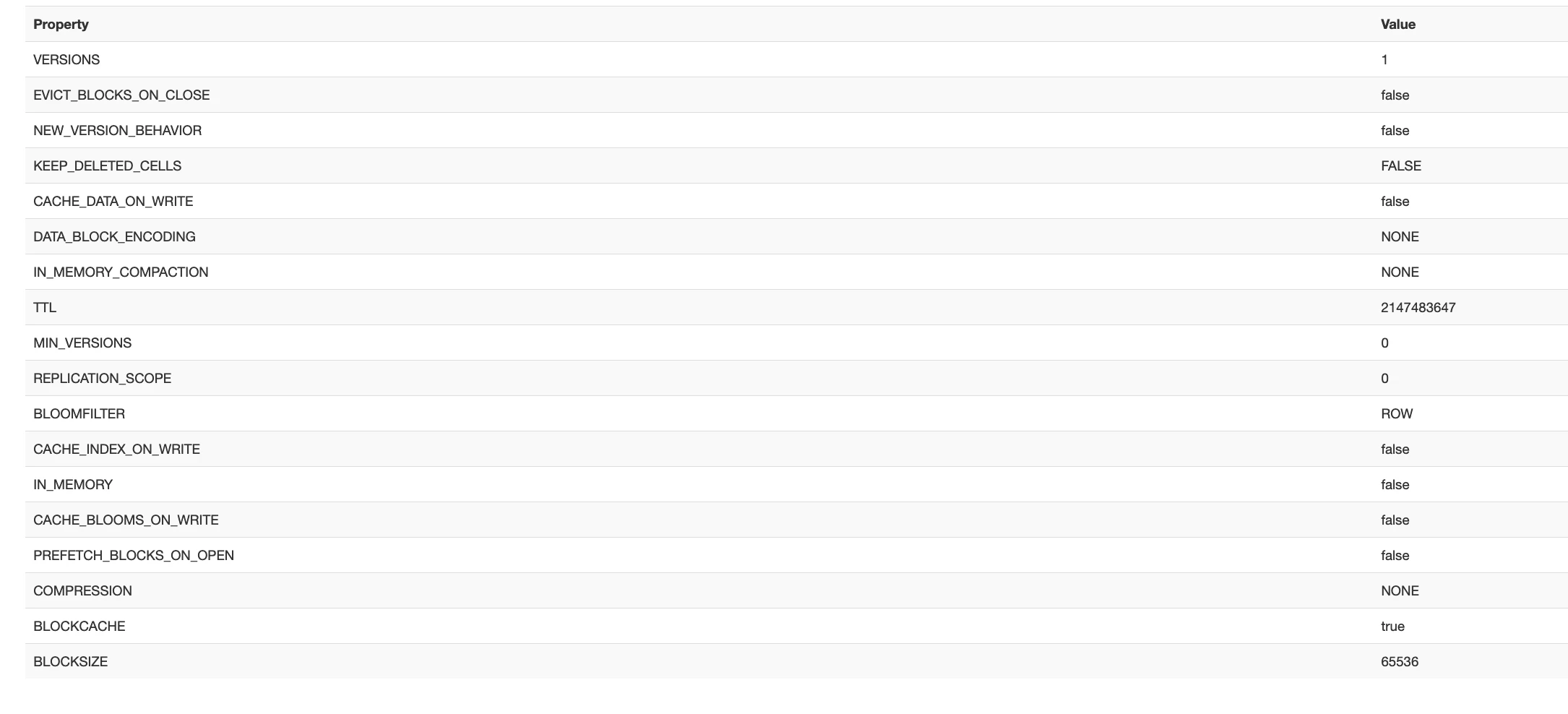

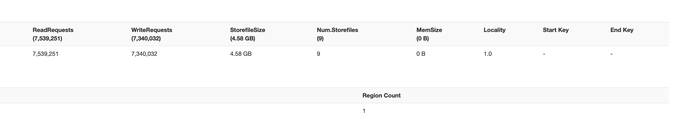

Hello @rki_ ,
Thank you very much for your replay
I didn't specify any table for this test, so it should default to TestTable

Oct 29, 2022 7:04 AM UTC
You can also try to split the table at the time of creation or split it now so that not all requests go to the same Region server which thereby creates a hotspot and might be a bottleneck.
