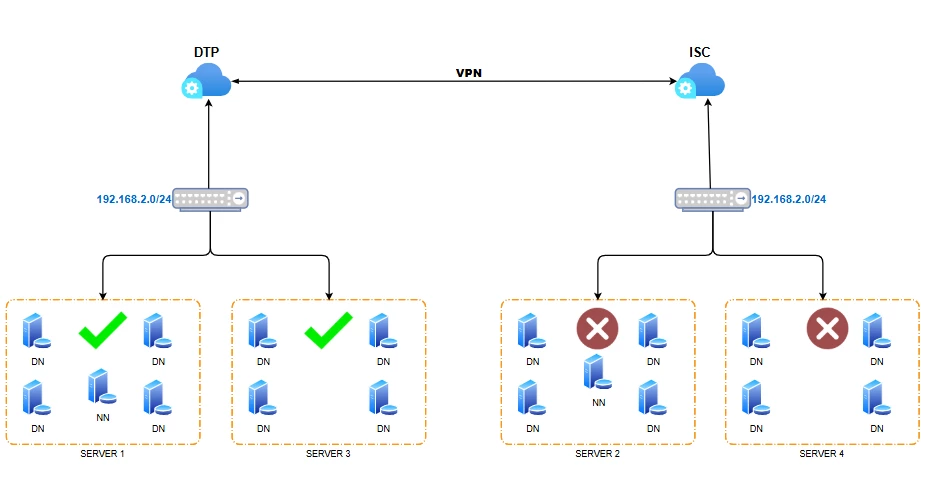

I have 2 NameNode (HA), 16 DataNode, and 5 JournalNode. When I tried to shutdown 8 DataNode, 2 NameNode was down and not running.
Please give me a solution for my case. How many journal nodes are needed to be able to handle a minimum of 8 DataNodes that are down or have a greater than 50% failure rate?

➤It appears your cluster is experiencing a Quorum Failure, where the critical metadata services (NameNode, JournalNodes, and ZooKeeper) are losing the ability to maintain a majority when one Data Center (DC) goes offline.
➤ Analyzing Your Failure
In a High Availability (HA) setup, the NameNodes rely on a "Quorum" of JournalNodes (JN) and ZooKeeper (ZK) nodes to stay alive. If you have 5 JNs, you must have at least 3 running for either NameNode to function.
Based on your diagram:
The Problem: If you split your 5 JournalNodes evenly (e.g., 2 in DC1 and 3 in DC2), and the DC with 3 JNs goes down, the remaining 2 JNs cannot form a quorum. This causes both NameNodes to shut down immediately to prevent data corruption ("Split Brain").
DataNodes vs. NameNodes: In HDFS, the number of DataNodes (DN) that fail has no direct impact on whether the NameNode stays "Up" or "Down." You could lose 15 out of 16 DataNodes, and the NameNode should still stay active. The fact that your NameNodes are crashing when 8 DNs (one full server/DC) go down proves that your Quorum nodes (JN/ZK) are failing, not the DataNodes.

This is my layout of 2 Data Centers, each data center has 1 NameNode and 8 datanodes, in my case when 1 DC dies, HA continues to run

Please Help me @Shelton , what is the maximum datanode failure percentage? I tried to install 11 JN, and 11 ZK, but it didn't work, out of 16 nodes only 7 datanodes can fail active or dead, I need 8 datanodes dead but HA still running
