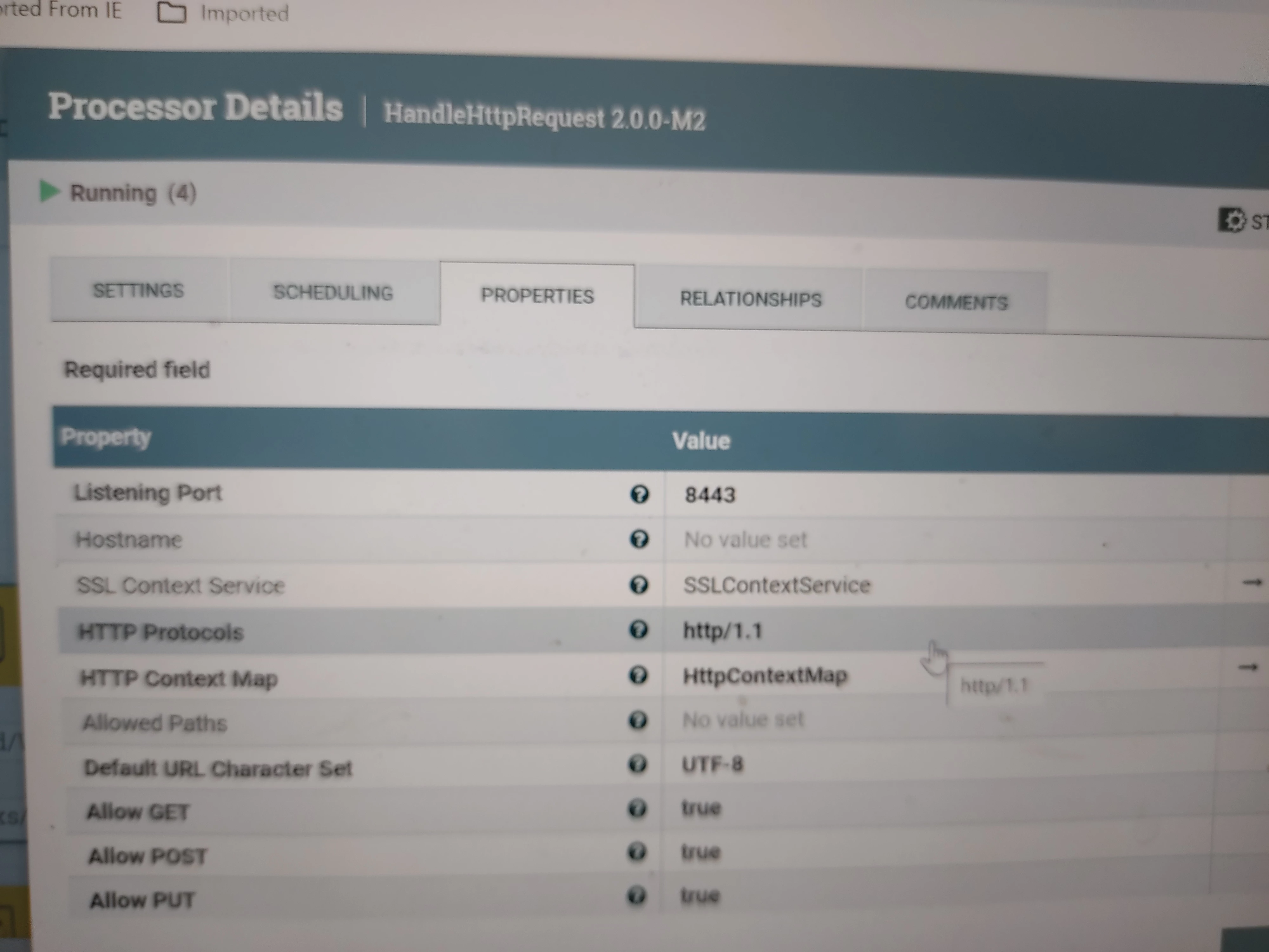

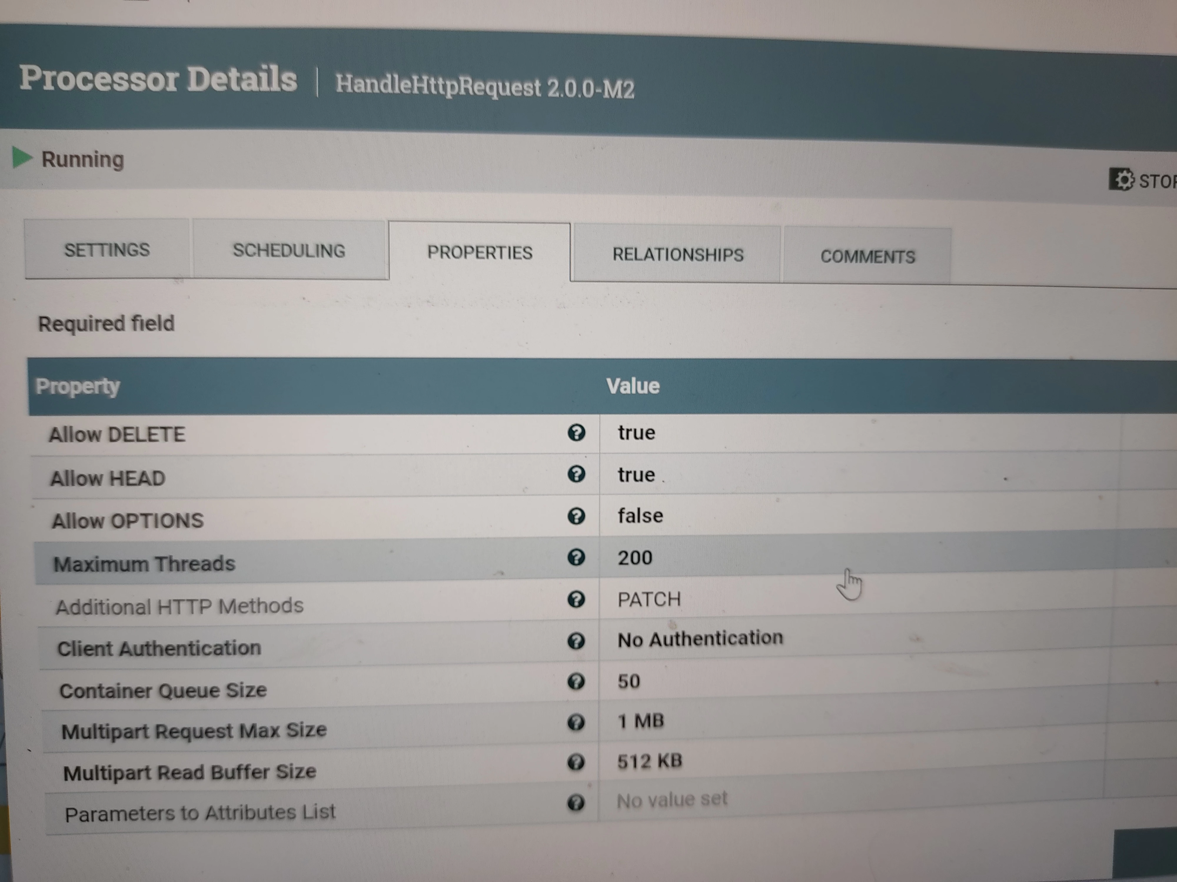

When API call is made to nifi where handleHttprequest accepts http requests,
There are few attributes in request header (Example: "displayName"). These
Requests are received at handleHttprequest processor. When I check attributes of
Flowfile, I could see "http.headers.displayname" . Letter 'N' turned into lower case.
But I need this to be in original form( http.headers.diplayName).
We are currently on 2.0 M2.  Is there any configuration I'm missing due to which
Request headers are turning into small case.

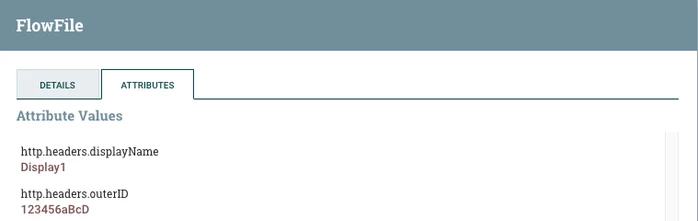

outerID=123456aBcD
When I inspected the received FlowFile from HandleHTTPRequest, I see the FlowFile attributes created from the headers look correct:
I suggest you try using an InvokeHTTP processor to test your HandleHTTPRequest processor in Apache NiFi 2.0.0-M2  to make sure your issue is not the result of some external manipulation of the headers before they are received by the HandleHTTPRequest processor.

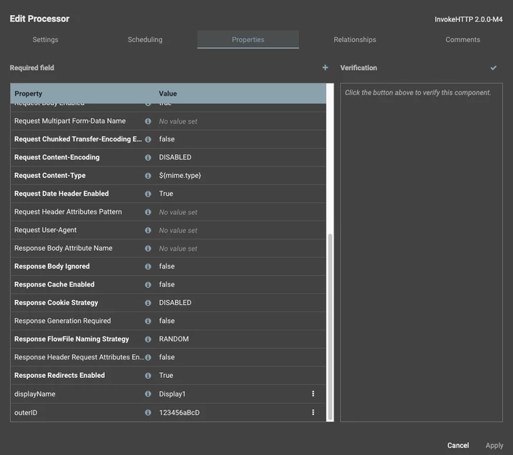

InvokeHTTP:
You'll see two custom headers (displayName and outerID) added above as dynamic properties.

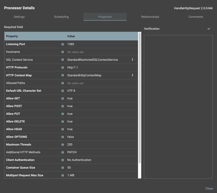

HandleHTTPRequest processor:

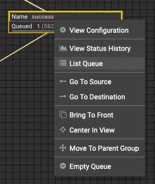

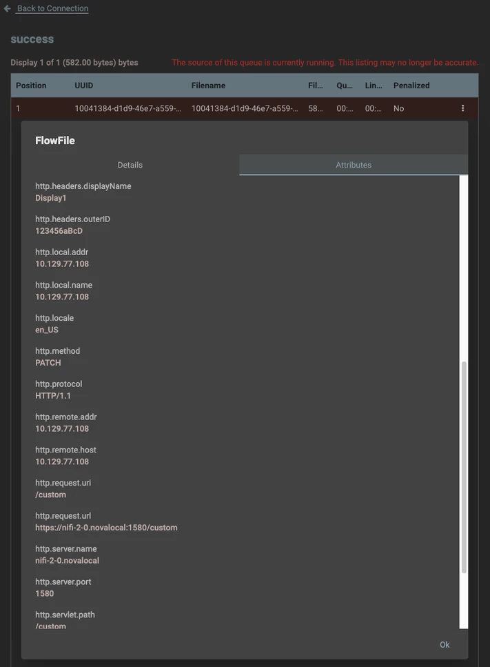

When I "List Queue" on the connection containing the "Success" relationship from HandleHTTPRequest processor and "view details" the queued FlowFile, the FlowFile attributes look correct.
Are you saying you see different?
Try using NiFi 2.0.0-M4 (latest) to see if experience is same.
