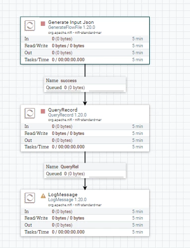

Its hard to predict how this is going to work without understanding the full data flow you have, so I had to come up with simple flow to test the query which worked for me as expected. Please see the my flow below and each processor configuration to get the expected result:
Data Flow:

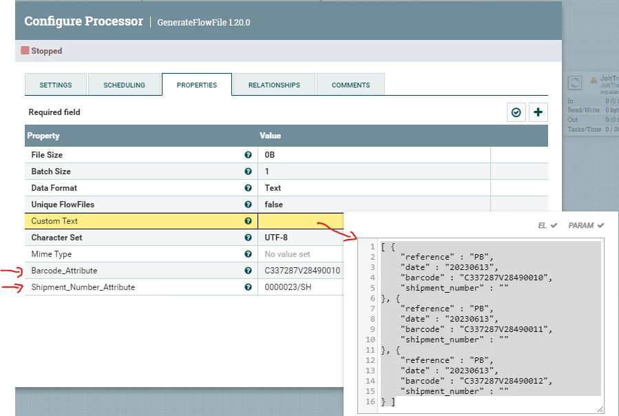

1) Generate Input Josn: GenerateFlowFile processor to produce the Input json as you provided and provide the query attributes.

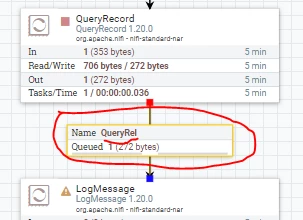

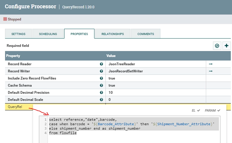

2) QueryRecord: Run the Query provided above to generate expected result:
Notice that you need to connect the QueryRelationship "QueryRel" to downstream processor to get the expected output and not  the original relationship:

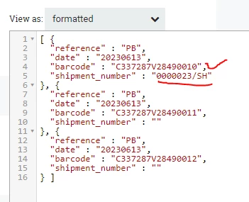

After running the DataFlow above and getting the output in the QueryRel  relationship queue , the output looks like as follows:

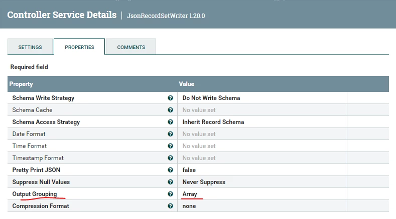

Notice to get the out put as an array the JsonRecordWrite in the QueryRecord RecordWriter is configured as the following:
