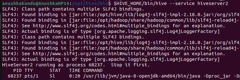

Hello @adsejnf  Can you check is hive server2 is up and running

@Scharan  I checked, I am confused.

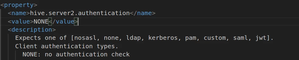

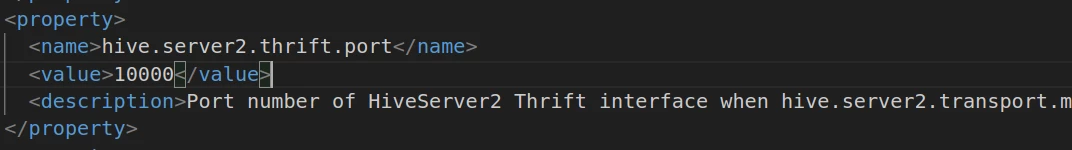

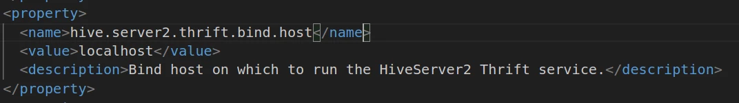

My hive-site.xml is also set properly:
